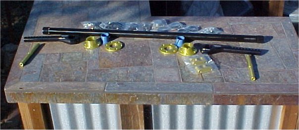

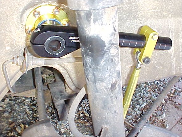

Trekkor
Aug 23 2013, 09:50 PM
yes, sorry.
For a road only, not tracked or autocrossed, driven at the speed limit car, a stock bar would probably be enough.
If you plan on hammering the back roads like a wild man, which I suggest you don't, get a big bar.
The big bar I added, transformed my car from a swaying questionable ride into a tight, dialed, on rails experience.
I have it turned 1/3 to full stiff. Stock front torsion bars, Koni yellow's, 200# rear springs and stock rear sway bar installed.
Click to view attachmentKT

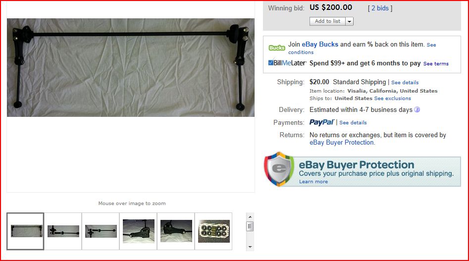

Aug 25 2013, 10:02 PM
Click to view attachmentjust bought this stock set up off evil bay
15mm with some new bushings, I will see when it arrives, how I did.
It will give me a start, you would think Porsche thought things out pretty good for up to 2.0 ltrs.....
I can always change the bar out and add adjustments later.

Eric_Shea
Aug 25 2013, 11:35 PM
Once you get it installed you'll be scratching your head as to why they didn't mandate these things on "all" 914's. I think that's a good value with all of the bushings being new etc.
ChrisFoley
Aug 26 2013, 08:00 AM
QUOTE(Eric_Shea @ Aug 26 2013, 12:35 AM)
Its an excellent value!
IMO a used stock bar is worth more than a new Weltmeister 19mm.

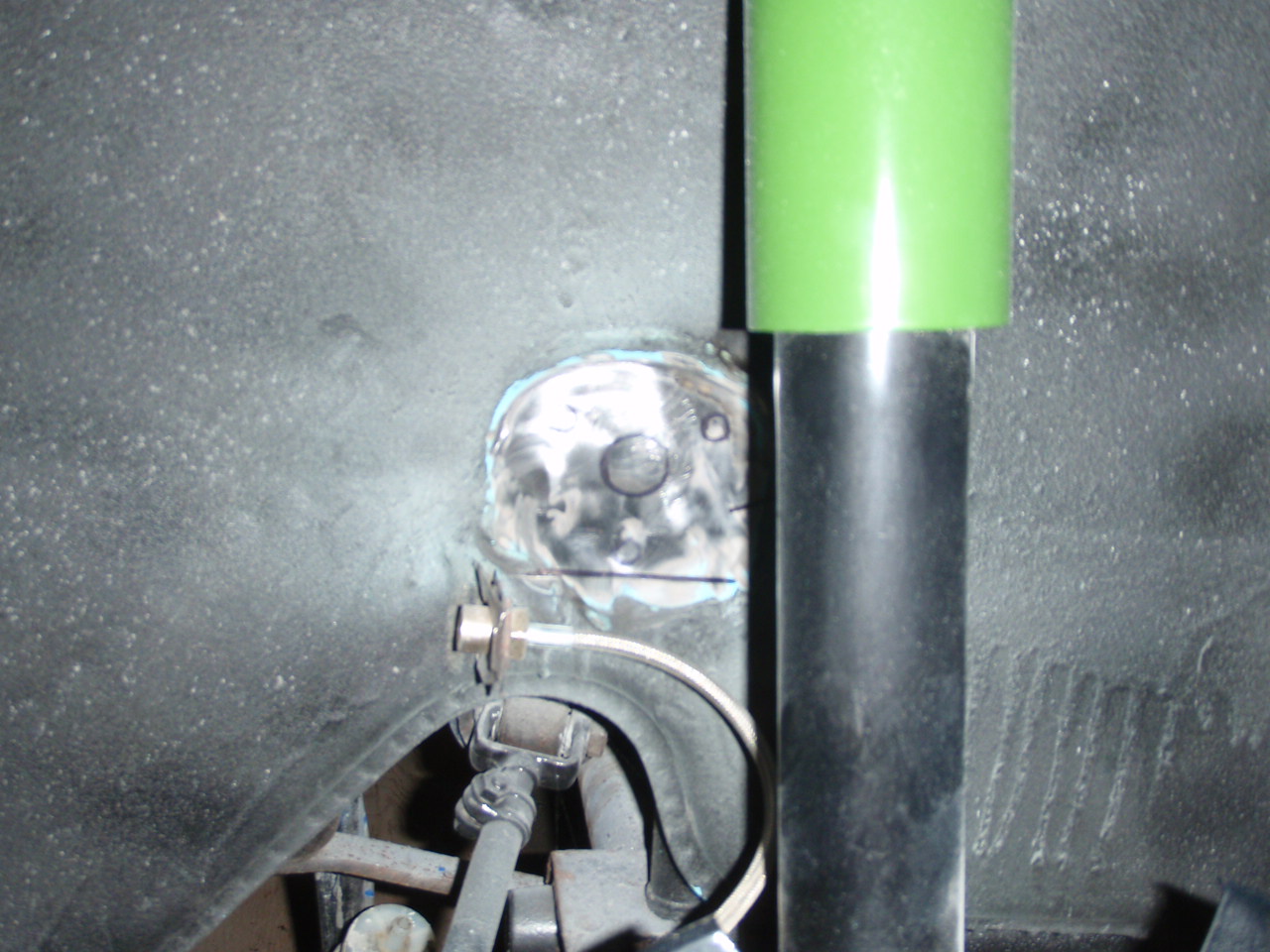

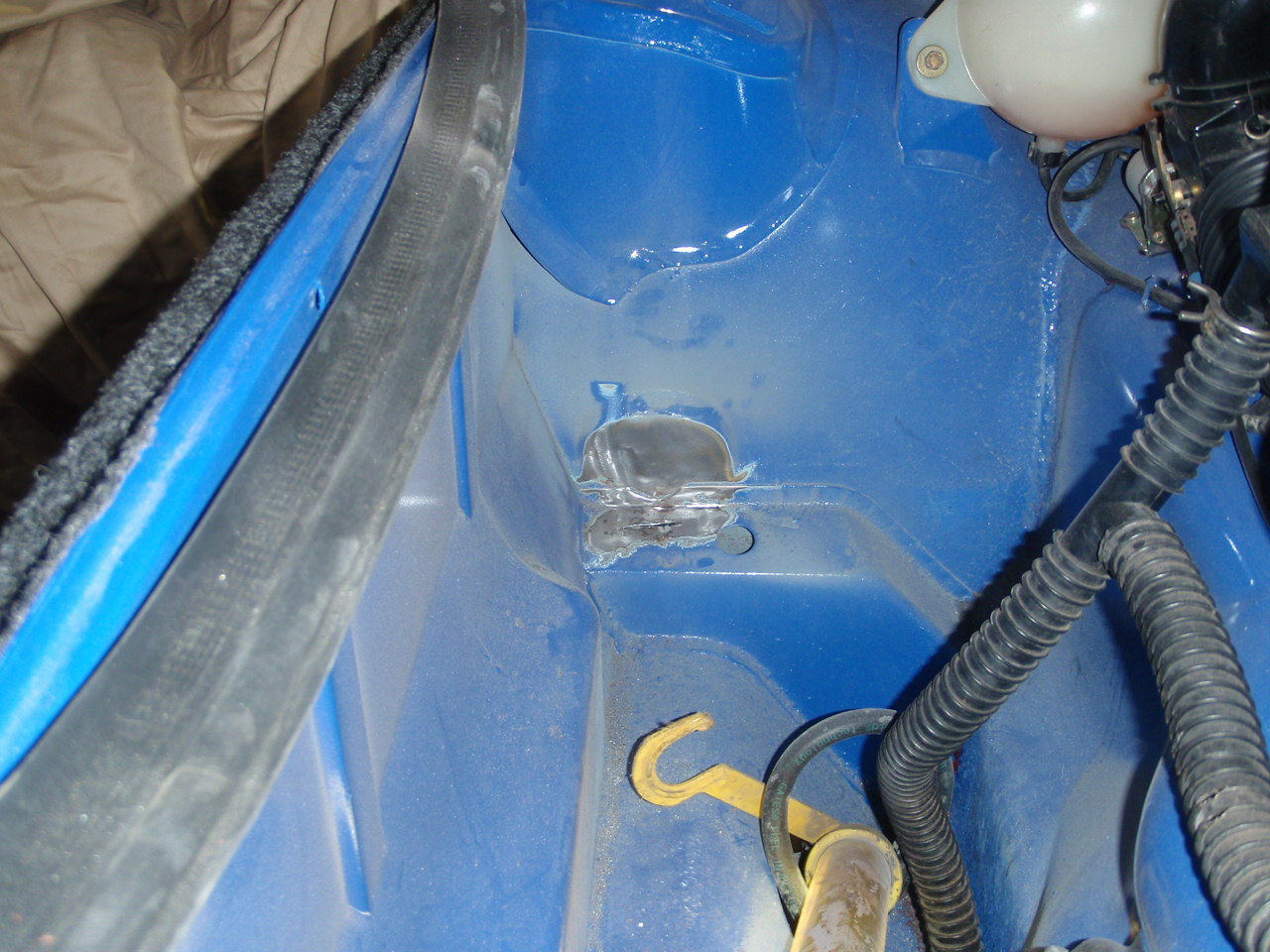

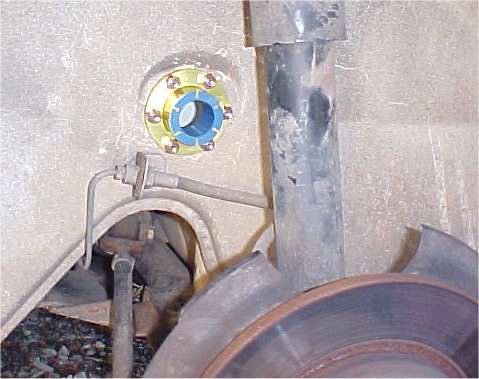

I have not received the bar or supports yet, but I decided to get started.
I found the template for the brackets on the Bird Tech Site.
I had to scale this as it did not print to scale originally.
To prep the inner well, I used a torch and steel wool to get off the undercoat. Then I used a die grinder to clean off the paint so now I have virgin steel to work with.
The factory really made this easy by embossing the area.

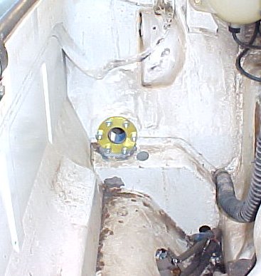

Click to view attachmentI also prepped the fuel tank area. Again, the factory stampings made this easy.
Click to view attachmentI am going to hold off drilling any holes till the brackets, bar, and mounts arrive. I might have to make some adjustments if they all do not perfectly match as they are coming from different sources.
The Bird says go to 1" on the large bar hole. This will allow over a 25 mm bar if wanted at some point so this seems reasonable to me. I started to cut the recess for the inner bracket and then decided to wait.
Parts will arrive tomorrow...
John
Trekkor
Aug 28 2013, 02:37 PM
wndsnd
Aug 28 2013, 02:49 PM
Gees,
Just when I am starting to feel good about my decision to buy a used stock bar you show me this?
Very Sweet,
Double the bolts, looks like no welding, infinite adjustability, very sweet.
