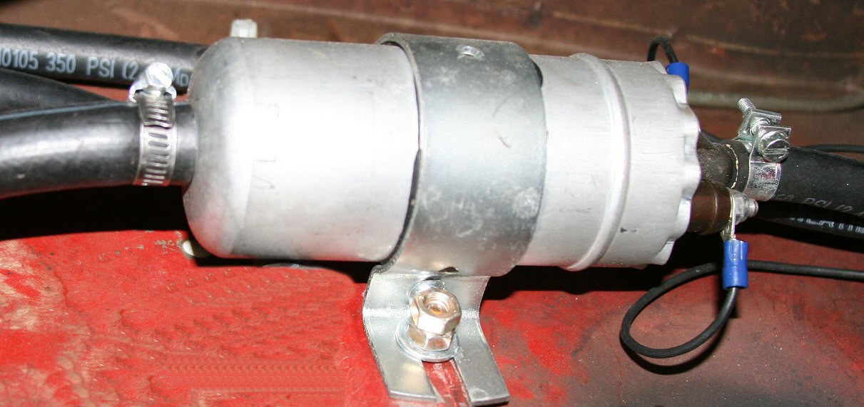

On the return line, there is a Y connection where the fuel went back into the pump and the other to fuel tank. Just discard the Y connection and run return line back to the tank. No return line to fuel pump since you only have two ports.
The new fuel pump will have a smaller diameter than the three port pump. You are going to have to make some modifications on the bracket. I used an old Bosch coil bracket holder.
You will also need a different fuel filter than the one needed for the three port. The in port is bigger than the out port. I got mine from NAPA. Part Number 3274.

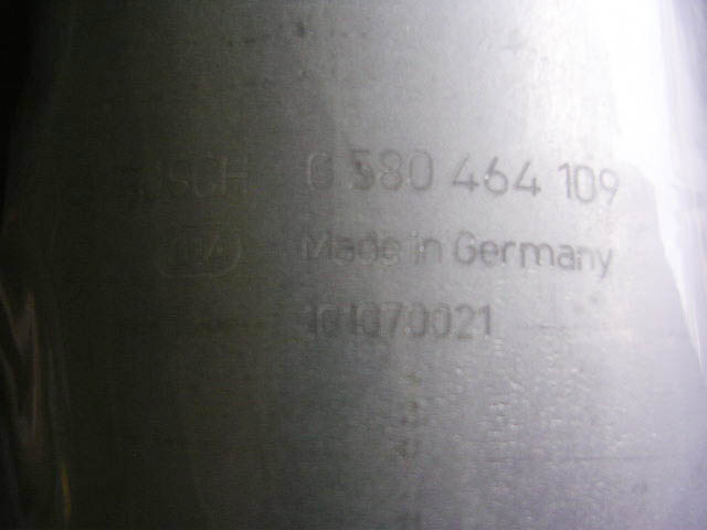

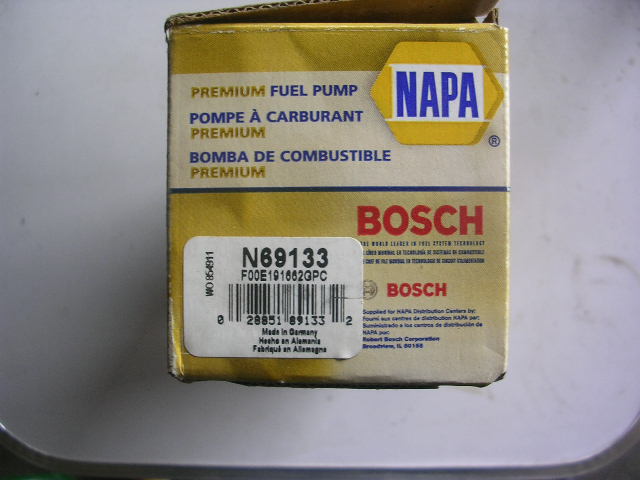

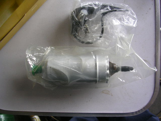

This is what NAPA was selling:
(IMG:http://www.914world.com/bbs2/uploads_offsite/i239.photobucket.com-1696-1377544365.1.jpg)
(IMG:http://www.914world.com/bbs2/uploads_offsite/i239.photobucket.com-1696-1377544365.2.jpg)
(IMG:http://www.914world.com/bbs2/uploads_offsite/i239.photobucket.com-1696-1377544365.3.jpg)

One line from tank to filter, then to pump, then to fuel rail. return line runs directly from other end of fuel rail and back to tank. The 3rd line at the pump is eliminated.

Put one on 76-914 (Ken) car in Cedar City, UT on the way to RCC12. Worked fine but that wasn't the problem.
It's a dead ass ringer for the 2 port '75 - '76 914 Pump.
I don't have any 4 cylinders but I keep a spare just in case. When they first came out they were $32.00 ... don't know what the price is now. It's a Bosch pump and not Chinese made.
As far as specifications I haven't found any but it will provide sufficient pressure and volume for a D-Jet system (and probably an L-Jet too!) based on fuel pressure readings from Kens' car gauge.
F00E191622 comes up: New Bosch Fuel Pump #69133/F00E191662 Mercury/Ford/Lincoln/Fiat (1980-1991)
Category: Parts & Accessories:Car & Truck Parts:Air Intake & Fuel Delivery:Fuel Pumps
Interchange Part Number: E2182
Other Part Number: fe0303
Part Brand: Bosch
Manufacturer Part Number: 69133
Bosch ESI only says it is an "Electric Fuel Pump" without any indication of applications.
