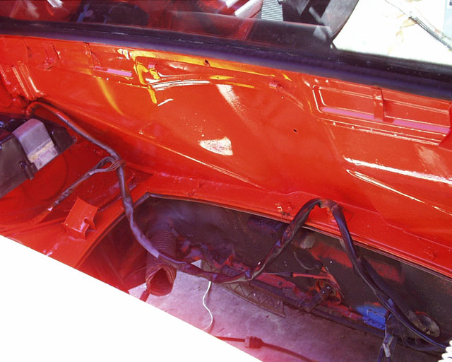

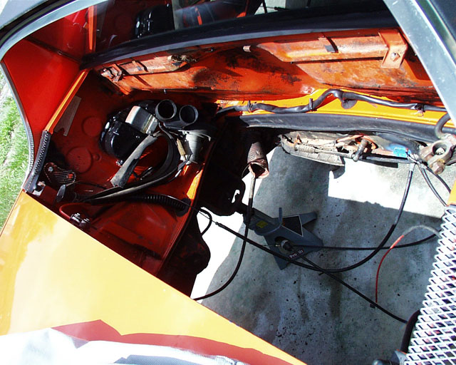

Use spray on or brush on paint remover...I found it to be the best. Use a plastic scraper and take down to metal and correct any rust. Once your done use POR15 , prime and paint the whole deal. I used a 2 part acrlic enamel...has a great shine but you need an touch up gun and it's trick to manuever but worth it.
Before:
newdeal2
post Dec 11 2004, 05:45 PM
Unregistered
After:
newdeal2
post Dec 11 2004, 05:46 PM
Unregistered
After:

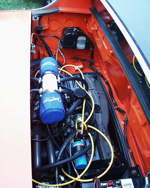

QUOTE(newdeal2 @ Dec 11 2004, 03:47 PM)
With engine in [and after cleaning up some of the overpsray]:
Peter, what kind of air intake is that? Looks really trick. Where did you get it, does it work well?
newdeal2
post Dec 12 2004, 06:45 AM
Unregistered
The PO made it and it does work. I will be doing a post with pics in a few days.
