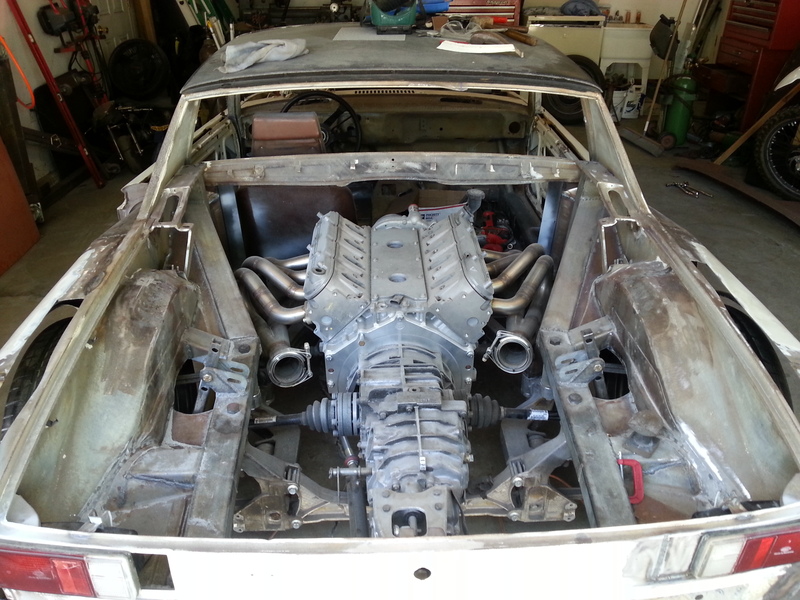

Hopefully I can get the deal done ! His build was to use the complete 996 front and rear suspension, from the cradle /sub-frame etc.
Is that common ? My old black v8 car had early 911 brakes but thats about it. Looks like everything fits nicely. The engine is a LS1 using a G-50, 5 speed. My old car used a 930 4 speed and it took everything my old school SBC could dish out fine.
Is the G-50 built to handle 400 fp/torque ? The quality of the framing, welding and execution is way above my pay grade. My ideas areOK but my execution sucks (IMG:style_emoticons/default/bootyshake.gif) We will be getting together over the weekend. Here is a picture of the car, sorry its still very raw at this stage. IMO you can'really see how well things are done from the photo.

wow very ambitious

WOW! Looks like a project, but a cool one. How fast can you get it together?

Wow!!
Thats an awesome build!
That could seriously take years to finish though...
Headers go forwards then turn back??

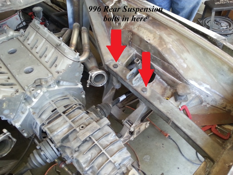

The picture shows how the 996 suspension bolts into the custom sub-frame and uses the 996 side wheel base as well. That means among other things the use of factory parts like axles. There are shims set in place to raise or lower the body.The front is set up the in the same fashion.
I'm sure it will be in the garage a very long time !

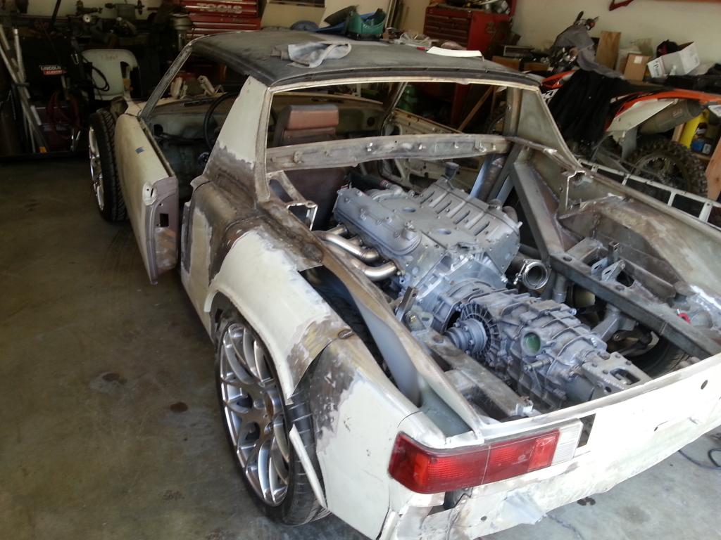

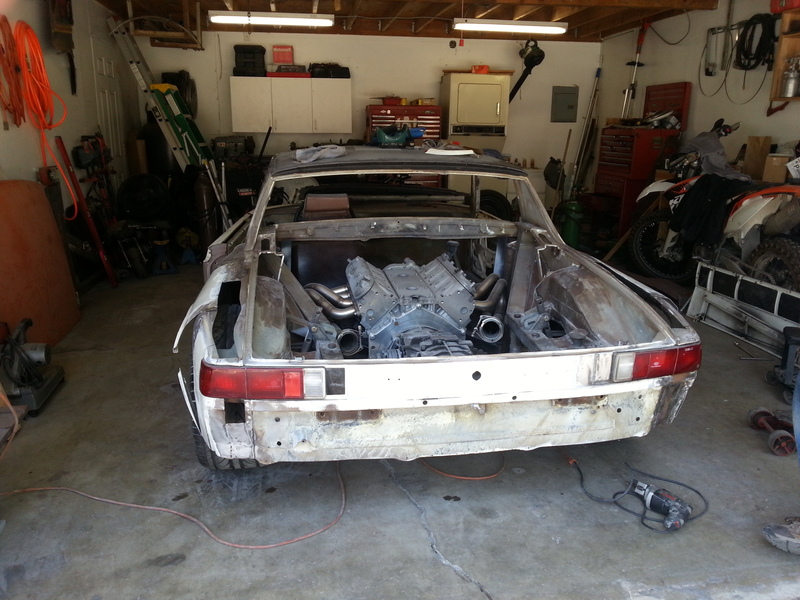

I am happy to say the deal got done !!! (IMG:style_emoticons/default/beerchug.gif) Here is a shot of the engine bay from another view. The flairs at the rear are all welded up and look very nice. I like the gt flairs but for me this style is what I am most fond of. I have a lot of work ahead of me but am happy to say my neighbors are great !!!! Theres no issues where I am now ! I just hope I can continue to keep with the build standard the p.o. had. The pictures don't at all show the quality craftsmanship done by the p.o. Way above my fabrication ability. HST I did pay a lot for the car considering it's a long way from running.

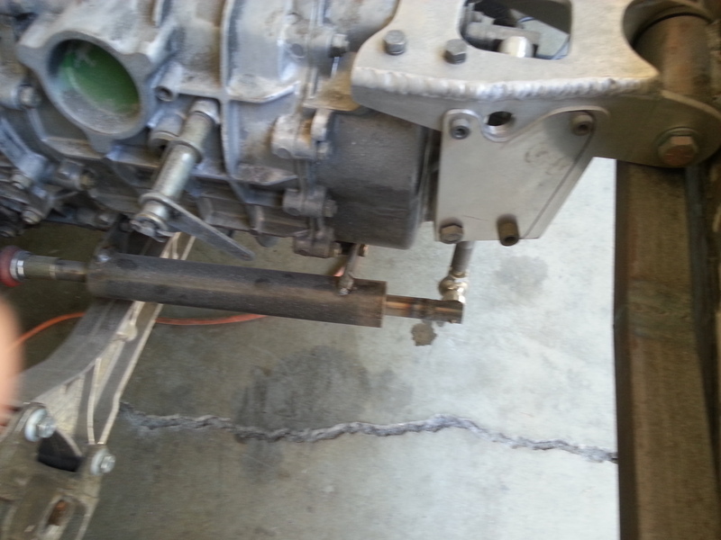

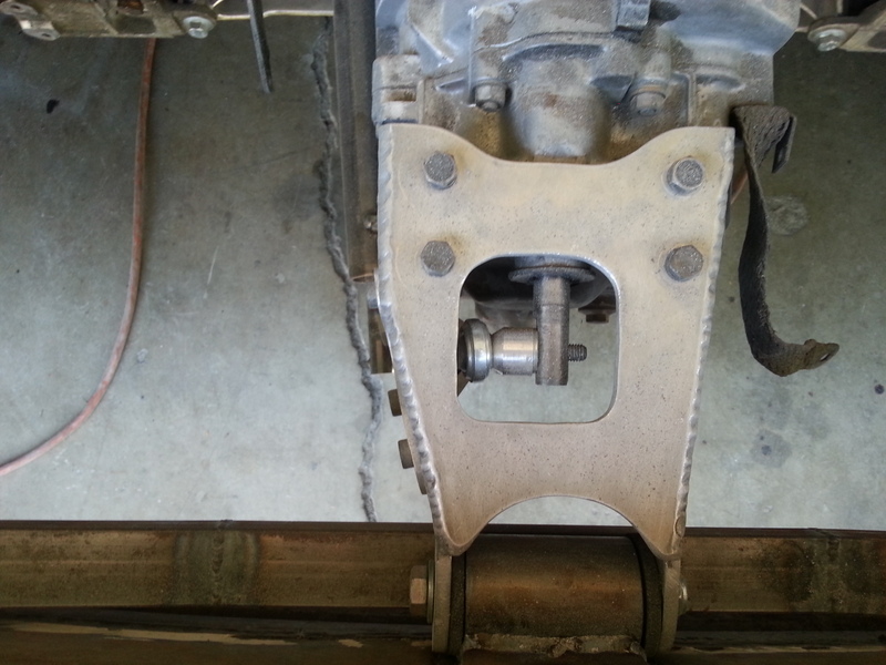

Here is a picture of the shift linkage and the rear trans mount. The linkage uses a single rod I think just as the 911 does. Seems to work well.
(IMG:http://www.914world.com/bbs2/uploads_offsite/imageshack.us-3782-1379215077.1.jpg)
(IMG:http://www.914world.com/bbs2/uploads_offsite/imageshack.us-3782-1379215077.2.jpg)

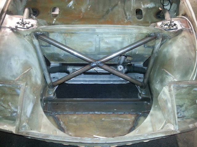

I got the car home was a long day. Here is a shot of the front end. you can see a little of the 996 front suspension and power steering rack.
