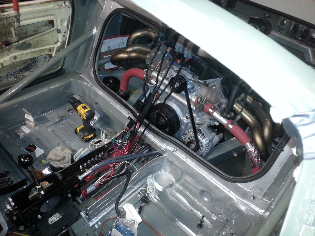

drive-ability   My fans arrived and I cut out the holes in the alu...   Mar 18 2014, 09:11 PM

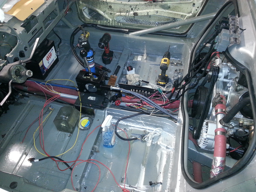

drive-ability   Started wiring up the fans and P/S pump. Using 1 g...   Mar 20 2014, 09:49 PM
Jeff Hail   Started wiring up the fans and P/S pump. Using 1 ...   Mar 20 2014, 11:38 PM

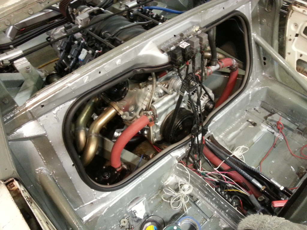

drive-ability   More Progress :) I decided to run larger coolan...   Apr 19 2014, 10:37 PM
r_towle   Damn..... Did not read the whole thread, good to s...   Apr 20 2014, 05:53 AM
Mike Bellis   I had hoses in the tunnel on my first conversion c...   Apr 20 2014, 09:20 AM
2mAn   thats why he is going to have A/C :poke:   Apr 20 2014, 09:48 AM

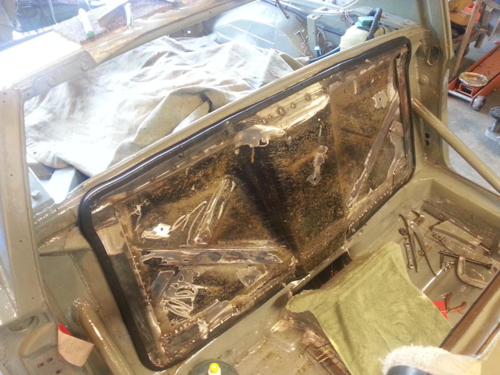

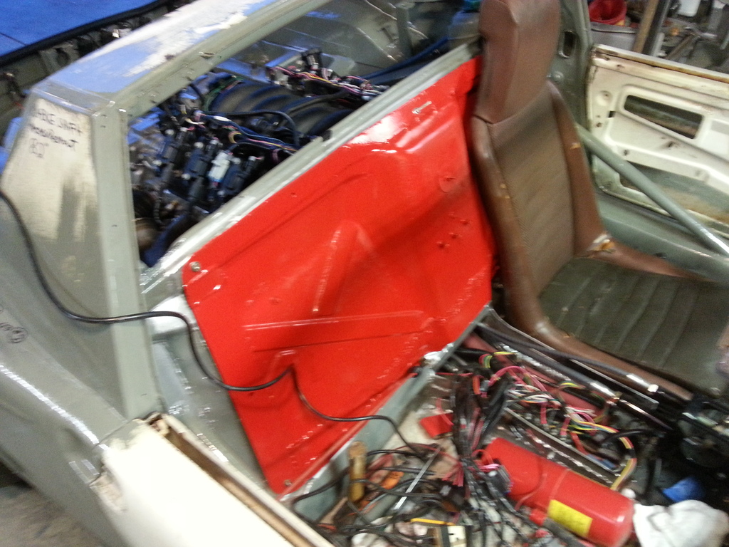

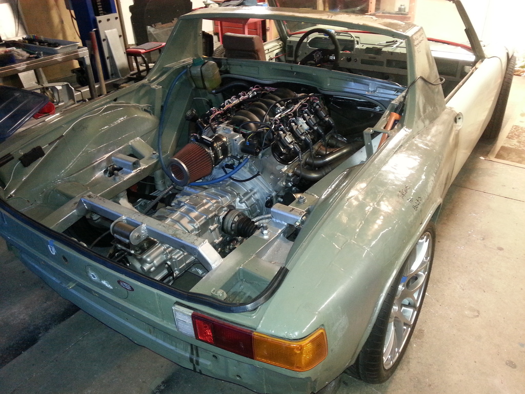

drive-ability   The car is about 5 inches wider in the back. I ...   May 1 2014, 12:11 AM
veekry9   The car is about 5 inches wider in the back. I w...   May 2 2014, 06:03 PM
