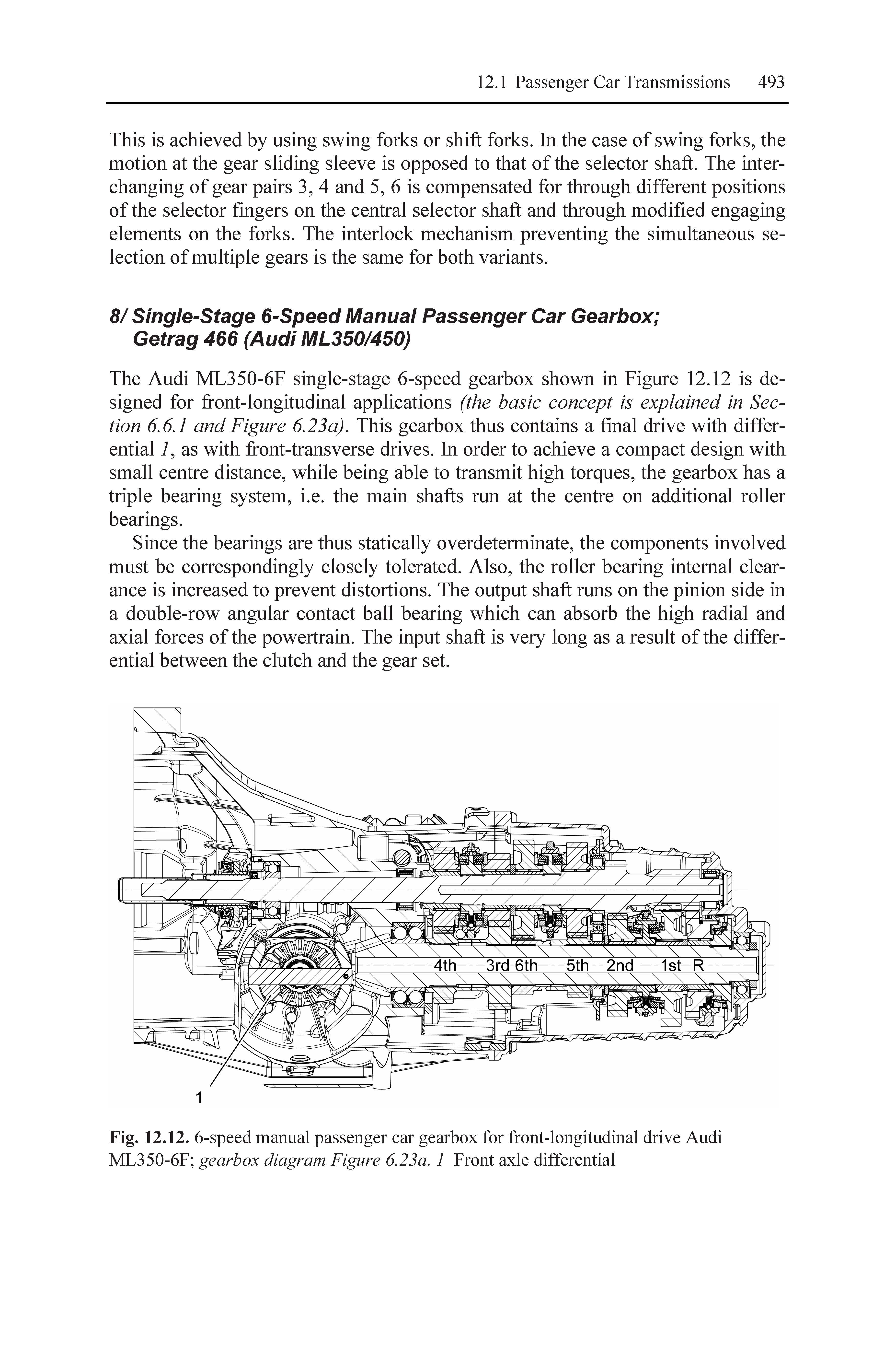

I have the axles for the G-50, will they work with the G-466 ?

Thanks for the input, and the idea to visit the GT 40 sites is fantastic. I am used to being able to hammer down the throttle so it would be easy for me to shred the G-466 If its not up to the task.
I'll see how it stands up (G-466) in the GT-40 sites.

I don't personally care which transmission you decide on. Here is some info on the G-466. This is the same tranny that is used in the AWD platform too. It must be able to handle some torque...
