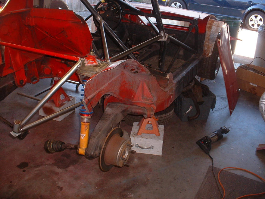

I built the lightest 914 in the history of mankind. ![]() ![]() ![]() ![]() ![]() ![]() ![]() ![]() ![]() ![]() ![]() ![]() ![]() ![]() ![]() ![]() ![]() ![]() ![]() ![]() ![]() ![]() ![]() ![]() ![]() ![]() ![]() ![]() ![]() ![]() ![]() ![]() ![]() ![]() ![]() ![]() ![]() ![]() ![]() ![]() ![]() ![]() ![]() ![]() ![]() ![]() ![]() ![]() ![]() ![]() ![]() ![]() ![]() ![]() ![]() ![]() ![]() ![]() ![]() ![]() ![]() ![]() ![]() ![]() ![]() ![]() ![]() ![]() ![]() ![]() ![]() ![]() ![]() ![]() ![]() ![]() ![]() ![]() ![]() ![]() ![]() ![]() ![]() ![]() ![]() ![]() ![]() ![]() ![]() ![]() ![]() ![]() ![]() ![]() ![]() ![]() ![]() ![]() ![]() ![]() Group: Members Posts: 134,949 Joined: 3-February 03 From: Jacksonville, FL Member No.: 222 Region Association: None |
I'll only post two shots.

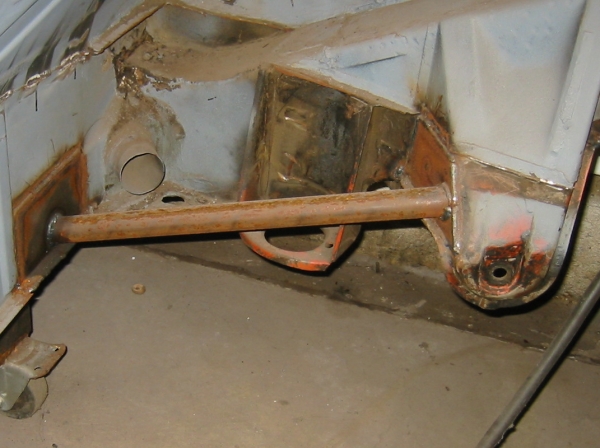

I've cut the right rear fender and sail panel off and the inner fender panel out. The inner fender was rusted out pretty good so I went ahead and removed it. The top of my frame rail is gone. I can look into the rail through the opening. There in only minor surface rust inside. Attached thumbnail(s)

Its really hard to see all the bars and what has been cut out.
The fender is laying on the ground in the back ground. Attached thumbnail(s)

I need to weld in the bars and roll it out in the daylight to get a good shot of it.
Cutting the quater panel off was a major PITA. The area where the door jam meets the firewall and the sheet metal duct for the rear window defogger gave me the most trouble. It just a hard area to get access to. Paul (IMG:style_emoticons/default/sawzall-smiley.gif) |

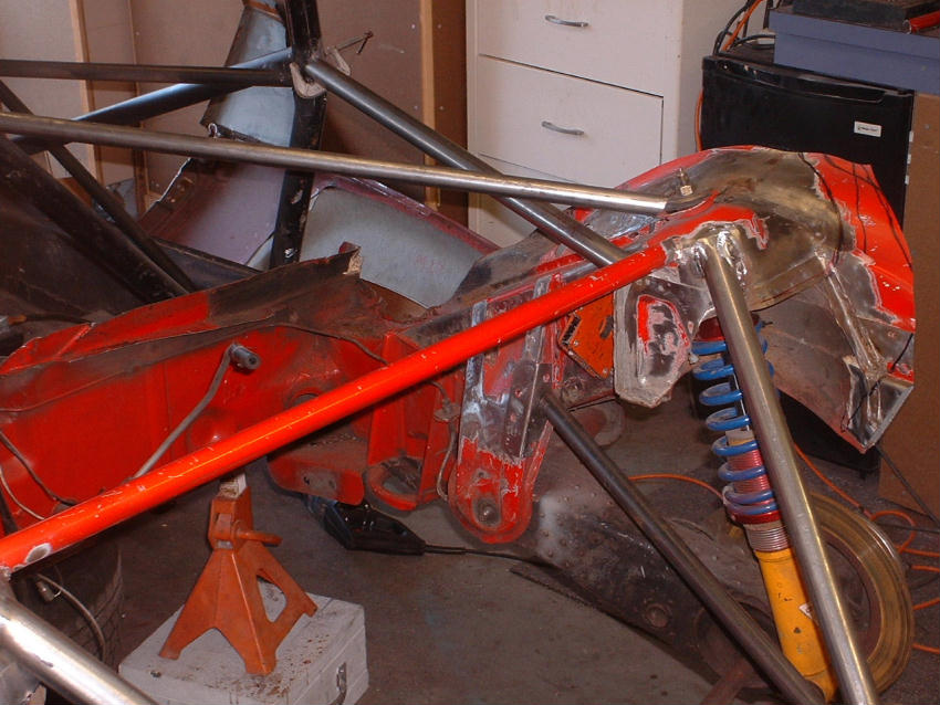

In the first shot you car see thru the car to the ground in front of it.
Talk about air cooled! (IMG:style_emoticons/default/laugh.gif) Paul |

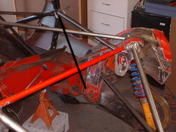

Please excuse my terrible Photoshop skills. I'll work on it.
I'd like to see a tube in the position represented by the black line (obviously it would pass under the other two tubes, but like I said, I'll work on my Photoshop skills. Attached image(s)
Thiis is what is typically done and what I plan on doing.

QUOTE(URY914 @ Dec 13 2004, 09:11 PM) Thiis is what is typically done I think it's safe to say you've wildly departed from what is 'typically done' at this point. Maybe you should do both, IMHO. (IMG:style_emoticons/default/cool.gif) |

QUOTE Thiis is what is typically done and what I plan on doing. I wish I had pictures of what we did (which is similar), but I'm out of town and can't post a pic. Our tube angles out ward and forward instead of inward and forward. Ours starts just ahead of the suspension console hole (trailing arm mount hole) and extends forward through the lower firewall and terminates on the interior longitudinal (almost directly under our roll cage hoop close to the seat belt mount). This looks to be the direction that the suspension console would move under heavy cornering. (the pivot point being the outer trailing arm mount {3-bolts}). Just my $0.02 |

I'll be adding RacerChris' outer console stiffing kit also (its on his website).
I think I'll be OK. I'm trying to balance between adding weight with too many bars and getting the most stiffness with just the right amount of bars. I could have used 2" bars for everything and it would be strong but a heavy pig. Being that this is a autox car only I don't need to provide side impact bars or bars surrounding the fuel cell. I'm going strictly for enough stiffness to offset the flex. P |
