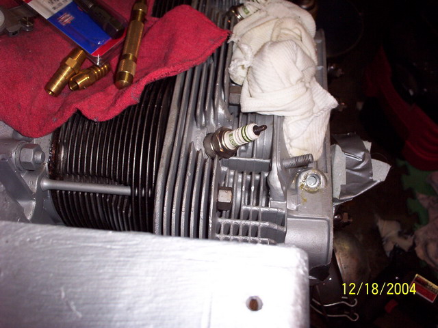

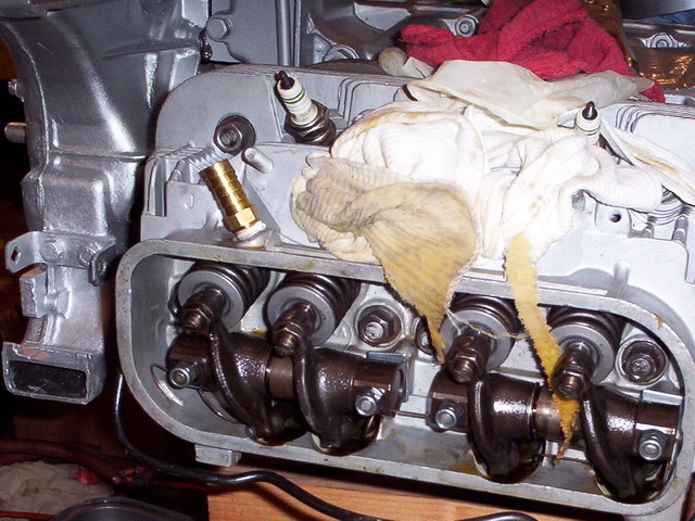

Here's a before & after of the vents.
d7n7master
post Dec 19 2004, 11:18 AM
Post #26
Gary#
Posts: 663
Joined: 13-March 03
From: The O.C, Ca.
Member No.: 421
And:
