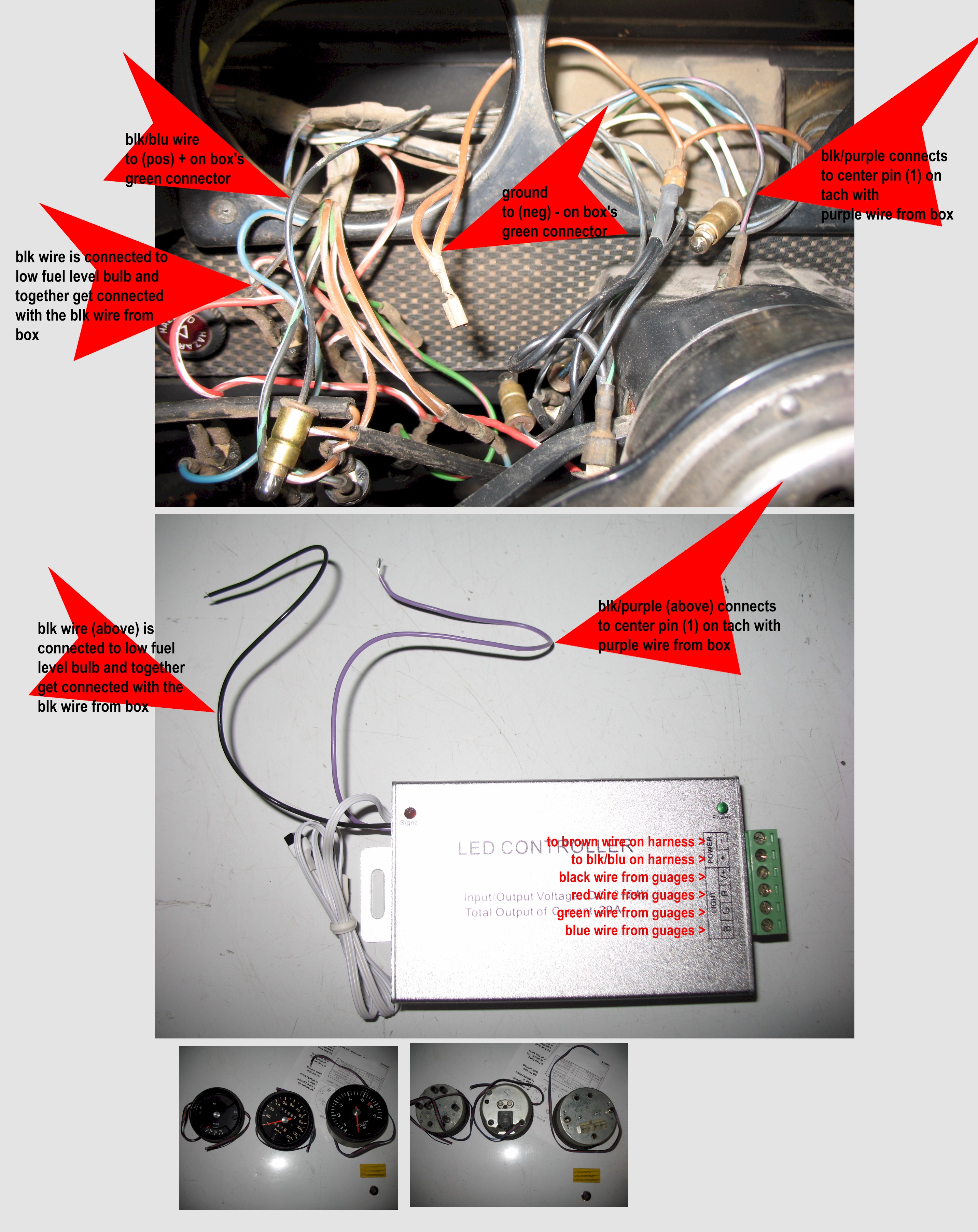

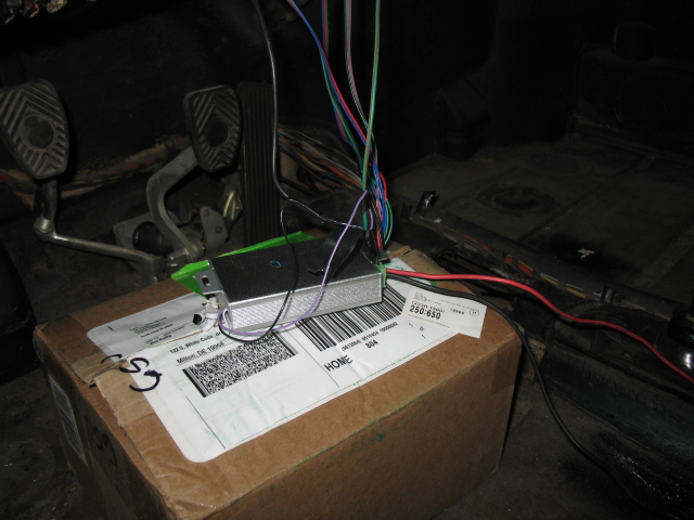

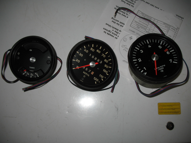

wiring my v8
and tell me what I have wrong or missing.
my bad for never labeling the wires (IMG:style_emoticons/default/headbang.gif)
distributor is msd 8360
but you guys are smart (IMG:style_emoticons/default/smoke.gif)
and yes - I better connect that oil guage line or I will have a mess on my hands.

3d914   IIRC the yellow wire goes to the positive side of ...   Sep 16 2013, 01:01 PM
jimkelly   thank you - I am editing my collage as we go. jim   Sep 16 2013, 01:05 PM

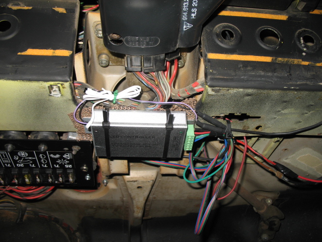

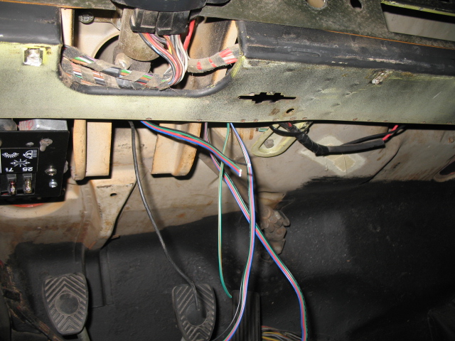

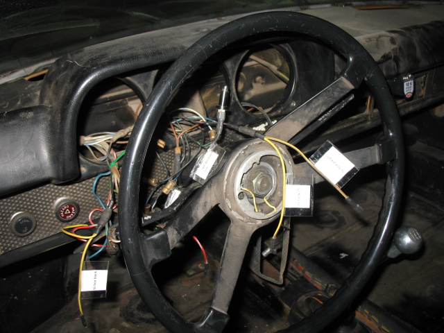

Spoke   Page 5: Red wire from harness is 12V power to coil...   Sep 16 2013, 02:13 PM
jimkelly   spoke I am pretty sure my ignition switch was par...   Sep 16 2013, 02:30 PM
jmmotorsports   spoke I am pretty sure my ignition switch was pa...   Sep 17 2013, 04:15 AM
chads74   spoke I am pretty sure my ignition switch was p...   Sep 17 2013, 06:19 AM
jimkelly   spoke image 6 - the blue wire loops around and co...   Sep 16 2013, 07:31 PM
Spoke   spoke image 6 - the blue wire loops around and c...   Sep 17 2013, 06:49 AM
dwillouby   I dont use the relay board. You need a switched 12...   Sep 17 2013, 06:42 AM
jimkelly   I was thinking that since it seems to be the only ...   Sep 17 2013, 07:03 AM
jimkelly   finally going to put my crimper and heat shrink to...   Sep 17 2013, 08:01 AM

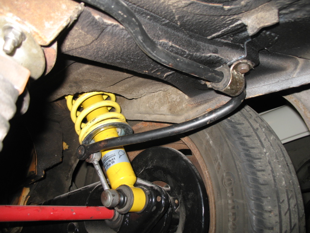

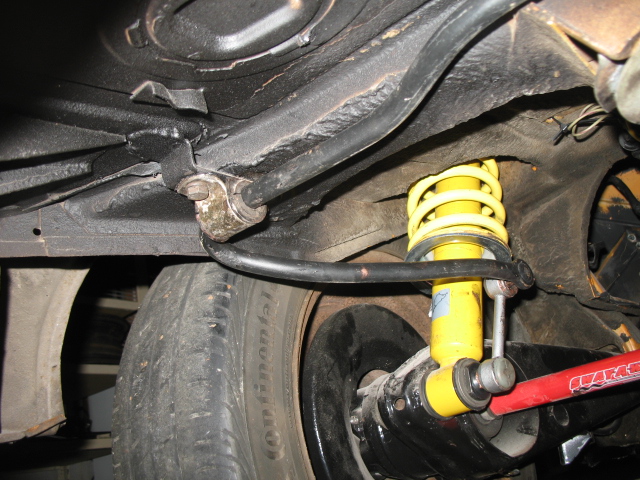

kg6dxn   Your lower spring perch is upside down... :( http...   Sep 22 2013, 07:17 PM
jimkelly   thanks for that!!! jim   Sep 22 2013, 07:45 PM

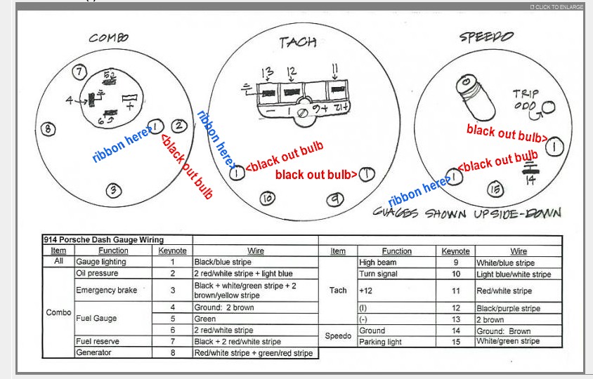

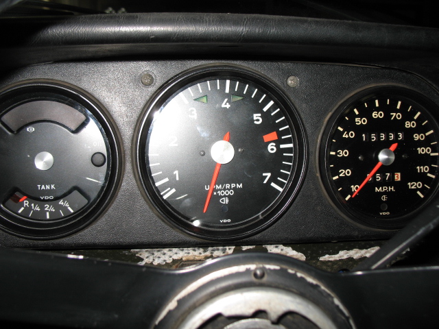

jimkelly   well - later tach won't do. it only has one g...   Oct 27 2013, 11:21 AM
Spoke   Yeah, I didn't like the later tach because of ...   Oct 27 2013, 02:53 PM
jimkelly   pretty sure its plastic - but I will put it back i...   Oct 27 2013, 03:44 PM
