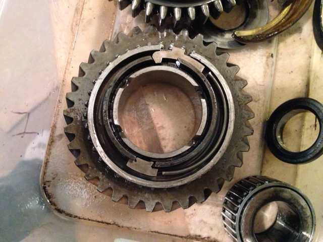

Well I took the tail cone off . (IMG:style_emoticons/default/sad.gif)
First thing, I heard a clink as I pulled the tail cone. I thought it was just the reverse bearings, BUT NOOOOOO.......
Not a good sign. Yes that is one of the brake blocks (I believe).
Then I pulled the gear.
Take a look.
With the block out of place, the ring assembly is loose and another block is sliding around under the circlip.
I can't get the circlip off yet.
I know it's bad but, Discuss...

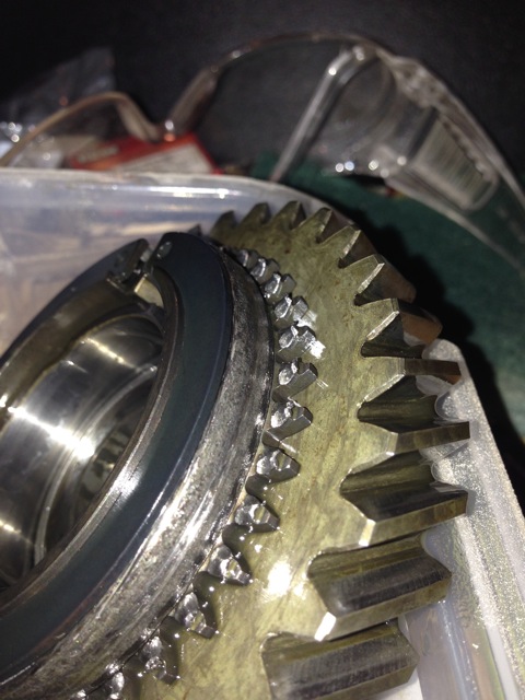

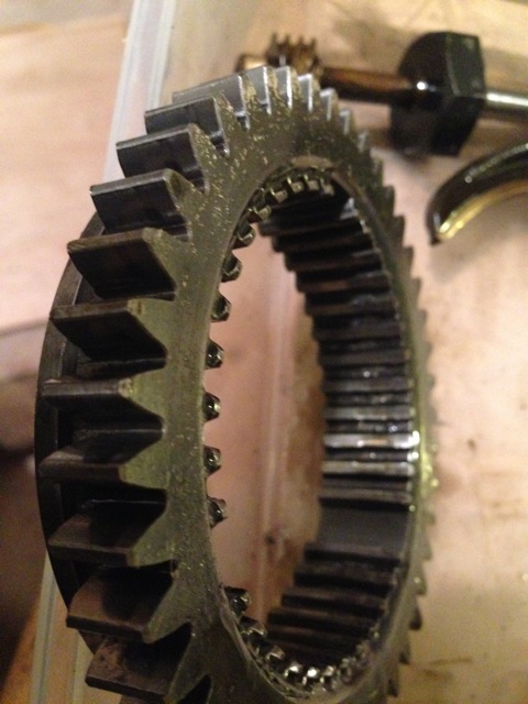

I finally got to see under the Circlip. Does this look normal for a 901 in a 914.
It doesn't match the pics on the Pelican parts site. I was reading the article and noticed one of my stop blocks (the bottom one) looks different than the one in the pic. Mine looks smaller.

There are early and late versions of the actuation pieces. I learned about them in school in 1973, so I'm guessing the changes were prior to that. I have the specs and drawings in a notebook somewhere, but it'd take days to find it, so you're on your own. BTW, 1st is different from all the rest, but I've seen 2-5 dogteeth and components used on 1st.

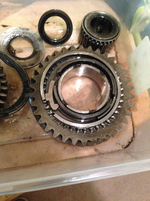

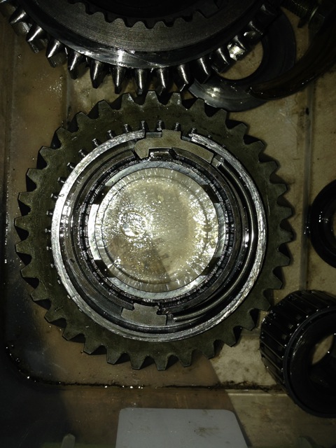

Some pics from under the circlip.
As it was when the clip came off.
I think this is everything back in place.

that dog teeth is toast and needs to be replaced. the inner contents of that gear you took apart is what should be in there. However, the syncro and may be need to be replaced. The syncro can be flipped over like a pancake, (which is the factory recommends) and that may give additional life to that syncro. You WILL need a new or used 1st/reverse gear, which costs $$$. This is the classic wearing out of the 1st/reverse and the syncro. If you have not had any problems between 2nd through 5th gear, then replacing the bare essentials of the 1st/reverse gear and the dog teeth, and I would bet that your tranny could be put back on the road. BAsed on that chunk of metal, this means you will need new anchor blocks as well, the upper hooked one and you might as well replace the lower symmetrical one as well.

Yup, your block fell out probably because you have a late snap ring on your gear. That snap ring can rotate and let the little block out. The late model had bigger block that did not fall out.
I agree with Dan that you need a new set of dog teeth.
The rest I do not agree with. Your gears themselves look fine, and if they did not it would still only cost you $25 +shipping from me to replace with good used. Depending on your finances, your 1st slider is fine. You CAN replace it, but it is not 100% necessary if your budget does not allow. I also have better used ones and a nice new one if you want to go that way. I would upgrade your band and block to the new style, and I have a lot of these for you. If you want, send me your 1st gear and I will assemble it with the parts you need.
