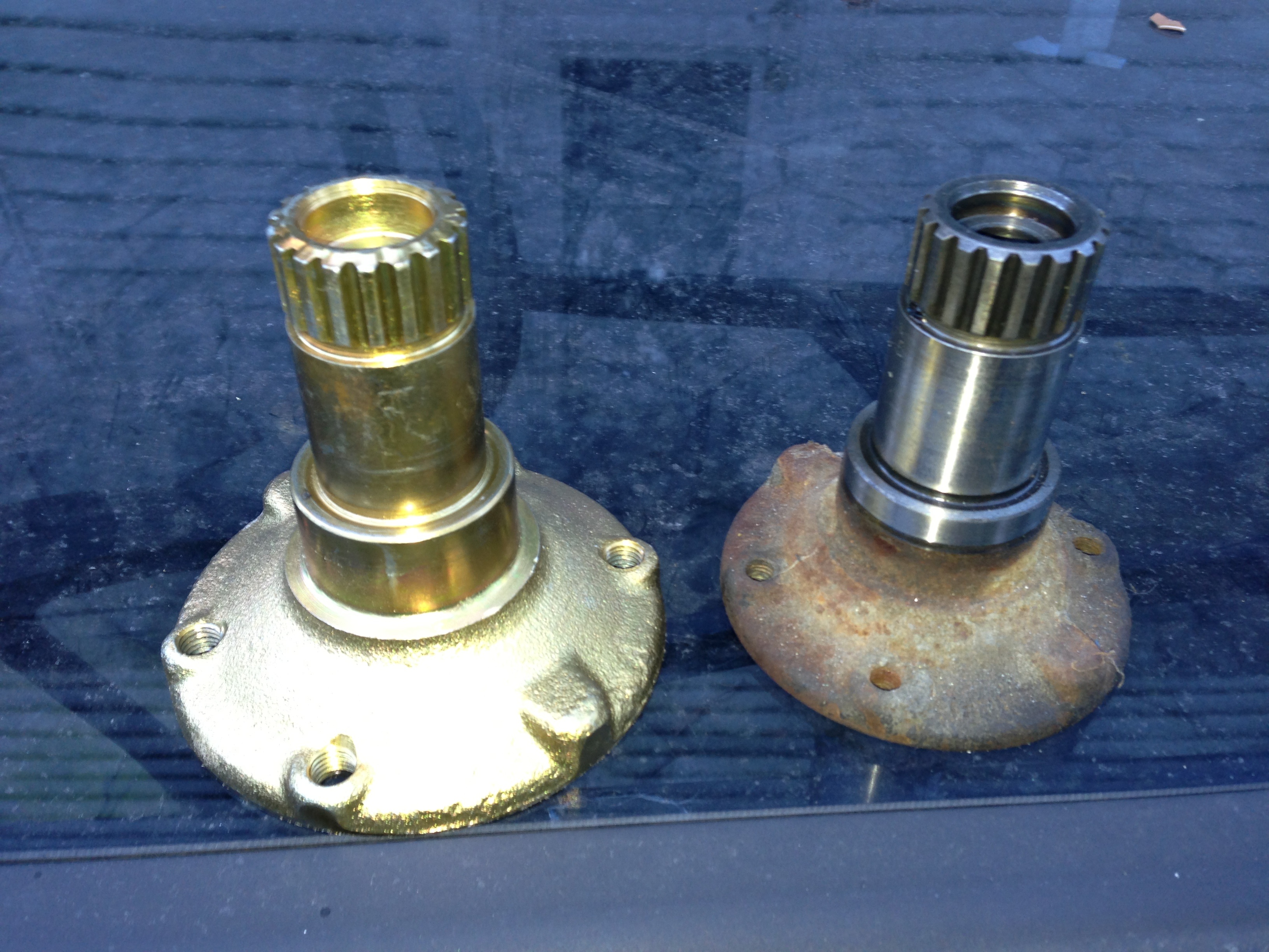

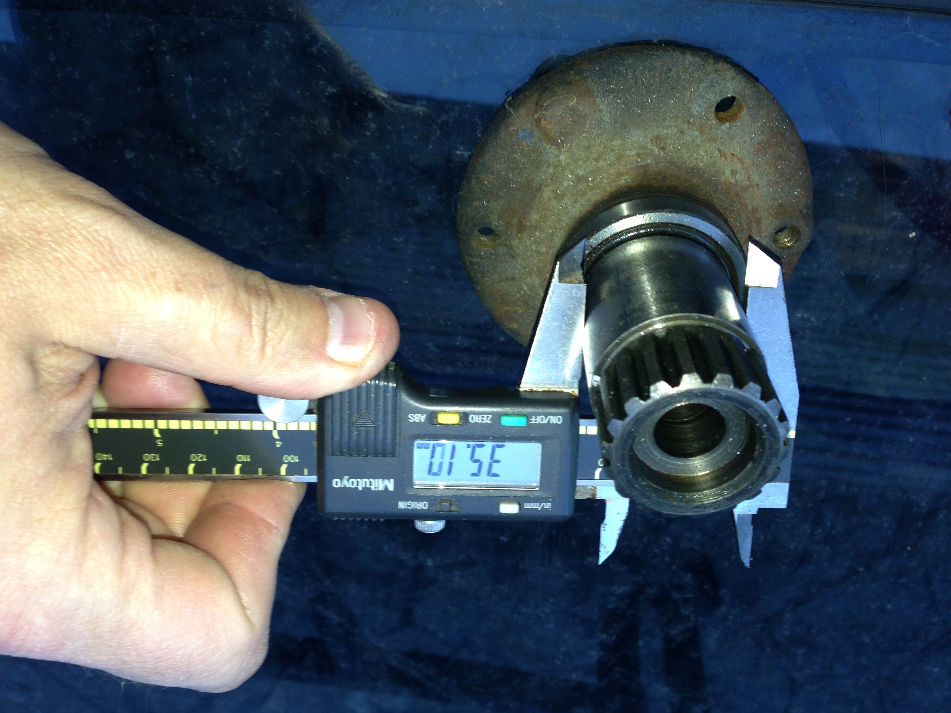

The slop was not the diff to the trans but my out put flange to the diff. The dirty Origional flange is 1.16mm larger in dia than the gold 110mm flange
How can I build up the OD to remove the slop?

Sorry this is the location where the diameters are different
