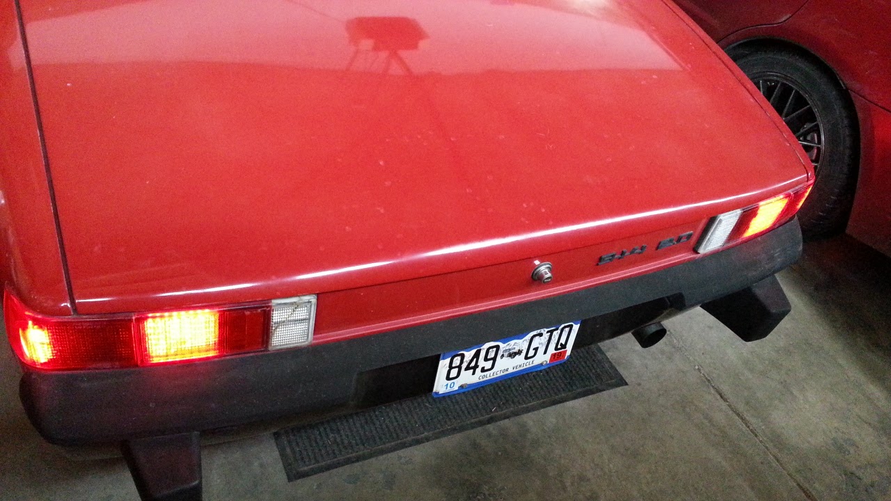

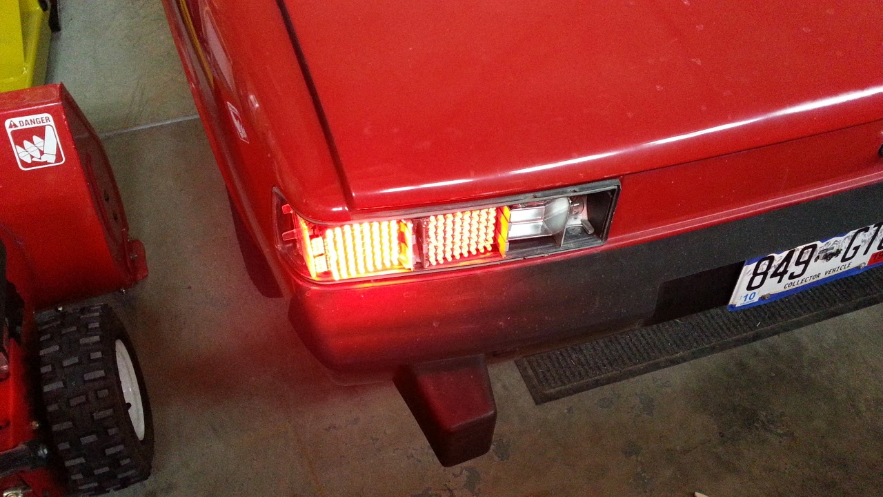

The LED conversion is complete. This morning I installed the tail light LED boards that purchased from Spoke. I am very impressed. They are very bright and supper easy to install. They are an excellent upgrade and in my opinion money well spent.

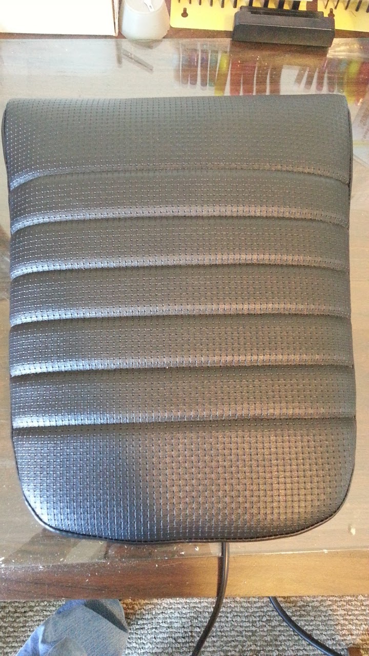

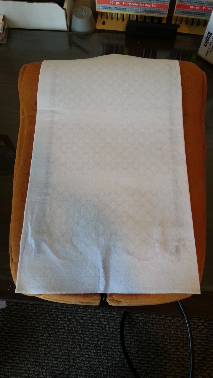

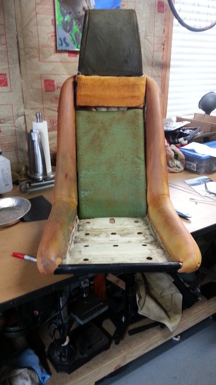

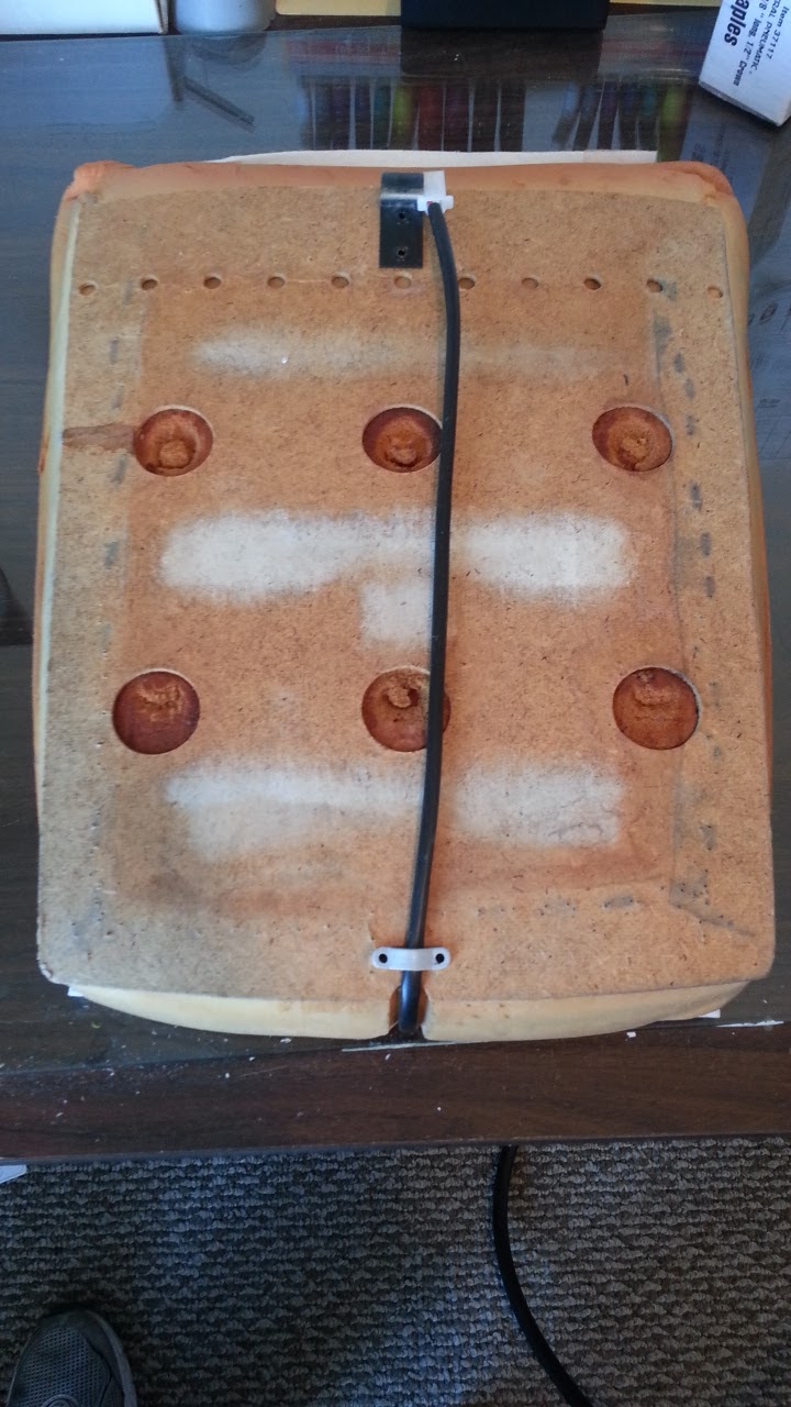

It is pretty cold in the garage today so I decided to do a little work inside the house on my 914 seats. I am installing heated seat inserts and new seat vinyl kits from 914 Rubber. So far I have both bottom cushions completed and one of the seats completely stripped. The foam is in pretty good shape for being over 40 years old.

Bun Warmers. Your going to (IMG:style_emoticons/default/wub.gif) those. I think I stole mine for <$50 but after having them I would gladly shell out twice that much.

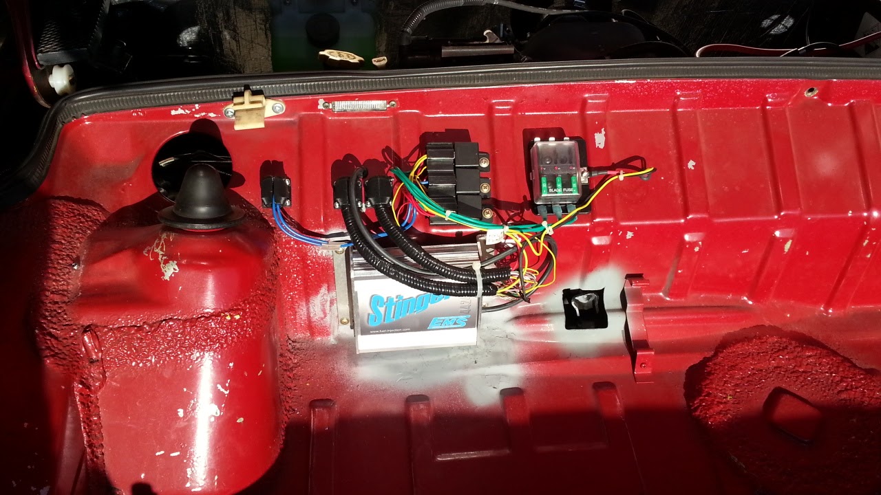

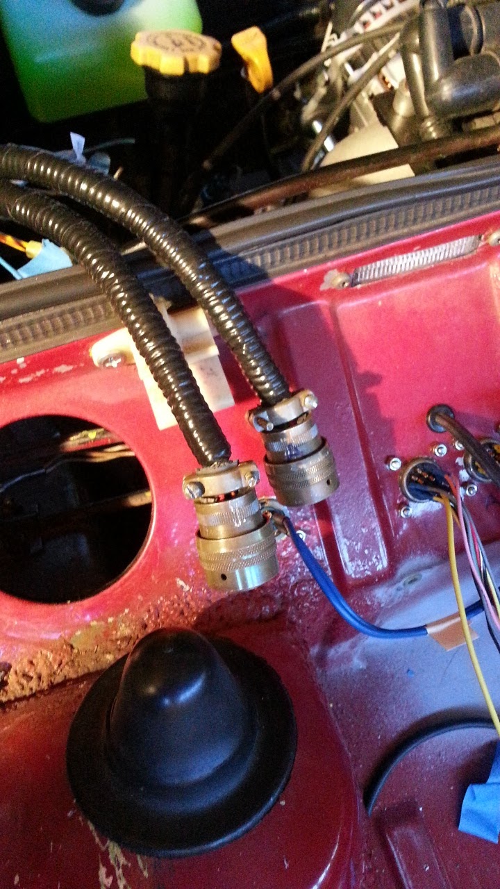

This weekend I tackled another item on the 914 "to do" list. I worked on getting my ECU mounted and the associated wiring sorted. When I decided to mount the ECU in the rear trunk, I wanted to be able to drop the engine without fishing a bunch of wire out of the trunk. The only solution that I could come up with was to connect the ECU to the engine with cannon plugs. So that is was I did. With the twist of 3 cannon plugs the engine is completely disconnected and ready to drop.

Pretty brake parts...I like your ECU mounting as well, great job!

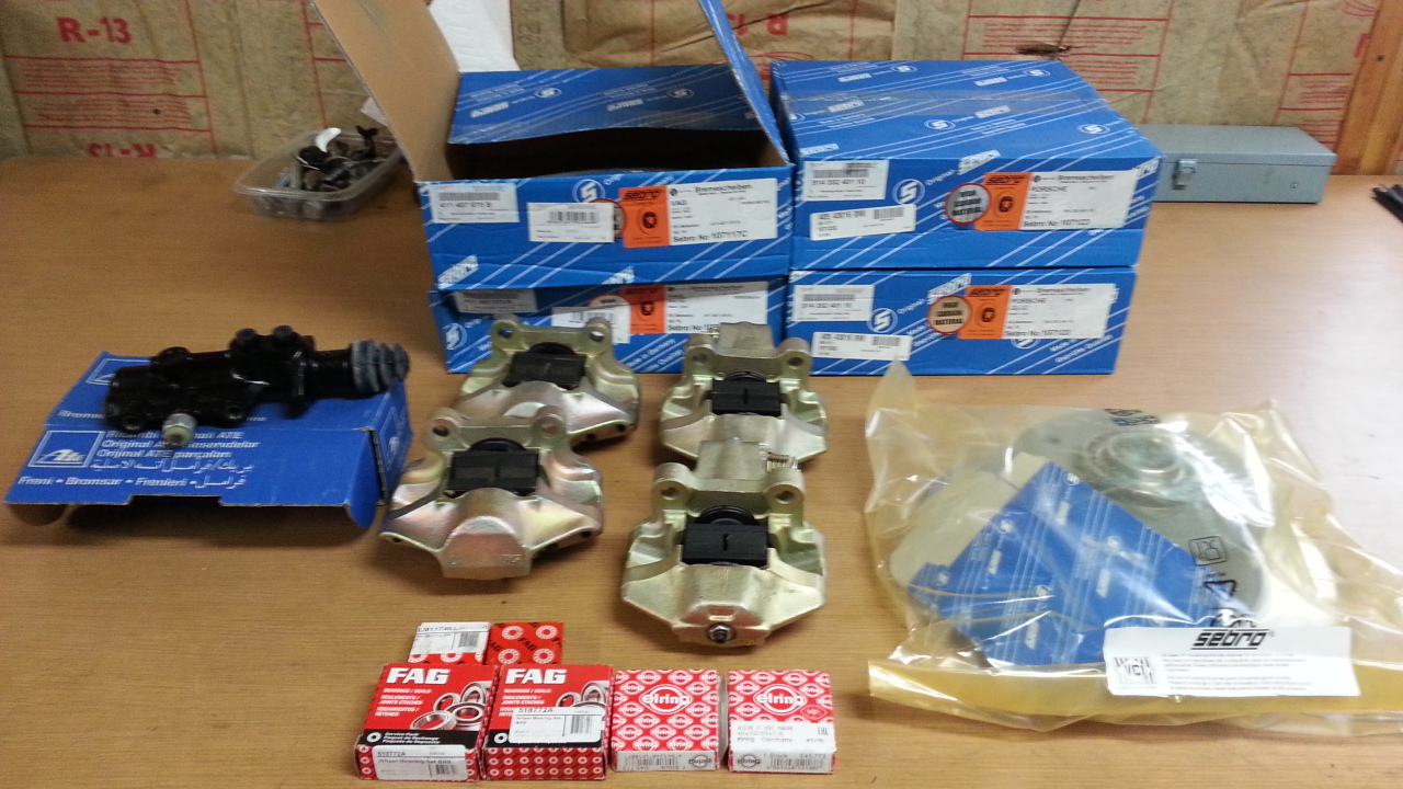

One down, three to go. They are sure pretty.

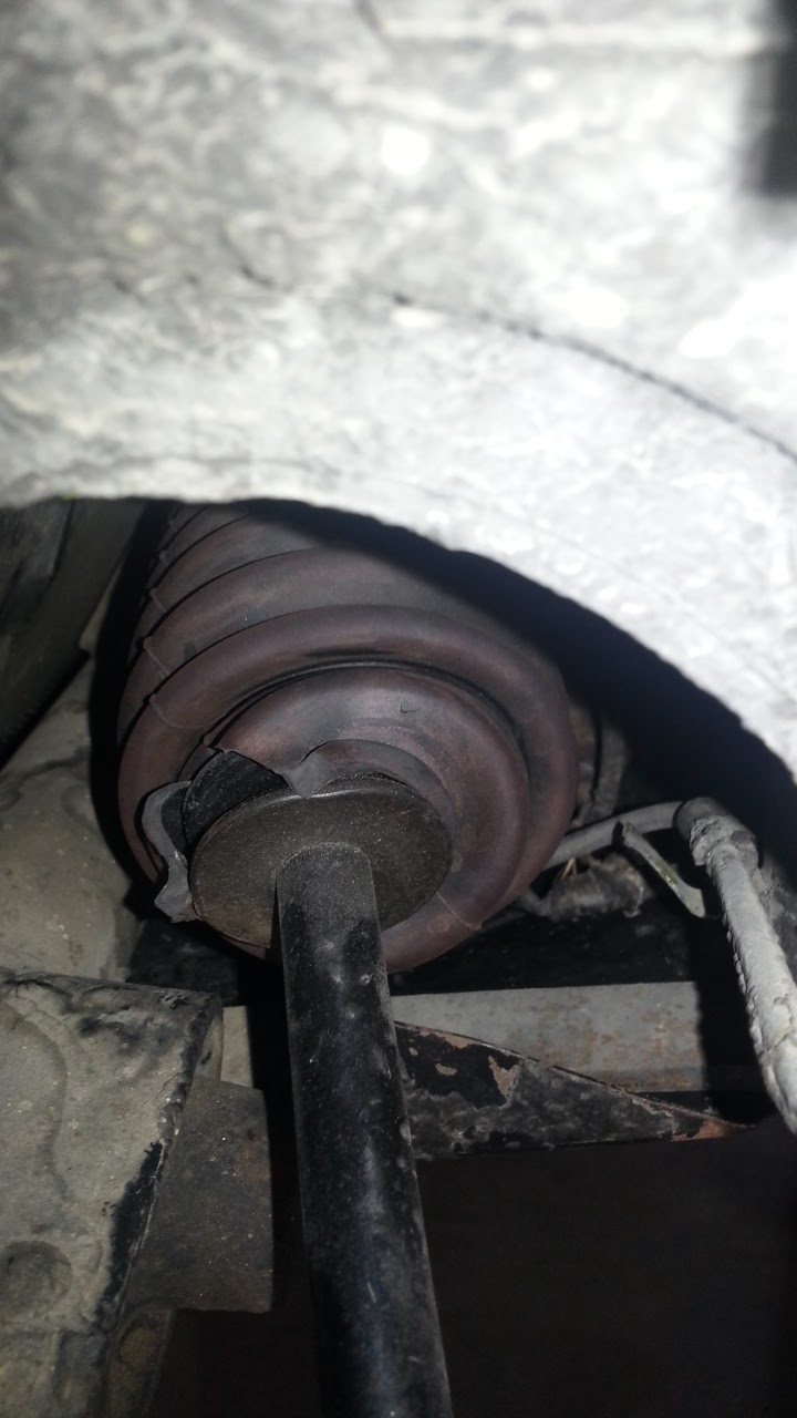

Wow that's a bummer. The only reason I have a Subaru in my 914 was because the head gaskets were leaking in my impreza. I pulled the motor and replaced the head gaskets then installed it in my 914. I replaced the motor in my Subaru with a lower mileage scrap yard find.

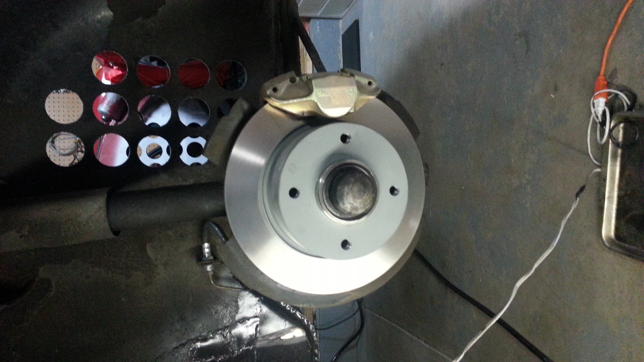

I was able to get the driver side rotor and caliper replaced tonight. I just have the rear rotors, calipers and master cylinder to go. During the replacement tonight I found this.Attached Image
The boot is less than 2 years old! Maybe I shouldn't have bought the cheapest turbo tie rods I could find. Now I need to find some replacement boots. (IMG:style_emoticons/default/dry.gif)

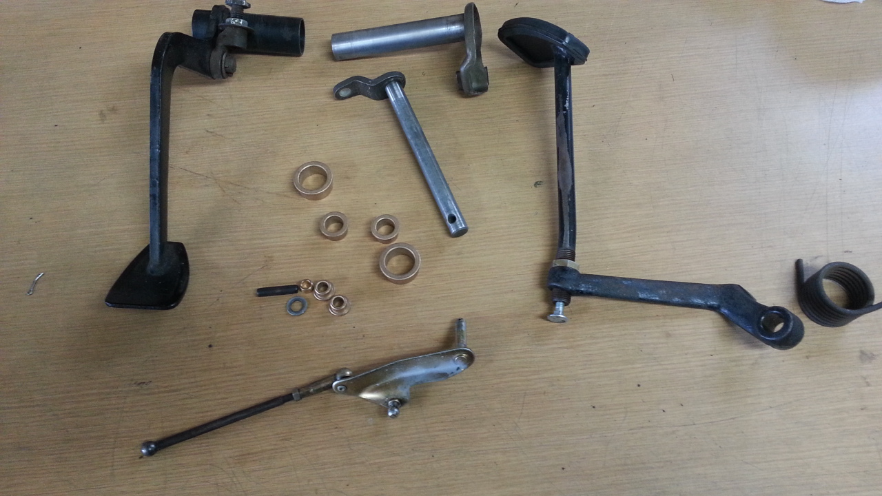

I am working on replacing the Brake master cylinder as part of a complete brake job and decided it was a good time to get side tracked. Time for some new Pedal bushings.
