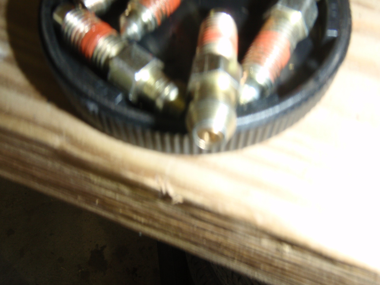

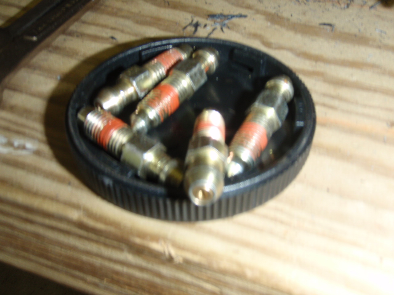

I am trying to bleed my bone dry brake system with a MOTIVE pressure system and a mix of long tube, but since they say you can't use SPEED BLEEDERS with MOTIVE, I want to make sure I am not chasing my tail.
I did bleed each corners twice so far and have some small amount of peddle, maybe 25% or so of normal.
the picture below is a new bleeder and one I pulled out of my jack standed car.

I'm no expert, but those don't look like Speed Bleeders to me.
stugray
post Sep 27 2013, 11:07 AM
Posts: 3,825
Joined: 17-September 09
From: Longmont, CO
Member No.: 10,819
You should be able to blow both ways through a normal bleeder, but only OUT on a speed bleeder.
They have little ball valves in them.

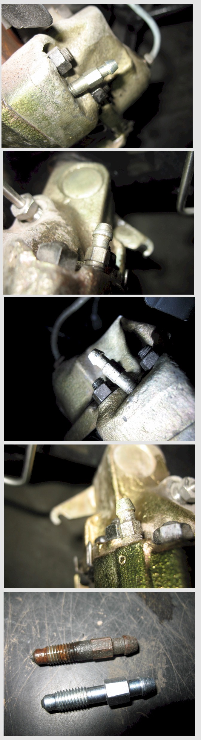

wndsnd
post Sep 27 2013, 11:35 AM
You wanted a horse, but got a goat. Nobody wants a goat....
Posts: 2,861
Joined: 12-February 12
From: North Shore, MA
Member No.: 14,124
These are speed bleeders Jim,
I took them out cause I couldn't get them to work.
John
Can't get the blur out but you can see the end fitting.
