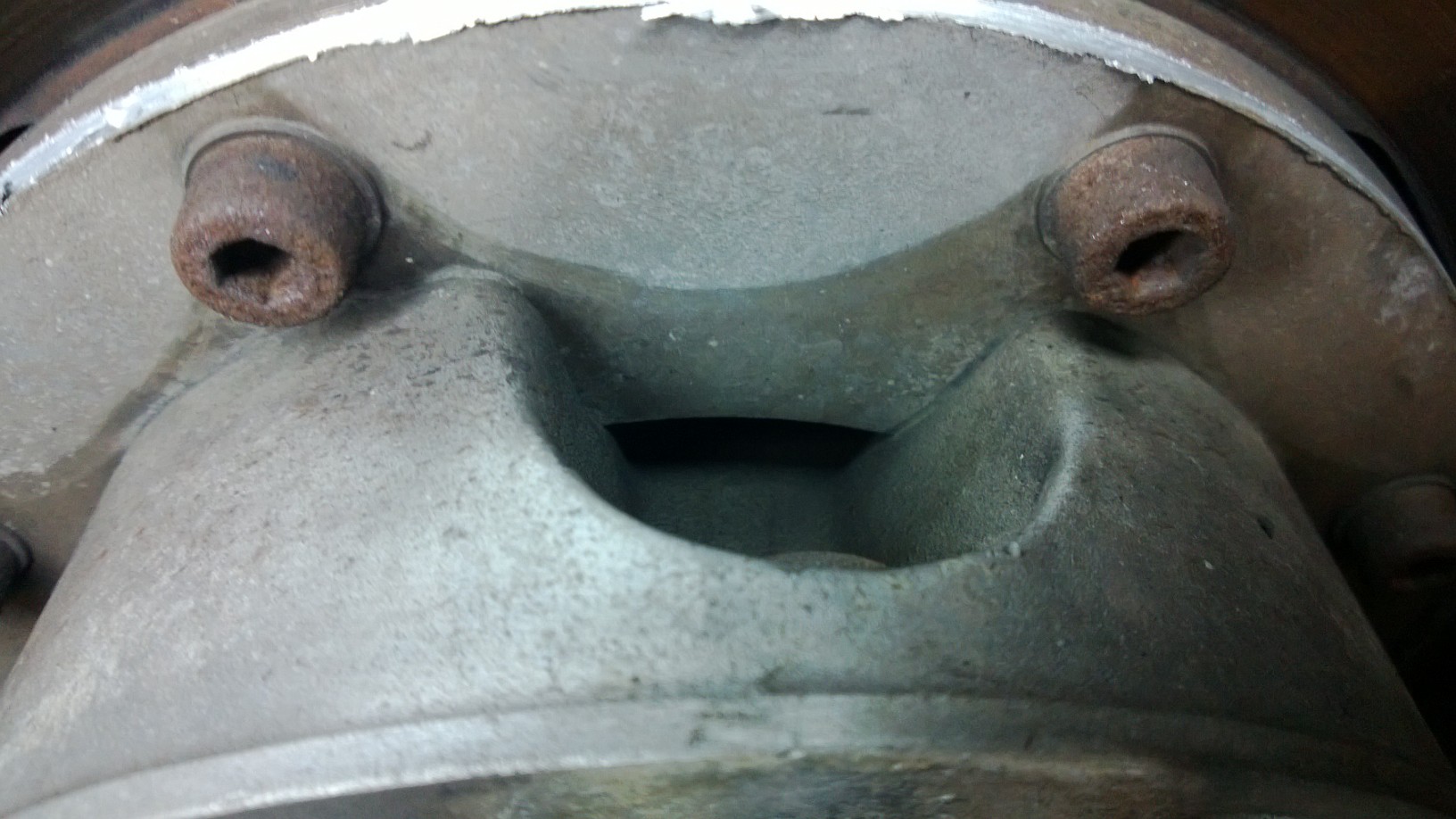

For my 1000'th post, I have attached a few shots of the damage to the hub from the brake pad. My plan is to take a grinder to the metal lip and take enough of it so it clears. Anyone see problems with that?

That's not the hub...that's the rotor hat! Dude... Not good!

I'm gonna guess you have the Volvo 4-pot calipers? If so, yes, with some pads you have to grind the metal away. I noticed it when I went and put a new set of pads on my calipers that it rubbed on the rotor hat. It's not a huge deal.. take a fine rasp, clean off the burrs, and grind down the metal backing on the pad..
No harm, no foul.

That's not the rotor hat either... That's an aftermarket cool rotor block off plate. Probably needs it because of the size pads in the Vulva calipers.
I'd probably make some changes.
Edit: it appears to possibly be a spacer to properly center the rotor. Cool rotor block offs should go in the back.

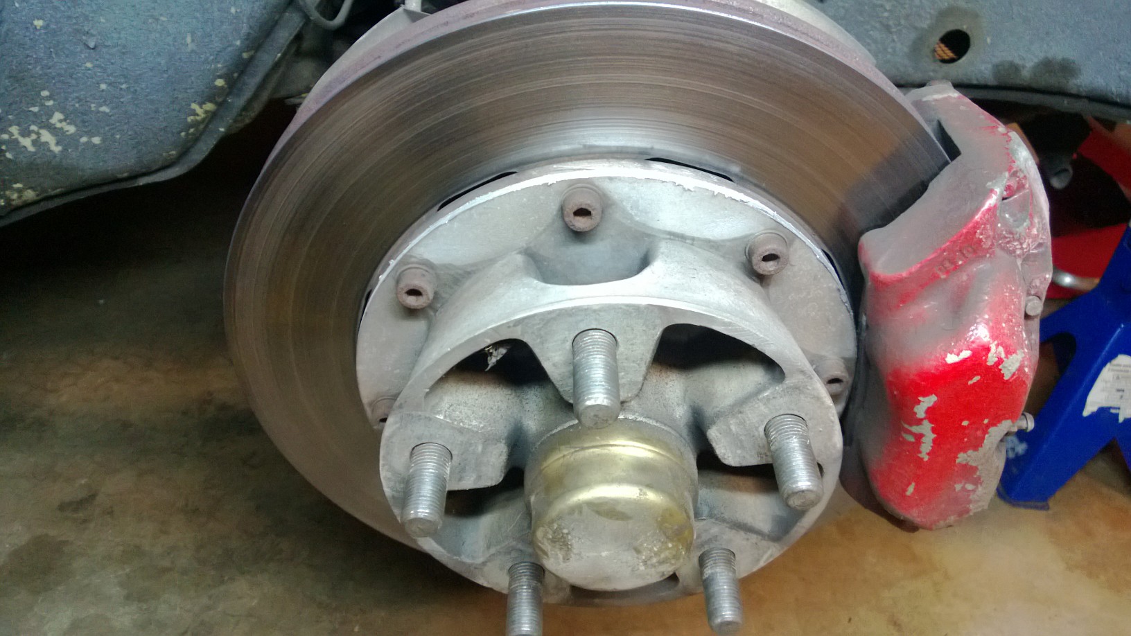

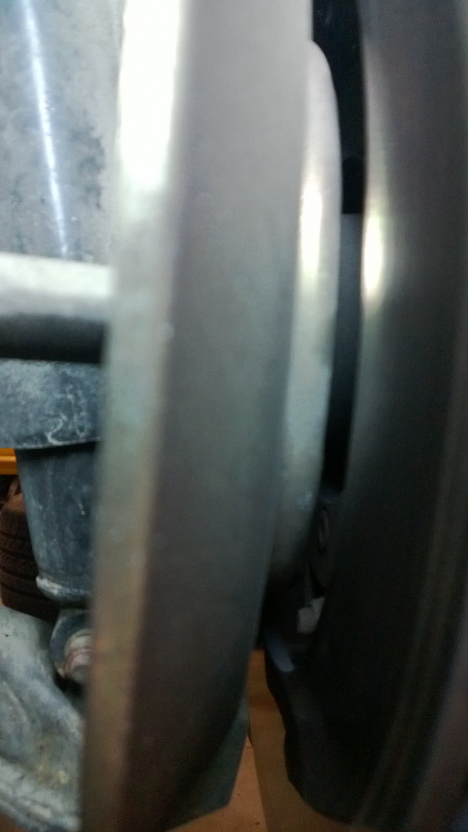

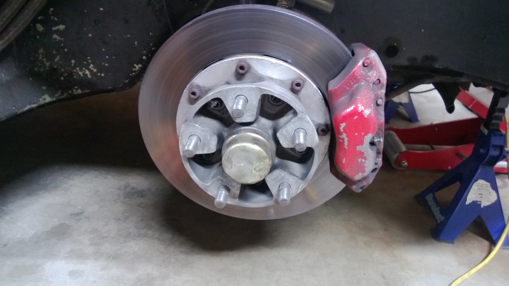

Maybe these photos will make it clearer. I'm running 911 struts, and the rotor is bolted only to the aluminum disc, which in turn is bolted to the hub. The other side of the rotor is floating.

Those are some sort of hat... Doesn't look as bad now that it's zoomed out...
