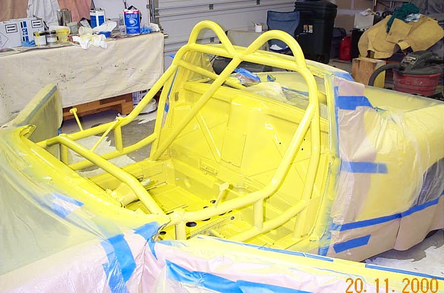

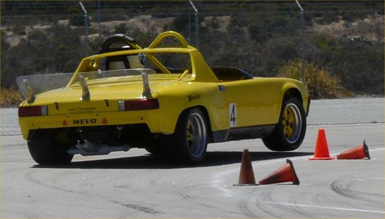

I did add about 60-80 lbs of tubing to stiffen the car. There is an immediate pay back...it transforms the car. The suspension does the work it's made for rather than have the chassis try to do it. The car responded to changes for good or ill. The best mod I ever made...I shoulda done it sooner.
I also added balast to make class (XP) but only 50 odd lbs. It came out for non-national SCCA events. I would suggest leaving a bit of room to your minimum weight as the scales a tour event are kinda iffy....I figure +/- 10-15 lbs. We filled the tank with gas in the lanes before our last run at one event to insure making it....that is cutting it too close.
If you do a roll bar, I would also suggest having some that know their welding do that work......that is more tactful than I normally get. (IMG:style_emoticons/default/biggrin.gif)
Having a car that over-rotates is better than a push for AX....... my preference.
Our venues were mostly asphalt & rougher than a cob. Relatively soft suspension still works on butt smooth concrete ...waving at the crowd with he inside front tire is fun.

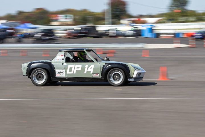

We ran the 914 at a new course last Sunday. The National Corvette Museum in Bowling Green KY has a decent parking lot near the road course. My thoughts on the site are mixed but the car performed well. My wife rode shot gun our 1st and 2nd runs. Then we went solo 3rd & 4th. My co-driver was two tenths behind my best run. I'm still having some issues with idle fluctuation that I suspect are cause by the linkage. It was a really warm day so engine temps were fairly high when idling in grid. With two drivers there wasn't much time to shut it down for cooling however.
Now the car is done for the season and I'm going to start preping for paint and body work. I think I will get a fiberglass bumper for appearance. This winter will not be near as intense as last and I'm thankful for that. I'll post when some progress is made on the body work but don't expect it to be text book by any stretch of the imagination (IMG:style_emoticons/default/smile.gif)

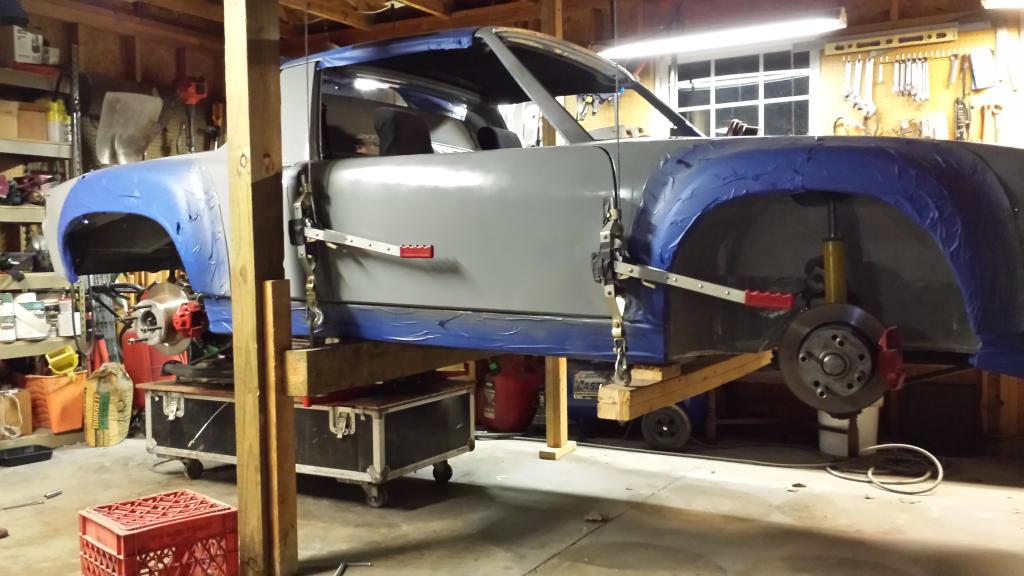

We had a set back today. I've been plumbing the fuel system, body work and painting for several weeks now. Today I finished the fuel system and flushed the lines with the new pump into a catch can. After putting the lines back on the Webers, I turned on the pump and noted 6 PSI on the fuel pressure gauge post the FPR. I went ahead and started the engine in preparation to dial the FPR down. As soon as I started the engine, it rev'ed up (maybe 3000 rpm, probably due to the increased fuel pressure) and within a few seconds it just stopped, suddenly. There was no loud noise or indication of failure. When I tried to start again, the starter is just clicking. The solenoid is engaging but the motor isn't turning over. Suspecting the worst, I got under the car and tried to turn the motor over by hand, the crank isn't moving either way. I pulled the spark plugs and still can't get the crank to move. To eliminate a seized starter, I pulled it off and still no dice.
I can't figure out why there would be a major problem with the car just sitting for a month and a half. During my fuel delivery project, everything on the motor was buttoned up. Intakes and carbs stayed on. Exhaust stayed on. Crap (IMG:style_emoticons/default/sad.gif)
So I finished the day putting the car back on the hillbilly lift, preparing to drop the engine and transmission. Next step will be to pull the tranny off and try to hand crank. The only other external device I can think of would be the distributor. Suggestions encouraged and appreciated.

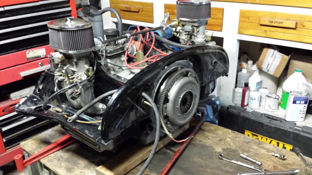

Dropped the engine. Pulled the transmission. Crank is still locked.

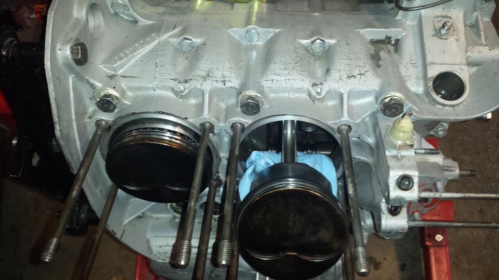

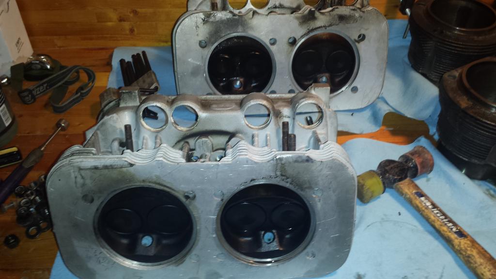

Han Solo
post Dec 14 2014, 04:57 PM
Post #175
Posts: 291
Joined: 30-September 13
From: Middle Tennessee
Member No.: 16,456

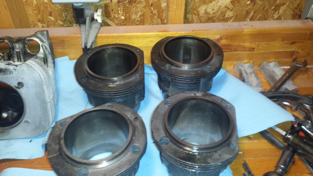

So I got the heads off today and there's nothing that unusual to report. Hydraulic lifters look good. Push rods fine. The valves are all fine. I noted that it appears Brothers welded the valve seats on by the springs to prevent the seats dropping. They also have shims under the rocker assembly probably due to the chromolly push rods. When I got the jugs off #3 and #4 have some wear that's just noticeable. A section about 3/4" wide going down one side of the cylinder wall. I can just feel it with my finger tip but those pistons (as well as #1 & #2) slid out easily once the seal on the jug let loose. All the rings look like new and as well as the piston tops. There's some carbon build up but it doesn't look excessive to me. The crank is still frozen so now I'm down to splitting the case to find out if it's crank shaft or cam shaft. I'm watching the Jake Raby type 4 video and that's most helpful.
(IMG:http://www.914world.com/bbs2/uploads_offsite/i1336.photobucket.com-16456-1418597844.1.jpg)
(IMG:http://www.914world.com/bbs2/uploads_offsite/i1336.photobucket.com-16456-1418597844.2.jpg)
(IMG:http://www.914world.com/bbs2/uploads_offsite/i1336.photobucket.com-16456-1418597844.3.jpg)
(IMG:http://www.914world.com/bbs2/uploads_offsite/i1336.photobucket.com-16456-1418597845.4.jpg)
yeahmag
post Dec 15 2014, 09:28 PM
Post #176
Posts: 2,462
Joined: 18-April 05
From: Pasadena, CA
Member No.: 3,946
Looks like it will turn over with the heads off... Are the chambers as wet as they look?

QUOTE(yeahmag @ Dec 15 2014, 09:28 PM) *
They were pretty wet but I sprayed quite a bit of WD40 in the cylinder in a vane attempt to free things up. And the crank is still locked up with the cylinders off (IMG:style_emoticons/default/sad.gif)
yeahmag
post Dec 16 2014, 06:16 PM
Post #178
Posts: 2,462
Joined: 18-April 05
From: Pasadena, CA
Member No.: 3,946
Ah... It's more obvious from my desktop that you spun the entire motor around. Didn't make that out from my phone. Sounds like a bit of main bearing welding may have been done then...
