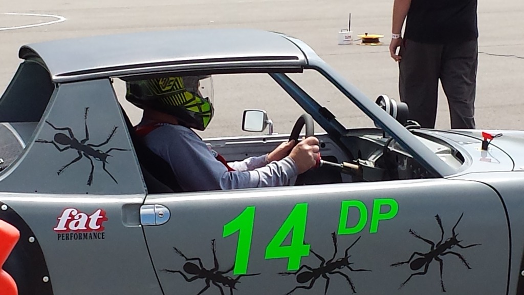

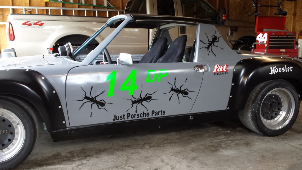

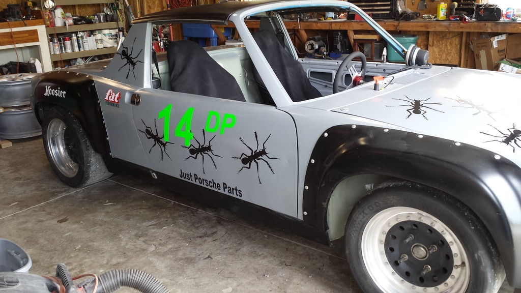

HAIRY ANT NEST RACING 914!

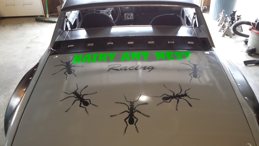

Time to let everyone know just how nuts I really am. Going with the wildlife theme (remember the three ant nests infesting car when I got it?) and making that into a racing team. It's a rough paint job that I can touch up with smoke grey Rustoleum. The graphics were applied with stencils and took quite some time. If it's good weather next weekend, we will be driving this beast.
OBTW - I got the Mallory FPR and that fixed the last fuel leak. I also wrapped the headers and collector with exhaust wrap so hopefully I won't be melting down the clutch cable pulley or emergency brake cables. The new FPR is running about 4.5 PSI but the Webers seem to be fine. I took it for a quick road test and then did an oil change. The oil and sump looked fine with very few metallics. I think we're ready!
(IMG:http://www.914world.com/bbs2/uploads_offsite/i1336.photobucket.com-16456-1429394117.1.jpg)
(IMG:http://www.914world.com/bbs2/uploads_offsite/i1336.photobucket.com-16456-1429394118.2.jpg)
(IMG:http://www.914world.com/bbs2/uploads_offsite/i1336.photobucket.com-16456-1429394118.3.jpg)
(IMG:http://www.914world.com/bbs2/uploads_offsite/i1336.photobucket.com-16456-1429394118.4.jpg)

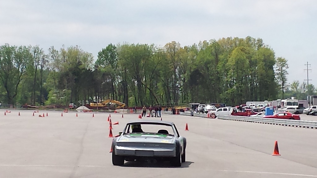

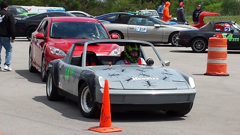

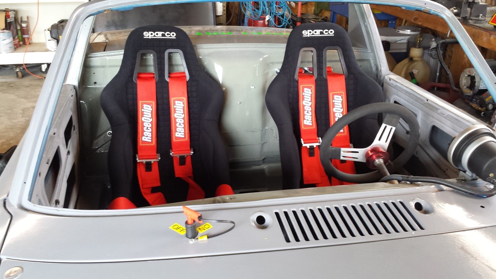

What a great weekend! Friday I received the RaceQuip racing harnesses I ordered and got them installed that evening except for the submarine (needed some hardware). I did the shoulder belts like Porsche on the factory 914 race cars. U-bolts through the rear bulkhead. And I used the OEM attachment points for the lap belts.
Then Saturday we loaded up the car for NCM Motorsports Park. I was the event chair so we did a course layout Friday evening before storms came in. Stayed overnight at a KOA and was back on-site at 6:30 AM tweeking the course. I was in the second of three run groups and temps were still cool. The car started first crank every time. My course had a couple of somewhat tight 180 turns and that 2056 pulled through those in 2nd gear no problem. Greg from FAT had sent me a 6500 rpm rev limit rotor and that was crucial to getting good time as there were two fast sections. I was actually taking 3rd in those and after several runs got good at not only finding the appropriate gears but making the shift points. I think this transmission is a keeper! At some point in the future I do want to get a performance gear shift however. Engine oil temp barely came off the low mark so the engine is cooling well. I also touch tested the clutch pulley mount with no finger burns so the exhaust wrap is doing the job.
Next expenditure will be new race tires but that's about it for the season unless something breaks. I'm very pleased with this build and now it's time to enjoy it (IMG:style_emoticons/default/piratenanner.gif)

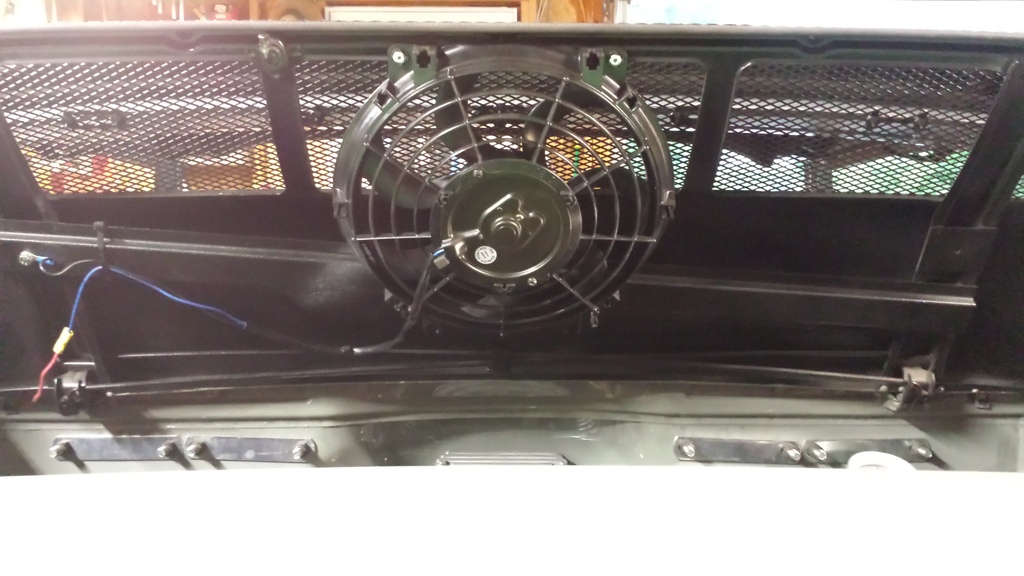

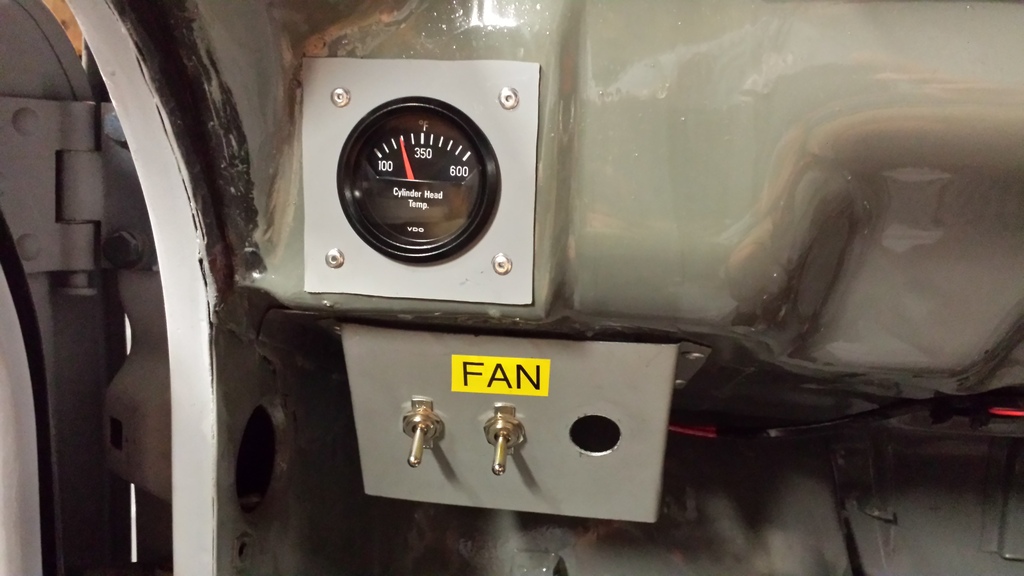

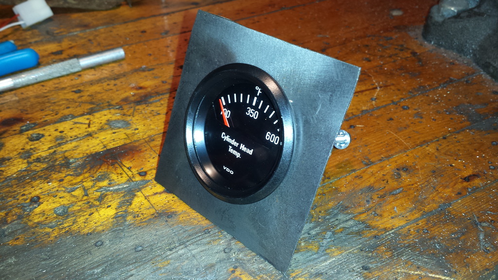

At the last autocross we raced the 914, I had two issues that needed addressing...
One, I suspect the engine is getting hot without the engine console tins. Readers will remember I removed those because of bad rust holes.
Two, the alternator belt was coming off just about ever lap.
Now those two issues may be related. If the engine compartment is getting hot, the belt could be getting soft and loose. I repeatedly checked tension and there's just no way to get a bar in between the tins and really pry on the alternator. I have purchased a Gates belt with kevlar that supposedly gets tighter with heat. The current belt is a new Conti.

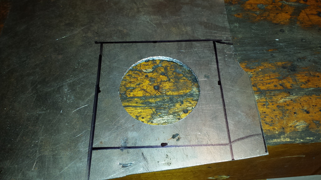

I read several threads where it was pointed out that the oil temp gauge is not a good way to monitor engine temps. So I ordered a VDO head temp kit from Pelican. But before I took delivery on that, I went ahead and got an electric cooling fan. 11" was the smallest at the local O' Reily's and it actually fits fairly well. I mounted it under the grill because the drip pan is off on this car. Two holes with 3/8" pop rivets into the back edge of the grill frame. And then two tie wraps on the front side. I installed with the fan blowing up thinking that heat is going to rise anyway, best just move it on out of the engine compartment. I used a switch panel I made back in the winter for bench testing, mounting that under the driver side vent hole. Hookup was very easy as I've got terminal strips for hot and ground under the dash with open lugs.
Last weekend I got the head temp gauge kit. I thought maybe the gauge would fit nicely in the vent hole but it's about 1/4" too small. So I fabricated a bezel out of sheet metal. The instructions call for a 2 1/16" hole but a 2" hole saw cut a perfect size hole. I cleaned and primed that. This evening I installed the gauge and wiring. I put the ring terminal sensor on #3 spark plug as that's the easiest to get to and directly above the exhaust collector. The hardest part was fishing the connectors through the tunnel, along side my custom harness and into the engine compartment. The sensor or gauge does not require 12V so I'm not sure you should cut, crimp or splice that harness. The wire itself may be passing the thermal temp to the gauge.
I tested the engine and the gauge works great. Climbing right up as the engine warms. It settled in at 350F in the garage on a fairly cool evening. I kicked in the fan but didn't notice any change in temp so I'm not sure that is effective. I plan on racing this weekend so we'll see how it goes outdoors, warm day and higher revs.

Not sure how this is going to work. Wouldn't you want to pull cool air in? I like the idea though...
yeahmag
post Jun 9 2015, 09:54 AM
Post #226
Posts: 2,462
Joined: 18-April 05
From: Pasadena, CA
Member No.: 3,946
I really doubt that's going to do anything when the car is running. I suppose it could have a small impact on heat soak when the car is off...
A couple thoughts/questions come to mind:
* What makes you think the car is getting hot? Oil Temps? Head Temps?
* Replacing the belts is a good idea as they tend to get deformed occasionally after being thrown off.
* Did you check the alignment of the alternator to the crank fan assembly?
* "Typically" all rubber belts get tighter as they heat up.
I'm running with the heat rises concept. That fan can be reversed however.
Idle oil pressure got down around 20 psi after a few runs and oil temps were up about 1/2 of that gauge. Agreed on the alignment. I'm going to straight edge those pulley faces to see exactly what's going on.

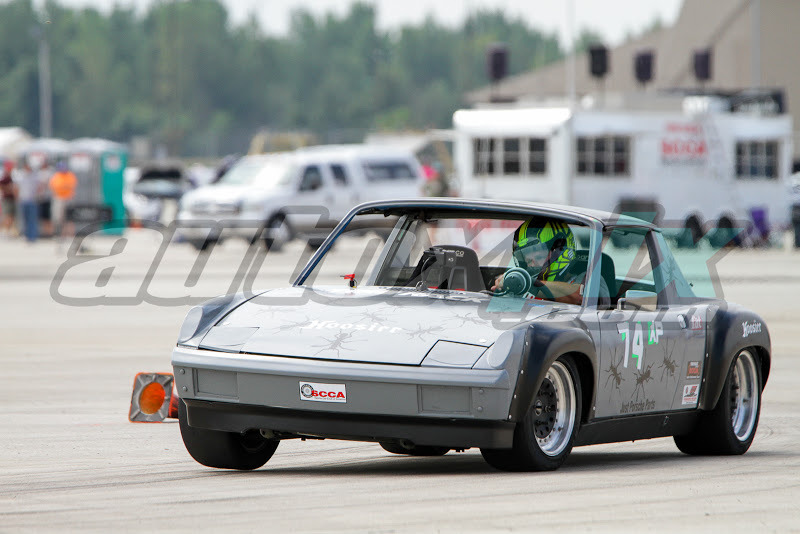

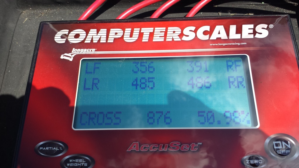

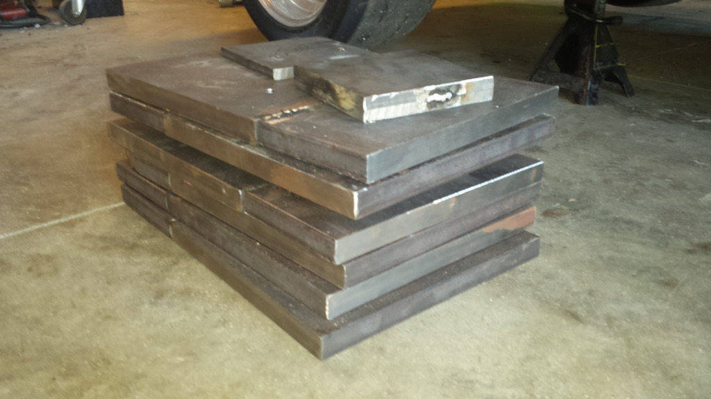

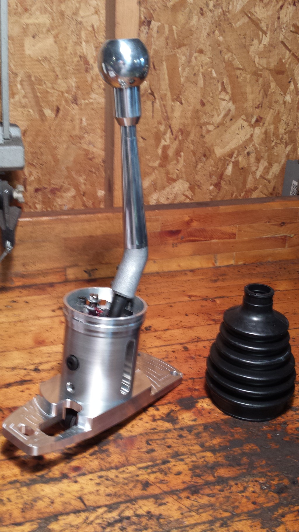

Update on the race car.
I did get the performance shifter installed and it made a HUGE improvement. Coupled with the shim under the shift fork ball and I'm able to get from 1st to 2nd to 3rd to 2nd, etc. with no problems. I ran the car at a couple of regional events before last weekend's Championship Tour in Ohio.
What has been a issue is minimum weight however. That minimum in SCCA Solo DP class is displacement = weight (2-valve per cylinder cars) so that put mine at 2056 lbs. without driver. Without any ballast, the car weighs 1638 lbs. That meant over 400 lbs. of ballast. So I added hot rolled steel plates (least expensive) in 12" x 12" chunks of 1" and 1/2" thickness. It took stacks to get that weight which I bolted to the floor pans. I ran the car 4 runs in that trim at a regional with a decent course. The car handled well but acceleration was poor. For the next heat, I took out all but one 1/2" plate on the passenger side for XP minimum of 1653 lbs. Quite the difference with very good acceleration. So I'm in XP now with a greater level of preparation for many different makes and models (including engine swops). Oh well, might as well just drive as best I can and have fun.
Here's some photos of the shifter, ballast, etc. And a link to one of my runs at the Champ Tour.
Also, I started in on a restoration project some of you may be interested in. An '82 924 Turbo that needed saving.
931 restore thread
Wilmington Champ Tour run 3
(IMG:http://www.914world.com/bbs2/uploads_offsite/i1336.photobucket.com-16456-1440173964.1.jpg)

A month or so later and we've got two SCCA Solo National Tour events under our belts. Wilmington OH and the Championship at Lincoln NB. Wilmington was sort of a throw away. The car ran okay but I DNF'd two runs on the second day. Chalk that up to lack of concentration. That was a pretty fast flowing course and I had to shift multiple times second to third and third to second. Good practice for Lincoln however. Here's a video...
Wilmington 2015 3rd run
And some photos from Perry Bennett...
(IMG:http://www.914world.com/bbs2/uploads_offsite/i1336.photobucket.com-16456-1442660604.1.jpg)
(IMG:http://www.914world.com/bbs2/uploads_offsite/i1336.photobucket.com-16456-1442660604.2.jpg)
(IMG:http://www.914world.com/bbs2/uploads_offsite/i1336.photobucket.com-16456-1442660604.3.jpg)
More from Nationals in the next post.
