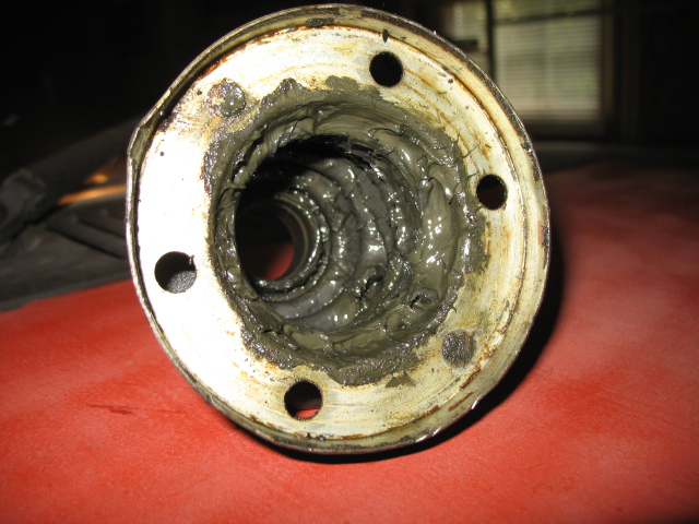

I assume that since all the boots I have been sent have 6 holes instead of the 4 holes that I took off that that is all that is available these days?

We just installed a pair of axles for a customer who purchased them direct from Porsche recently.
The flanges all had 6 holes even though the CVs were real 914-4.

Is there any need to do anything to keep the extra holes from leaking grease? Does anyone use any kind of sealant or gasket between the boots and cv flange?

I have a few OFF's in my garage, and at first I thought they were 6 holes, but realized they were four. i'd say clearly, that 2 open holes will let some grease fly.

Kind of uneasy leaving them open but what can you do besides dabbing them with sealant. And will the sealant adhere to the greasy mess or just fling out?
Also makes a good argument for using gaskets and wired bolts with Schnorr washers.

trying to seal them wont work. replacing them is your only choice.

I would plug the holes with rtv.
