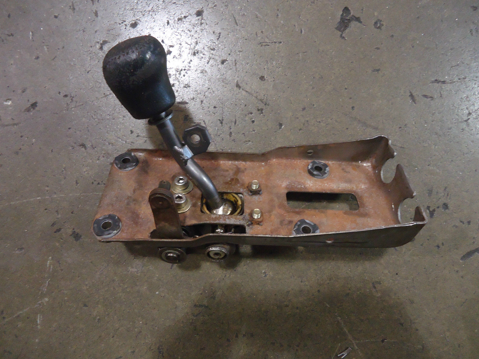

we'll see soon enough - but does the mr2 shifter (1991-1995 model) you are using looks like this one?

Thats what I got sitting on my shelf. They are pretty cheap still, cable connectors set to go in the proper direction, though I'm doubting I'll be using the base. Maybe as a sacrificial lamb. I like these because its easy to change the shift trough ratios. You just move the attachment point on the shifter. Grind, move, tack, test, weld, done.

QUOTE(jimkelly @ Jan 17 2014, 04:49 AM) *
That is the style that I'm using, though it looks like there should be some cutting or yet another design project, as the cables don't like the OEM shifter housing...

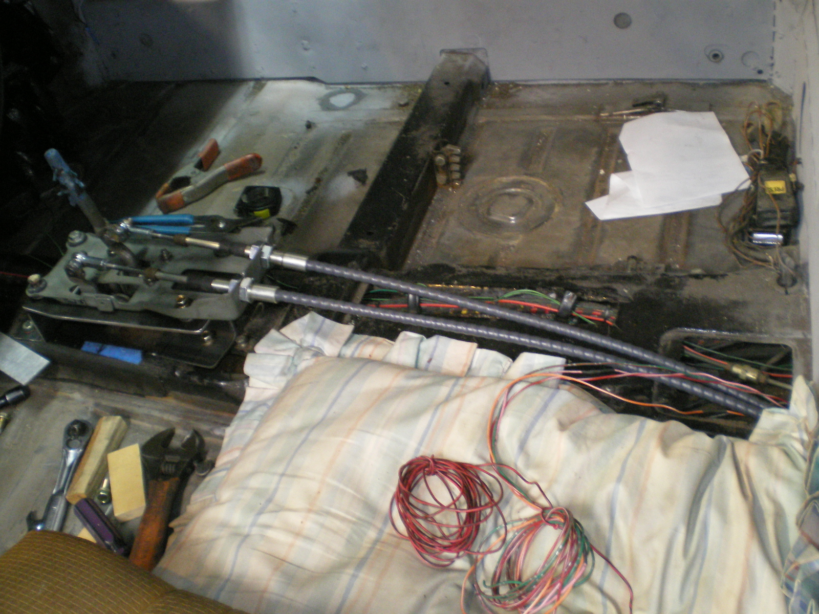

Ian - do you have a close up of the linkage you are using to connect the bell crank to the gear selector? Are you using little ball joints?
IM101
post Jan 17 2014, 10:48 PM
Post #108
Posts: 264
Joined: 9-November 10
From: Boise Idaho
Member No.: 12,367
QUOTE(skeates @ Jan 17 2014, 09:42 PM) *
They are small ball joints, one of things i will be changing for the production model, just needed something to get me by for the prototype that also gives acurate dimensions.

QUOTE(IM101 @ Jan 17 2014, 08:48 PM) *
That make a ton of sense. I love the way you're going with it, can't wait to see the final version!

QUOTE(IM101 @ Jan 17 2014, 07:57 PM) *
Ian,
I used the MR2 shifter on my car with the 901 trany. I recall debating if I wanted the 914 shift pattern or first gear forward. I ended up putting 1st forward, as I felt it is a more normal pattern. The down side of this is both of my cars are different (IMG:style_emoticons/default/blink.gif)
I was just curious if you kept the 914 shift pattern with 1st gear back, reverse forward?

Mike, I went with the subaru OEM pattern, 1st forward. Figured keeping it that way would be better just for non 914 applications.
What size cables are you using, Ian? These are 1/4" on the MR2 shifter. Did you go 5/16"?
IM101
post Jan 21 2014, 09:41 PM
Post #120
Posts: 264
From: Boise Idaho
Member No.: 12,367
Nope I went 1/4, strange that it looks like yours fit into the mr2 nicely...
