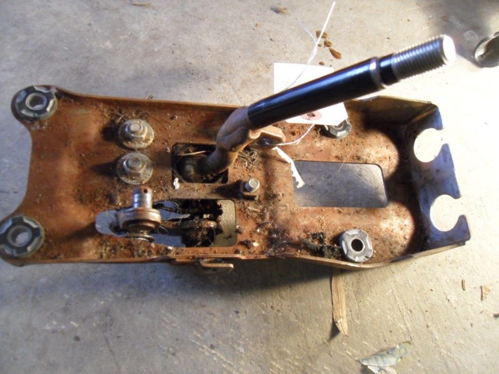

Really, as long as it looks like one of these...you'll be fine.
Earlier...later...shouldn't matter. As long as the cables go backwards, you'll be ok.

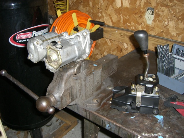

I heard the 90-91 Honda Accord shifter is AWESOME which is why I bought one. You have to flip the "action" of one of the levers around from it's stock position (left-right probably) to use it but I'm gonna try it out before I buy an MR2. Probably remove the outer part like D914 did. Just need a set of separate cable mounts to do that but it looks pretty easy.
Here's a pic...from my thread but D914's setup...

(IMG:style_emoticons/default/beerchug.gif) (IMG:http://www.914world.com/bbs2/uploads_offsite/i1315.photobucket.com-15718-1398266215.1.jpg)
here's my 00 mr2 shifter I'll b using.
It looks like a winner 2 me.

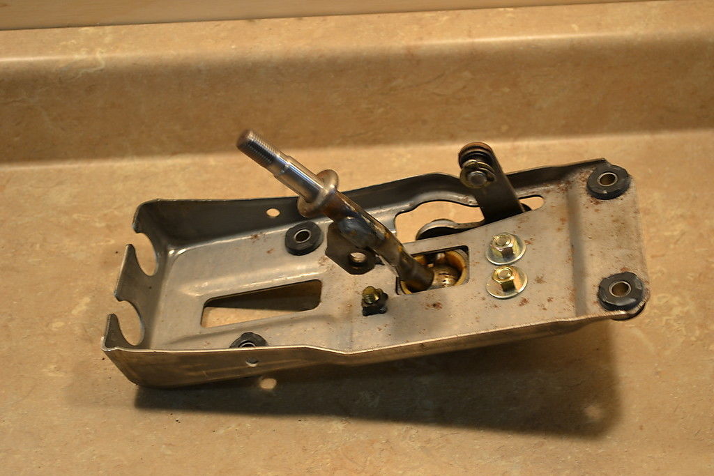

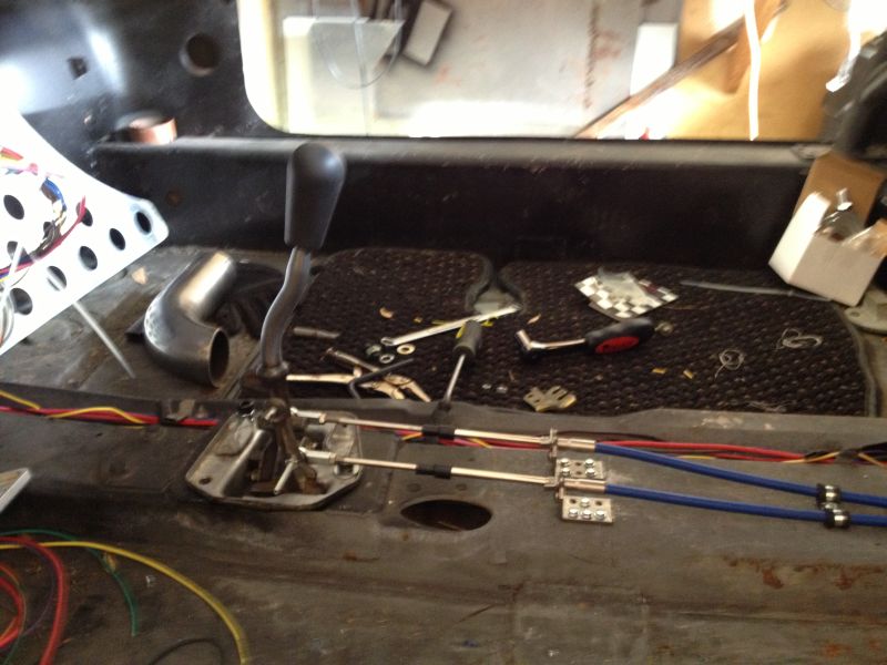

I started with a MR2 shifter and changed over to a Corolla shifter. This did need a revesal of the gear selector. I added a bearing and bell crank at the shifter. This allowed me to also set the length of travel for the shifter. It worked out fine.
You can make most any shifter work. We spent a few days in the pick and pull looking at different options.
Corolla shiferAttached Image
Mounted in the car Attached Image
Bob

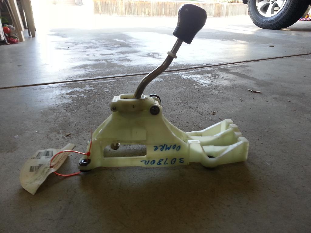

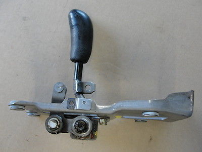

MR2, Corolla, Celica, Mitsubishi can all be made to work, though the MR2 doesn't need to be turned around. I'd probably avoid the all plastic ones (late MR2 and Boxster), as they don't lend themselves well to modification. The Corolla/Tercel shifter Bob mentions is quite nice. I went with the Celica (after buying three different Toyota models) as it had greater gate travel that my 6 speed needed.
