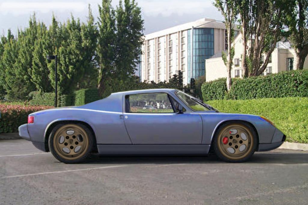

Making it all fit,in a nice 904 house,the LeMans windscreen a great fit on the 914.
The windscreen is indeed a 904,and therefore a little pricy,making this six conversion no cheap thrill.
Very light,strong,powerful,quick and fast,all the wishes granted for this 914.
A revised double wishbone front suspension,the rear getting a pair too,(mebee a fabbed upright in light wrought alloy).
The latemodel bumpers have been radically modded to meld with the lengthened nose and tail's bottom,a major change.
A normal door,widened,with windup intact,the frame in cfrp,the glass waterjetted to fit.
Inside,the standard interior will do,the seats customised to shave 60mm off the bottom,the same as the roof's chop.
This is the factory wheelbase,the track widened to carry the larger modern rubber,I chose the ATS 5-Phons of the 928.
The nose and frunklid have been heavily modded to meet the windscreen's valance in a smooth radius,following the cowl.
The nose of the lid is radiused to match the new bumper's recurve.
A good deal of work,not for the faint of heart,a modern suspension with the factory parts reworked.
Two months later,I did some drawing,mapping out the front suspension,setting up the rear for a big change.
I haven't added the massive sidescoop,yet,letting the shape grow on me a little while.
Like,not looking at it,then,looking at it,to see if I still like it.
I do!
