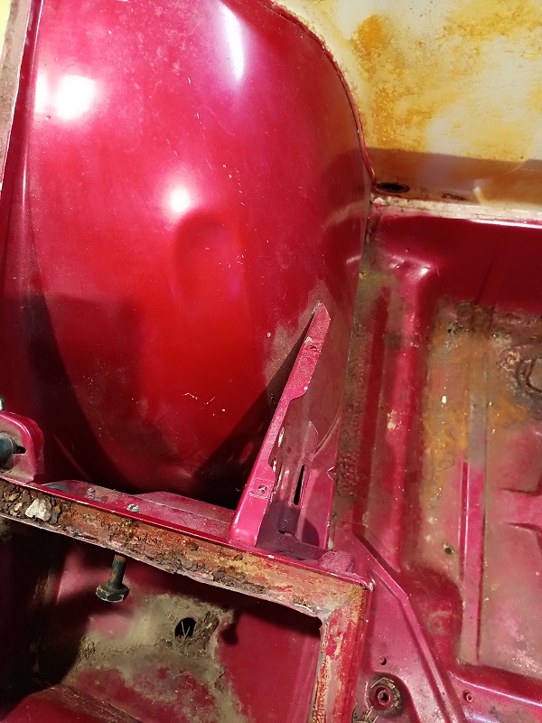

Parts Clip arrived. Originally a white car.
rhodyguy
post Oct 25 2023, 04:24 PM
Post #131
Posts: 22,254
Joined: 2-March 03
From: Orion's Bell. The BELL!
Member No.: 378
WOW, that was a fast acquisition. The hood channel looks pretty good. Big cuts a coming. Following.

QUOTE(rick 918-S @ Oct 26 2023, 10:18 AM) *
Impressive work ,working on a compound curve and some rack pull outwards @ the same time wow, where do you plan cut for the clip ? ,I would assume forward of the wheel wells ?.
Great to see this car back Rick ,keep up the great work (IMG:style_emoticons/default/beer.gif) .

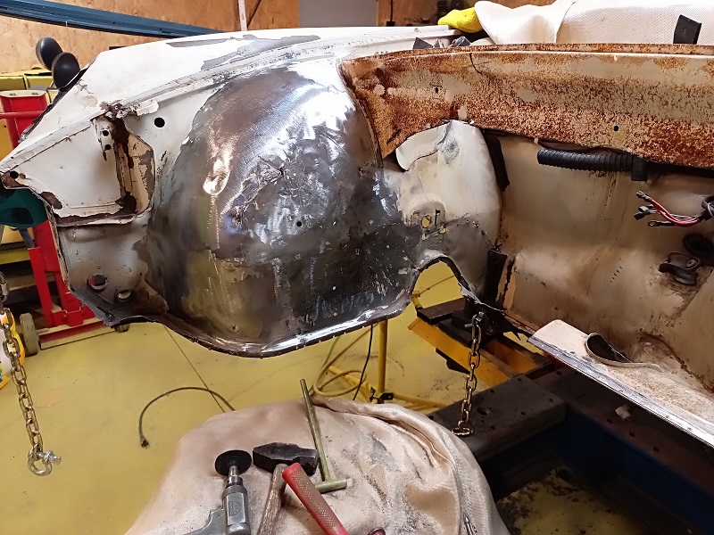

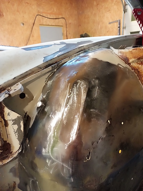

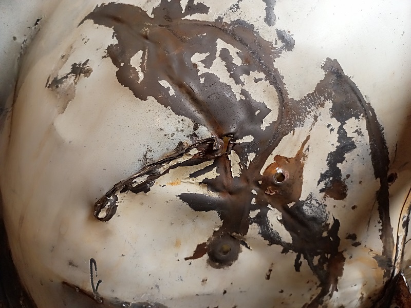

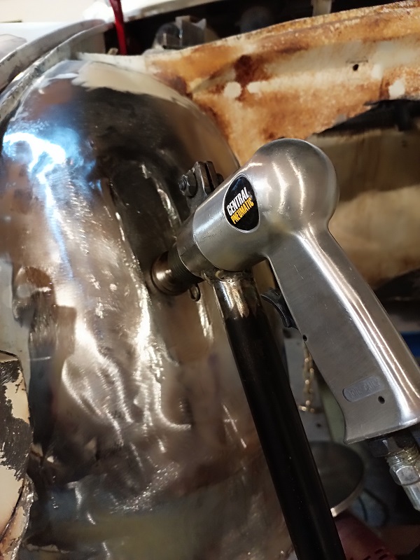

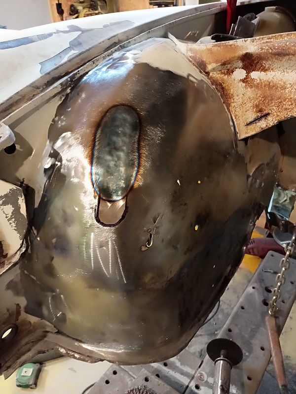

Continuing to work the right inner panel. I am not sure you noticed but the depression on the wheelhouse was completely obliterated and wrinkled. In order to repair the shape I had to hammer it smooth first then put the depression back in. Here is a reminder of where this started.
Then the reshape
Then adding the depression back in. I started with the torch and a homemade hammer made of 3/4" roundstock with a bullet or rounded face. I just wanted to bump the metal down when it was mallable.
I spent about an hour and a half working the shape with hammers and dollies. When it was shaped and the lines we sharp I ran the planishing hammer thru the depression to smooth it out. Then used the shrinking disc to tune up the edges.
Compared to the donor clip

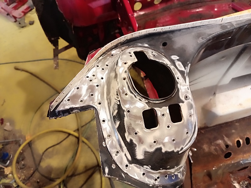

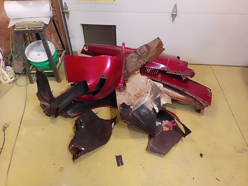

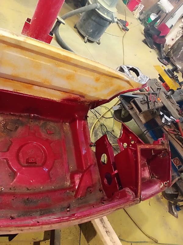

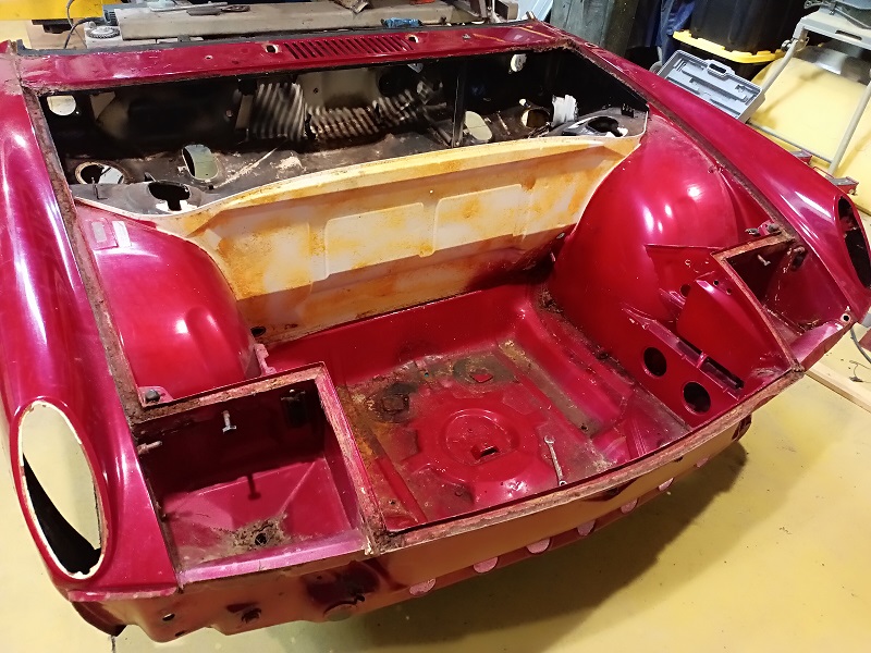

Started trimming the parts clip. I and separating the outer cross brace fro where it caps over the wheelhouse. I have done this before when I changed a factory wheelhouse on Juergen's 6. The spot welds are tiny and fairly easy to drill out. I will tig the holes when I put the outer cross brace back over the wheelhouse strut caps .
Working my way around the floor pan. I have most of the left side off. I have the bumper brace and the headlight brace trimmed.
The scrap pile is getting bigger.
