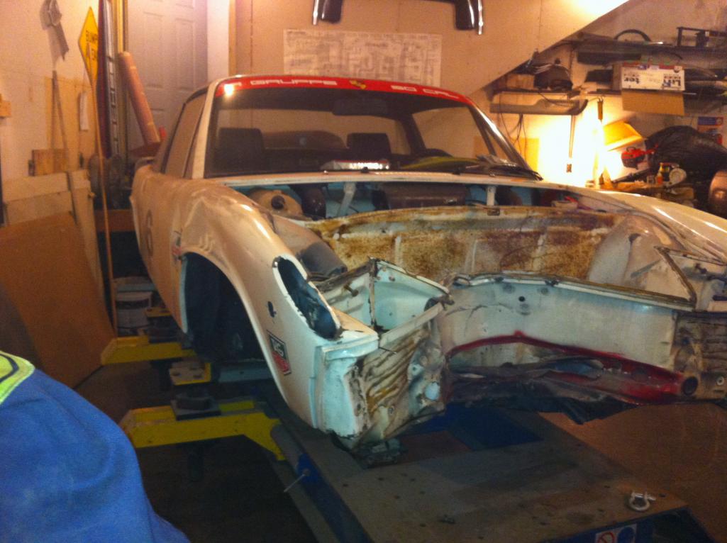

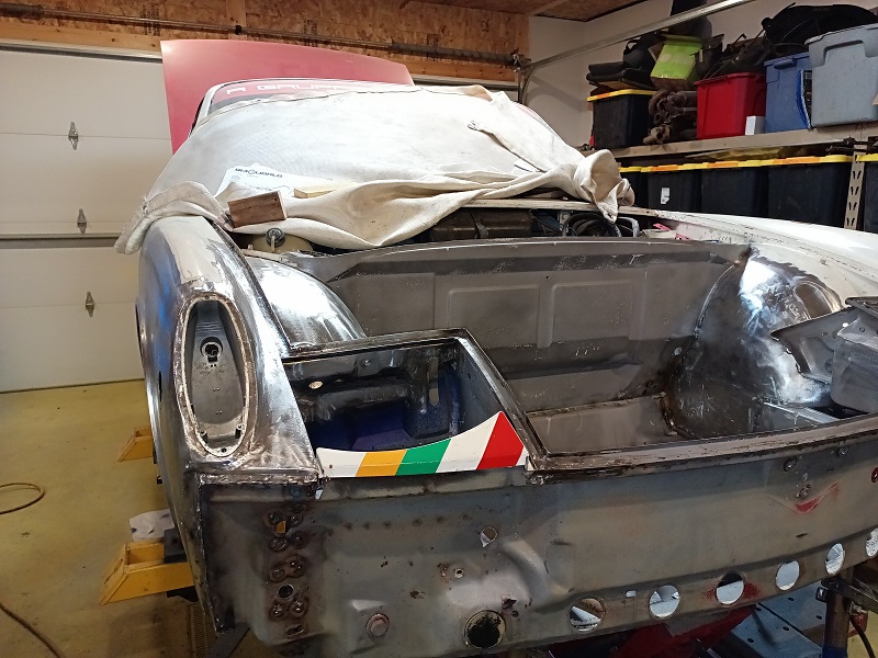

Now on to the car. I have it home now. My son Aric and I spent some time doing forensics on the chassis. We dropped the suspension and started removing some of the bolt on stuff that will have to be cleared in order to repair the chassis.
I plan a full on documented chassis rebuild showing the process involved in determining how and where to pull, what to remove and the importance of proper technic when splitting panels welding things back together. To some this may be basic but I get a lot of questions about chassis repairs and felt it would be a good place to start a discussion.
For now, here's the car:
My favorite place to stop for a photo of my 914's. I have taken a photo here with every 914 I have.

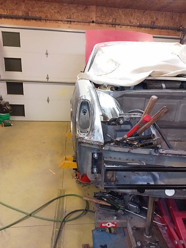

rick 918-S   Time for an update. I really shouldn't have sp...   Sep 13 2015, 08:41 PM
rick 918-S   The car is set up on the Celette. There is a set o...   Sep 13 2015, 09:53 PM
Dave_Darling   Some may say...Eeek! That looks like crap...   Sep 14 2015, 08:52 AM
Johny Blackstain   :popcorn: :thumbsup:   Sep 13 2015, 09:57 PM
rick 918-S   So here is where I'm at today. The rough-in is...   Sep 13 2015, 09:59 PM

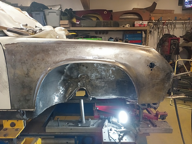

rick 918-S   I've had a few setbacks In the last couple yea...   Oct 30 2017, 02:32 AM
rick 918-S   These are late fenders. Couple small differences t...   Oct 30 2017, 02:41 AM
