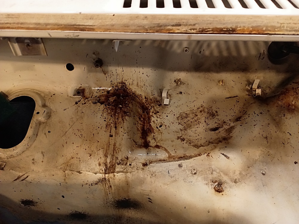

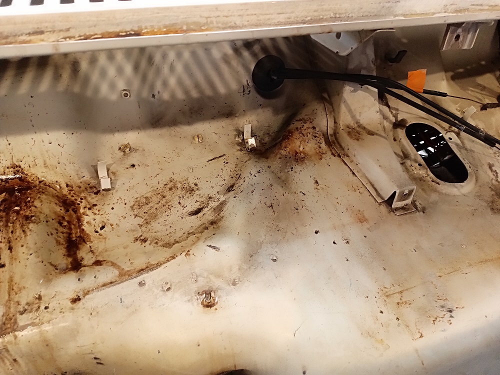

I guess this car was really meant to end up at Area51Werks. I was pulling the stuff out from under the cowl to clean up the dirt and mess and the 4 lbs of grinder metal I could not get even with a blow gun and a shop vac. I removed the left side defroster vent and a bunch of stuff fell out. This was one of the items that was stuck in there.

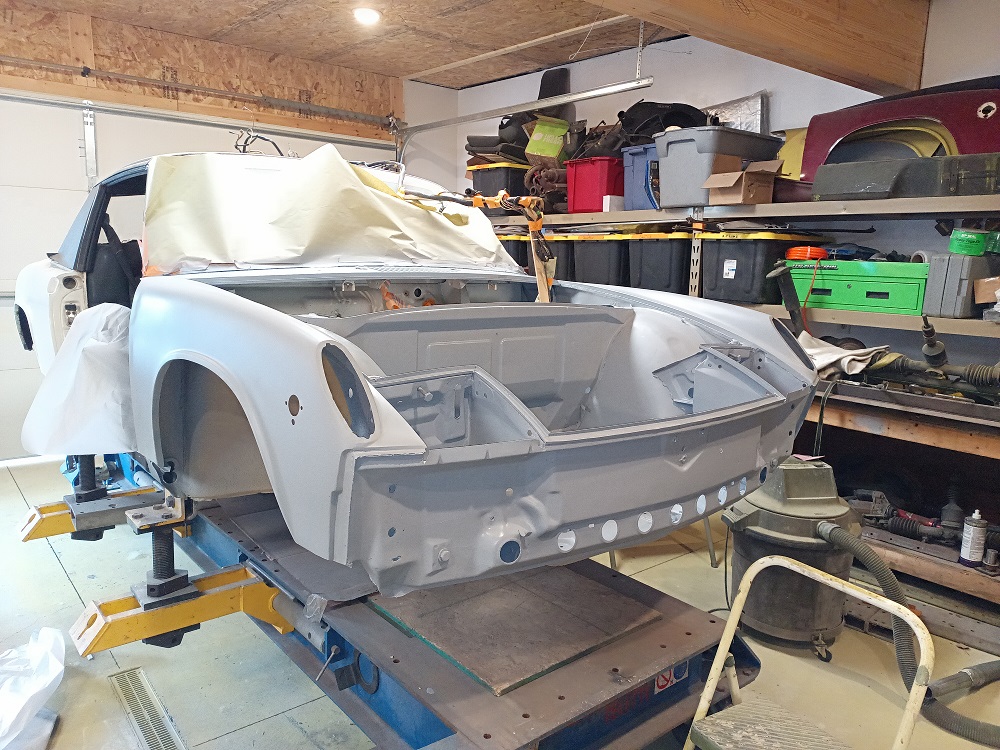

Little clean up under way.

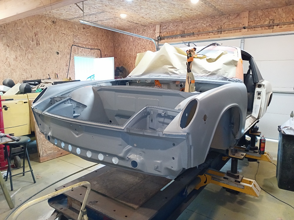

Been a couple weeks since I posted an update. The clip is in primer.

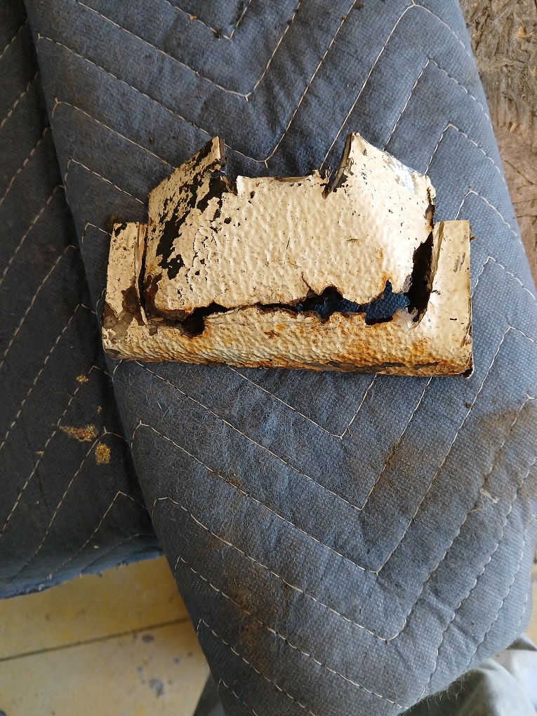

Replace the battery tray and stand. It was removed and the battery was relocated to the frunk.
Repair the right side jack post cover. Looks like the rocker cover trapped dirt up against it causeing the bottom to rust. Pretty minor really.

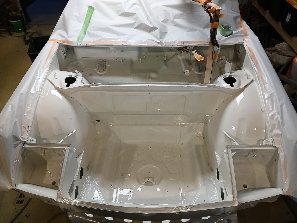

Little Frunk Paint. Maybe Red Rocks?

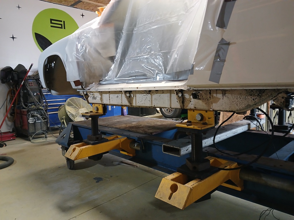

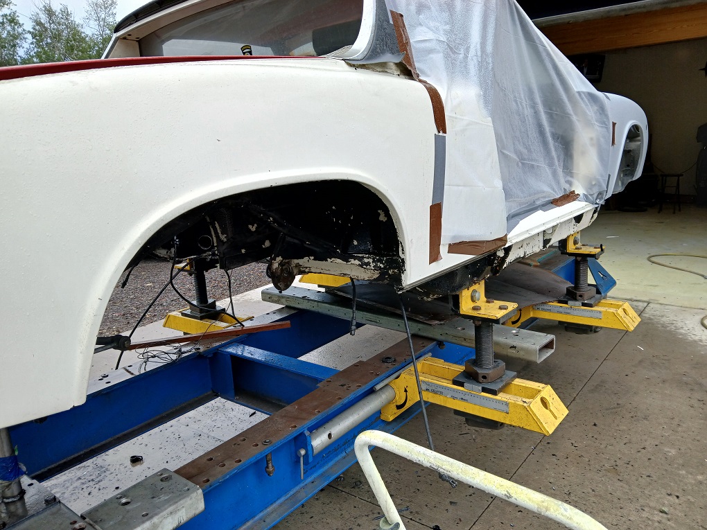

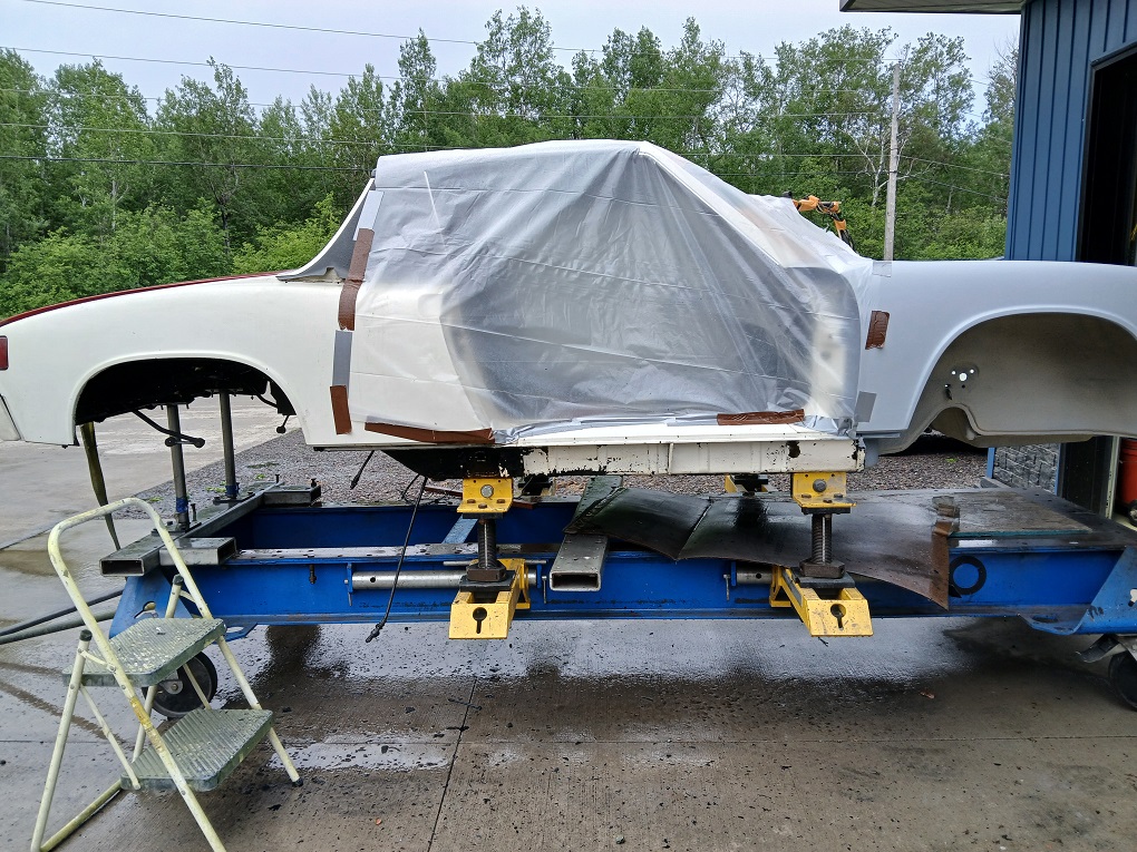

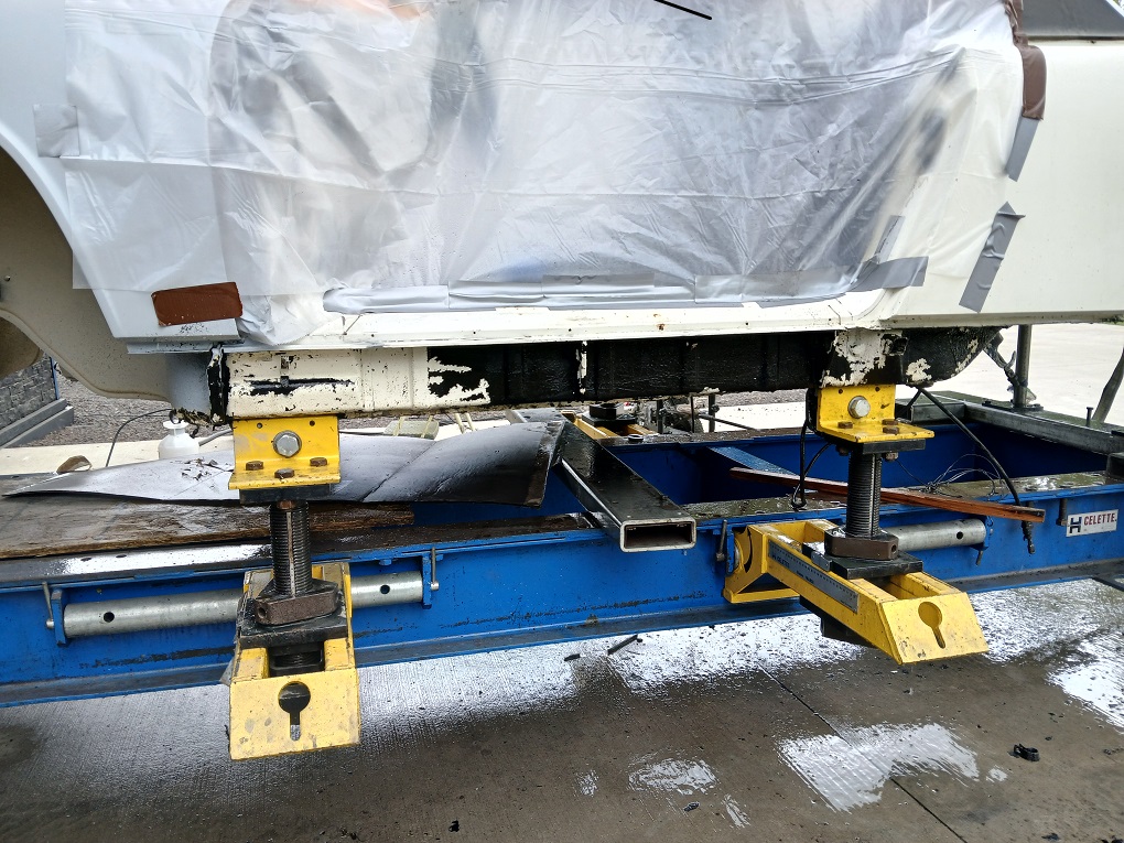

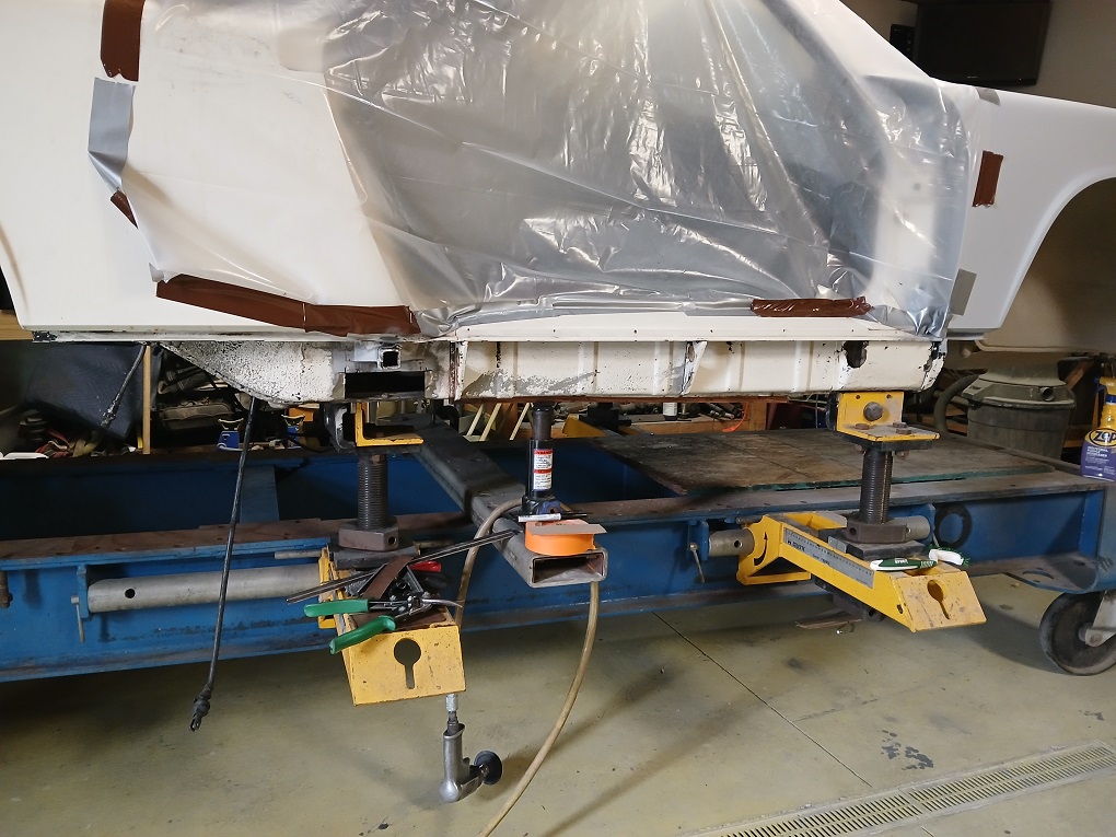

The doors are blocked and ready. I have a pressure washer and it looks like it is going to stop raining tomorrow. I hope to get the bottom and engine bay pressure washed clean tomorrow while it is still on the Celette. I hope to get the suspension back under the car within the next couple weeks.

Dont spray that black crap on the bottom of the car
rick 918-S
post Jul 1 2024, 06:59 AM
Post #260
Hey nice rack! -Celette
Posts: 21,384
From: Now in Superior WI
Member No.: 43

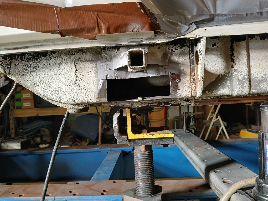

Good progress on the removal of the black bomb can coating. I ended up using spray can paint stripper to soften the coating then used the pressure washer to get it off.
The only rust was on the jack post cover from dirt being packed against it. When I cut it open I discovered a small hole in the long behind the cover. I cut out the rust. The inside of the long is still in light gray primer. This car is very solid!
