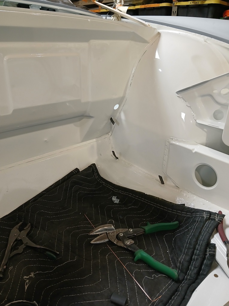

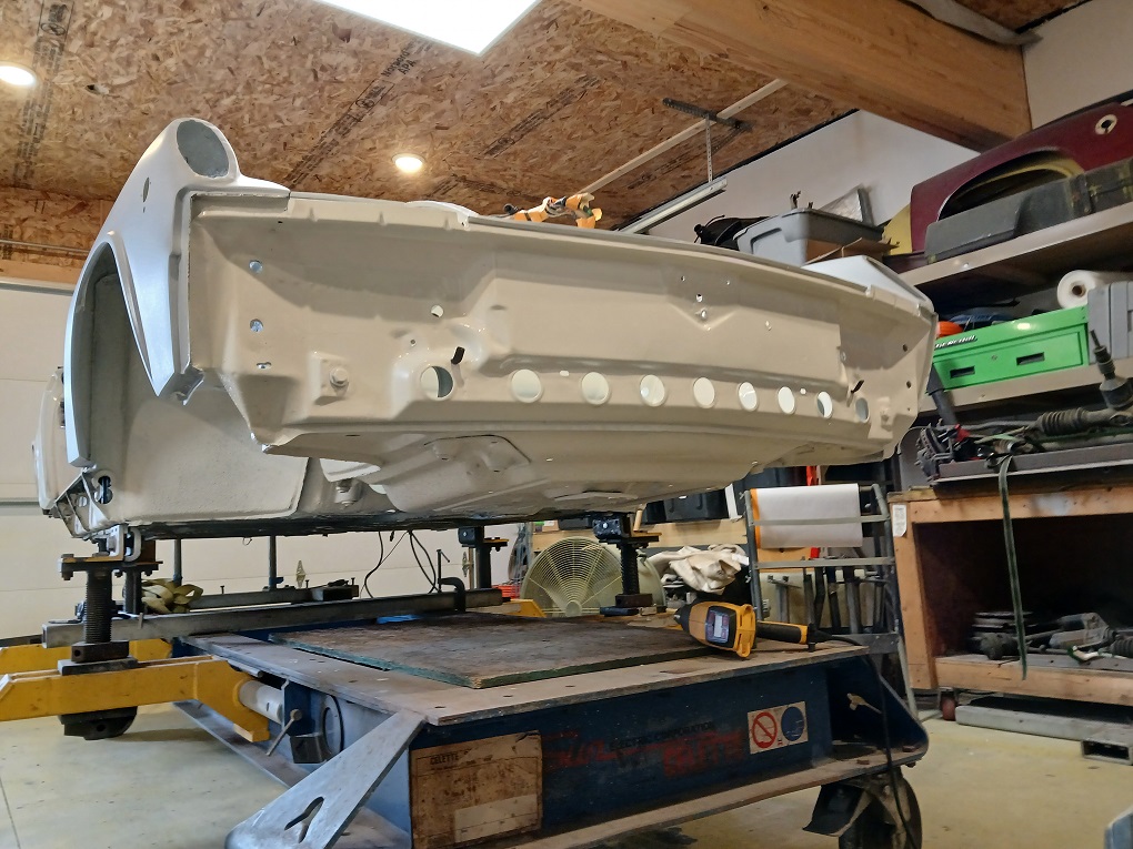

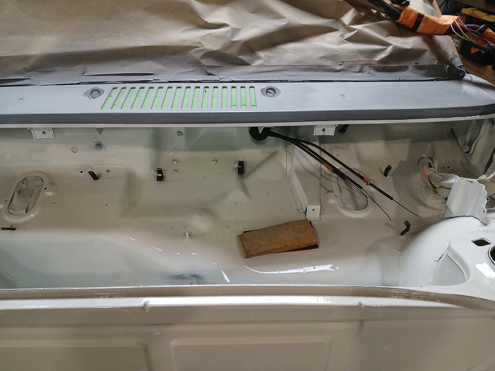

Slow progress but I have enough done in the front to start assembling the Frunk stuff. Sprayed the under side of the front section I replaced. It is very rewarding to get this far.
I had some thick shrink tube so I put it to good use today covering all the wire harness retaining straps. I went thru several bins of stuff getting out the part that need to go back in the frunk and gas tank well. So slow cleaning of parts, waiting on a couple vent tube rubber grommets and a fuel sock to really starting to put stuff back.

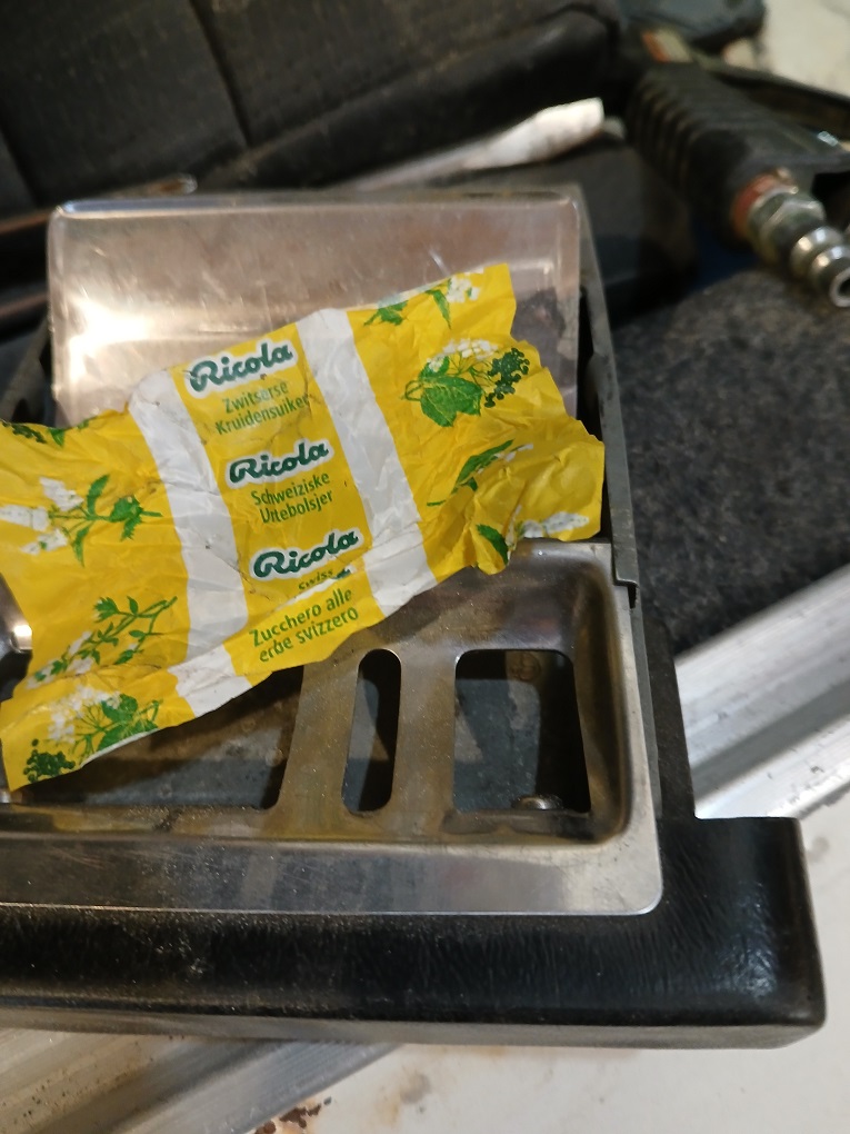

This has to be another sign.... (IMG:style_emoticons/default/assimilate.gif) I was sorting parts to start putting some of the stuff back on the car. I pulled out the ashtray from storage and found a bunch of these wrappers stuffed in there.

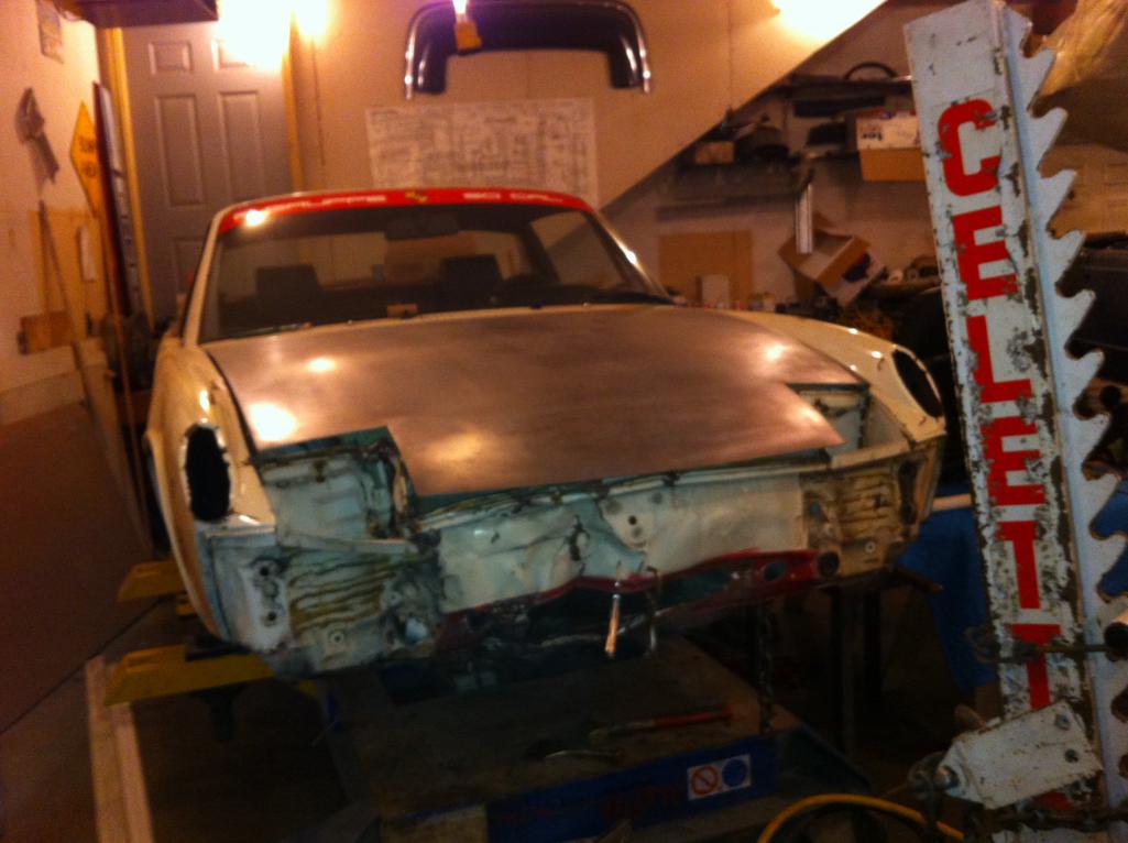

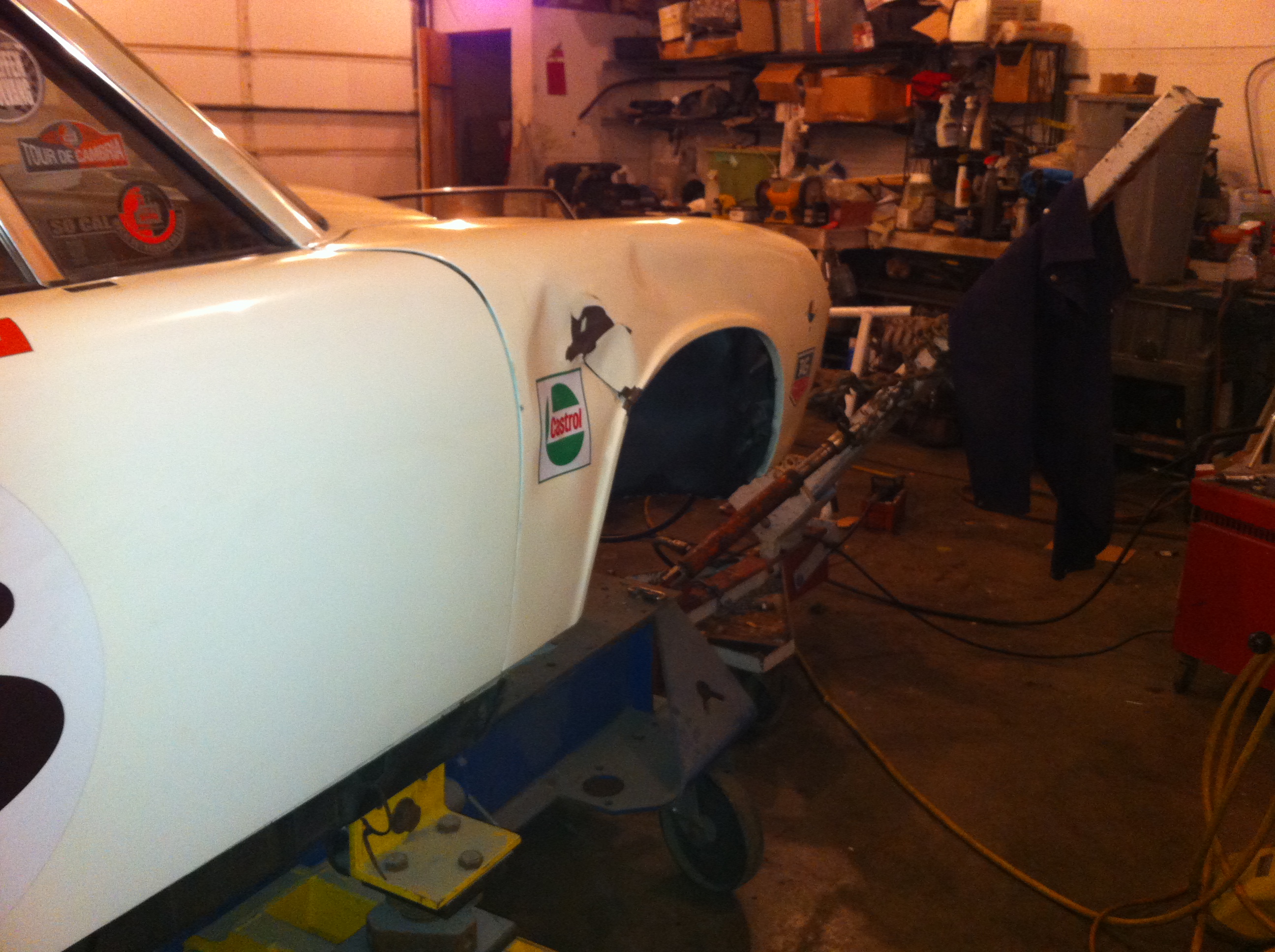

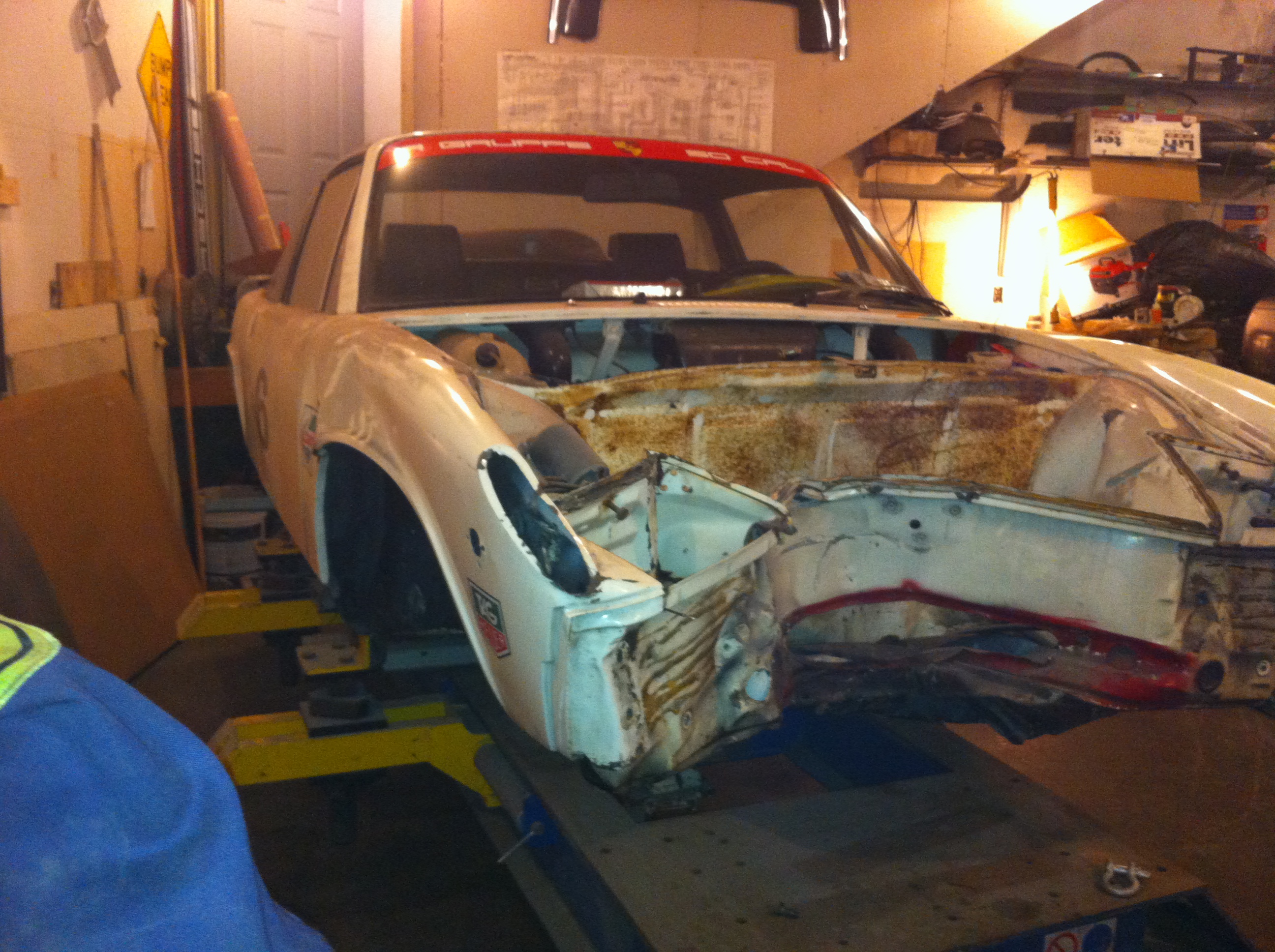

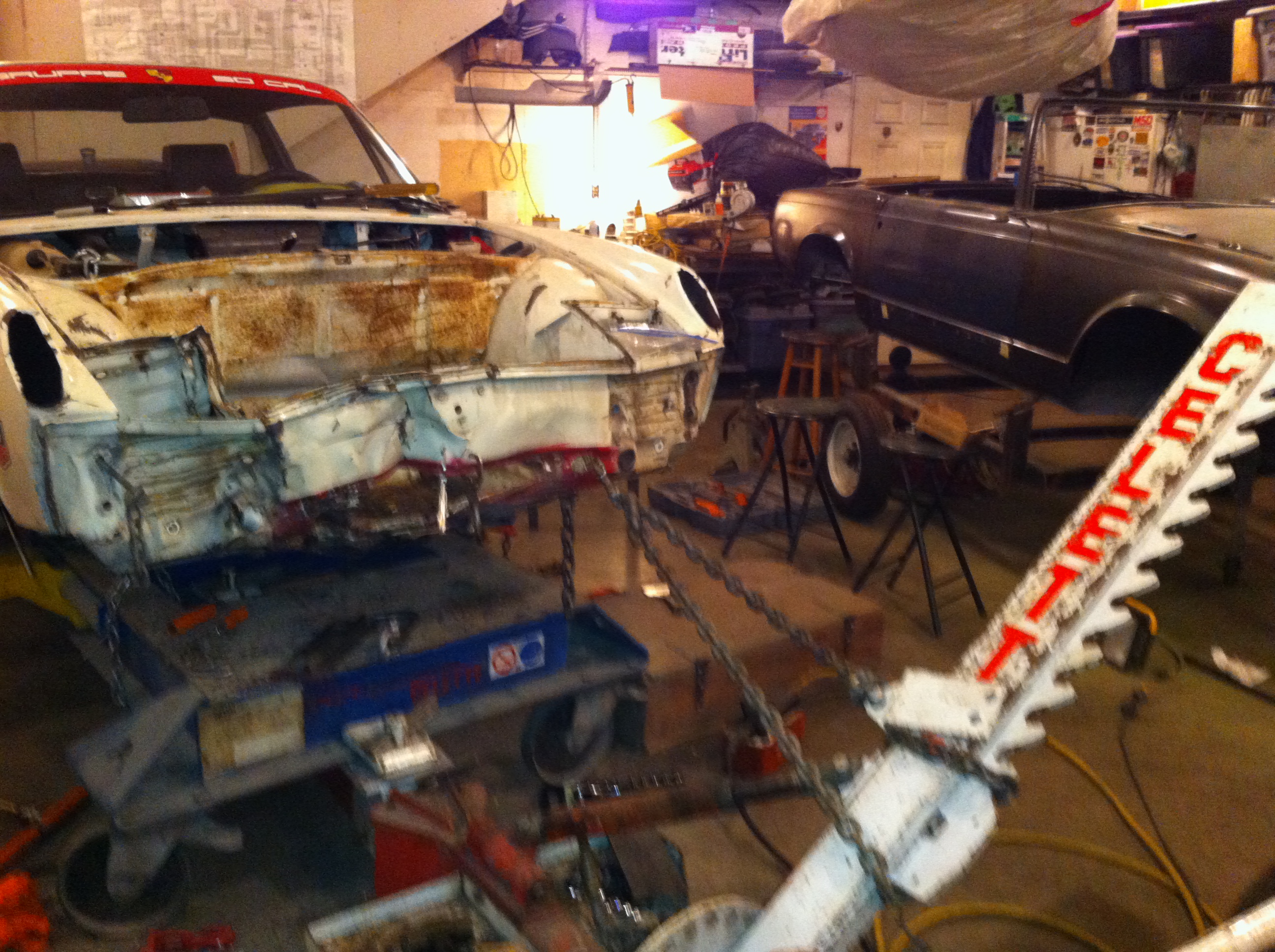

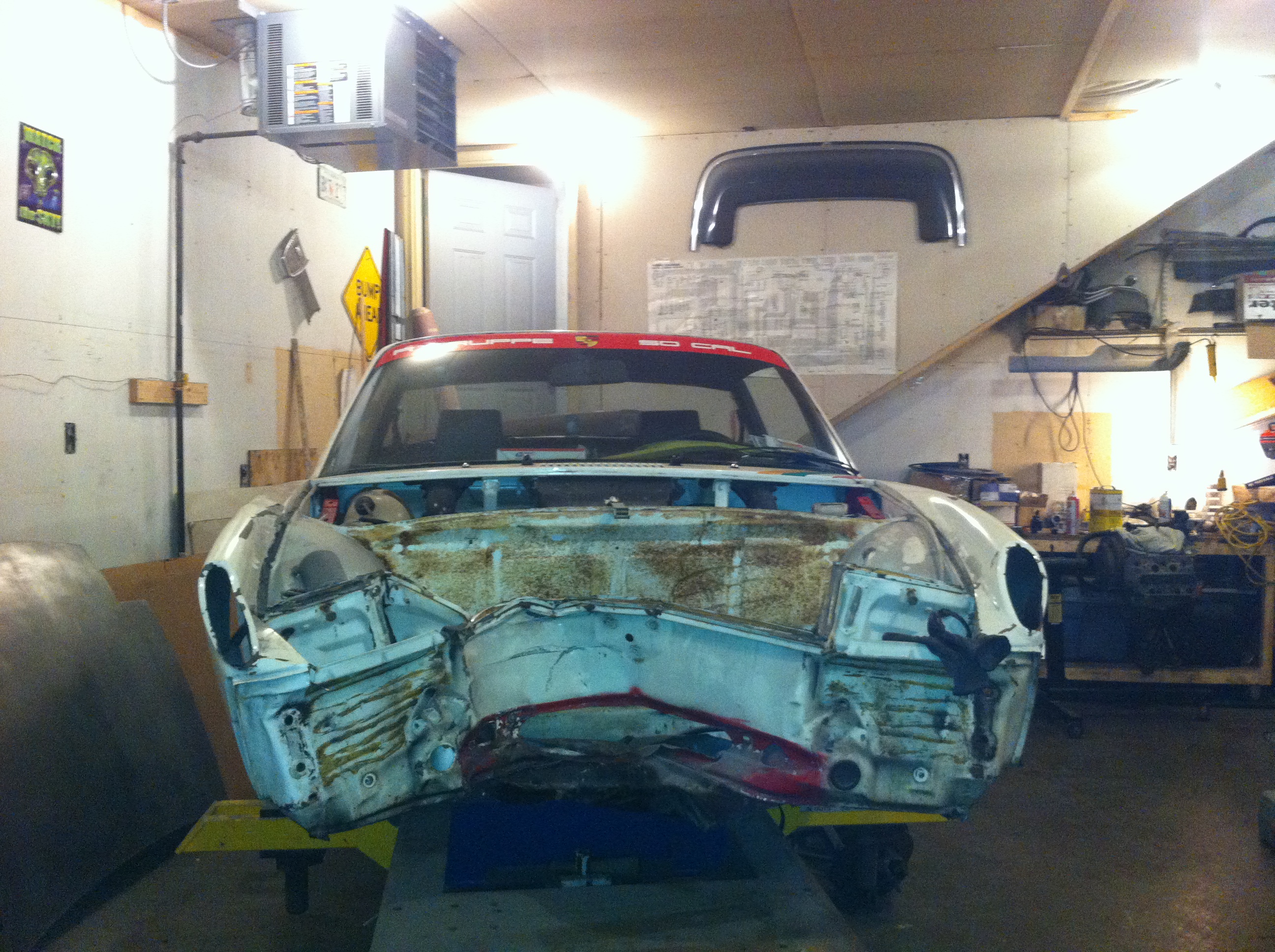

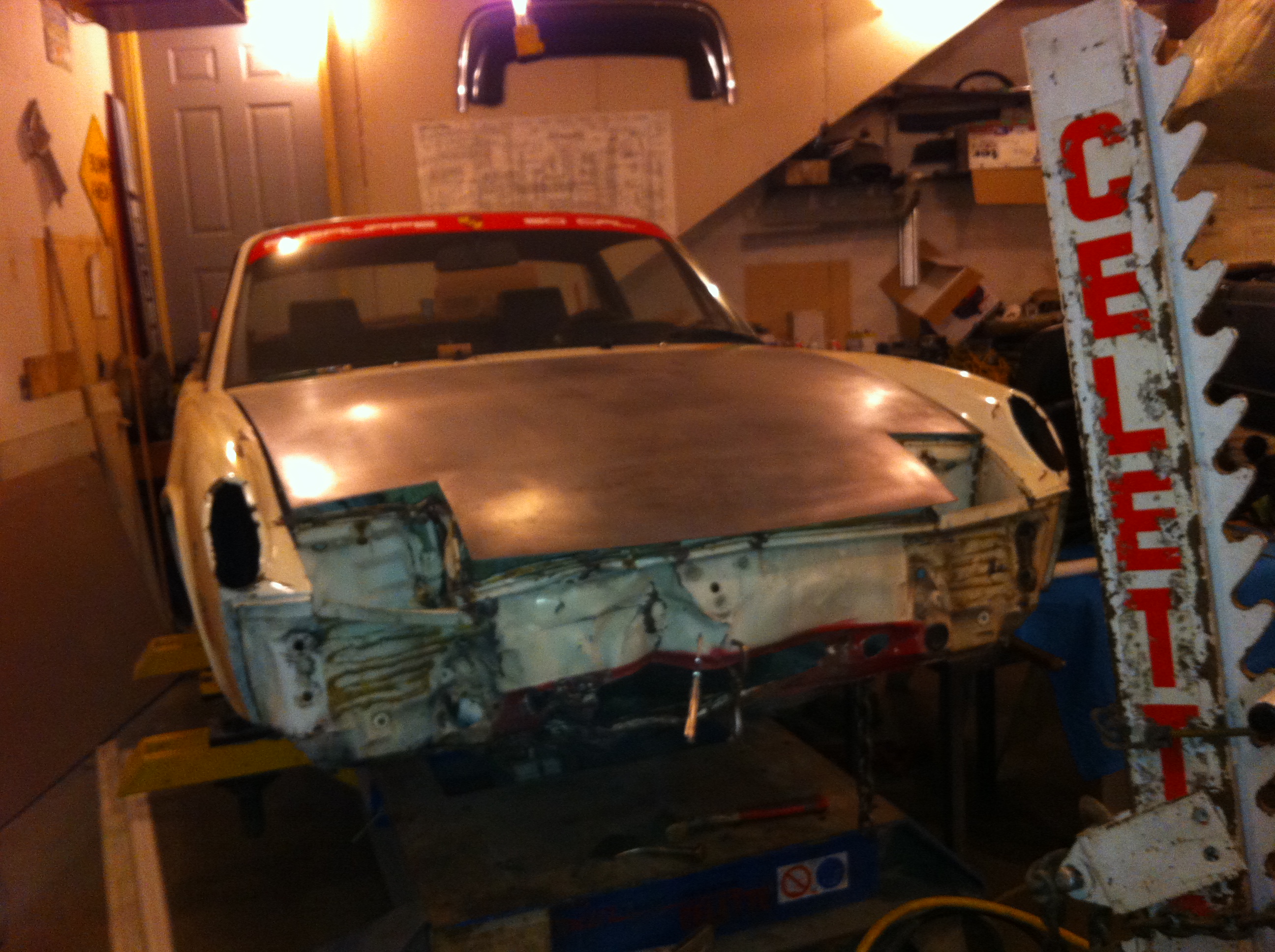

I found a bunch of early photos of the car at the old house. I took some videos while I was doing the rough pulls but I don't know how to post them. Is it possible to post them here? I tried one but It was too large of a file I guess.
Can you believe I repaired those fenders? That slice was in that fender when i picked up the car. I TIG welded it back together.

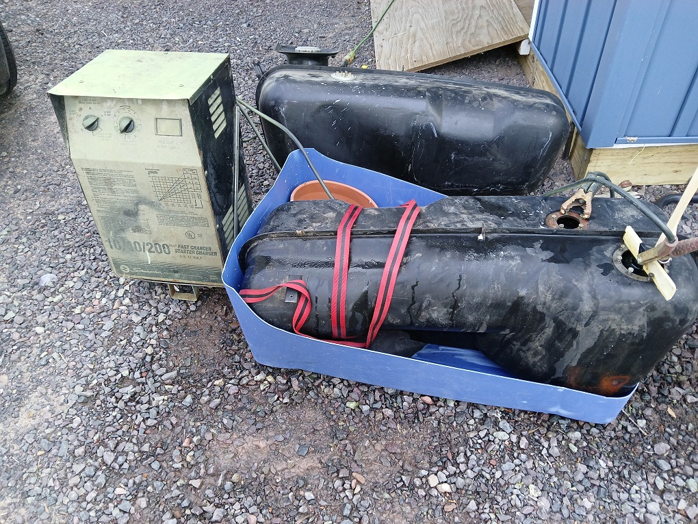

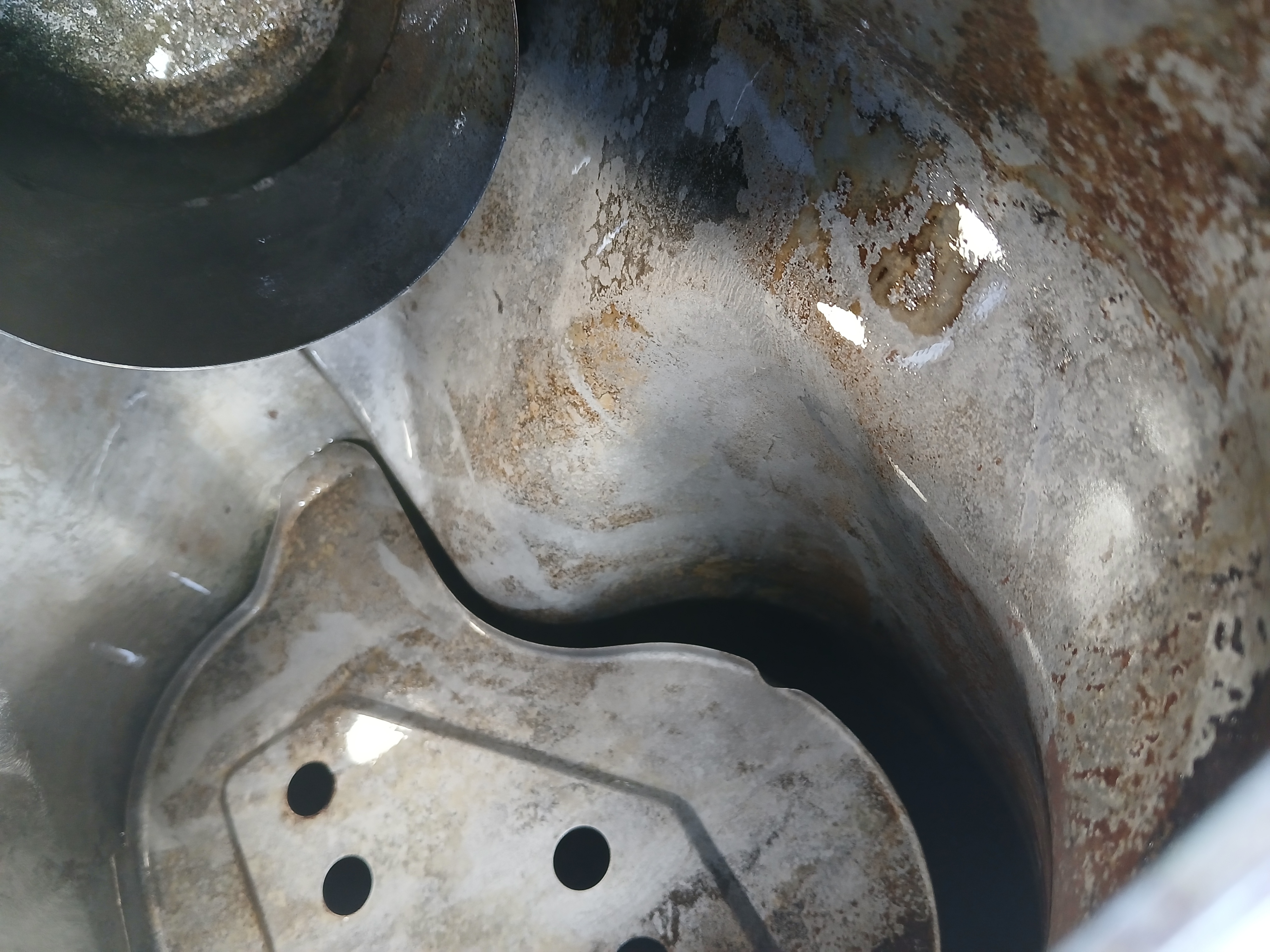

Started cleaning out the gas tank. I did this on 7 of 9 and it worked good.
I just added a second anode in the other hole. I have it outside running over night.
The tank behind the one I am cleaning is the one from the car. There is a large dent in it.

One more round should do it.

QUOTE(rick 918-S @ Jul 14 2024, 03:47 PM) *
We ought to get together on these tanks. I use an old bar b q rotisserie and bolts and chains to clean out the tanks but I feel a need for electrodes connected to Grand Coulee dam.

QUOTE(worn @ Jul 14 2024, 08:15 PM) *
That's kinda ingenious (IMG:style_emoticons/default/idea.gif)
