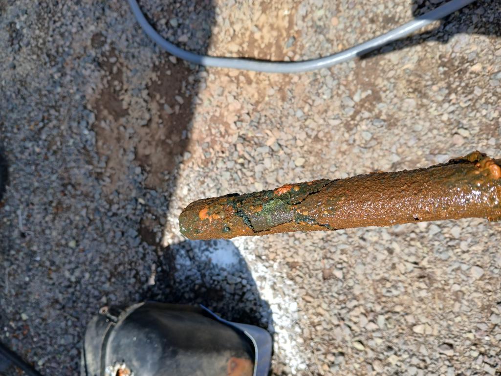

I used two pieces of thin wall steel tubing. The washing soda grass the rust as it pulled off the inside of the tank and attaches to the steel
The photo shows how thick the washing soda crust gets

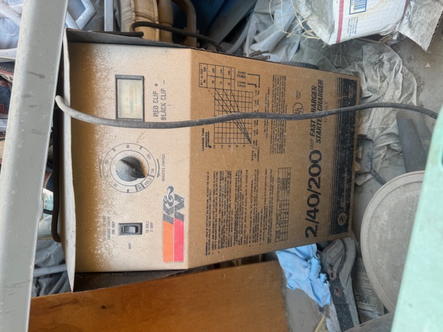

What a good idea. I've never seen another charger like that, except mine. I bought it new in 1986. I was really surprised, then again mine has lasted all these years there had to be more somewhere

QUOTE(Shivers @ Jul 15 2024, 01:05 PM) *
QUOTE(rick 918-S @ Jul 13 2024, 07:38 PM) *
Started cleaning out the gas tank. I did this on 7 of 9 and it worked good.
I just added a second anode in the other hole. I have it outside running over night.
The tank behind the one I am cleaning is the one from the car. There is a large dent in it.
Yes! I have had mine since then also!

QUOTE(rick 918-S @ Jul 15 2024, 04:00 PM) *
We have that same one too from about the same time (before I was born haha). The thing is a tank-way better than all the newer one's I've used for start boosting. (IMG:style_emoticons/default/smile.gif)

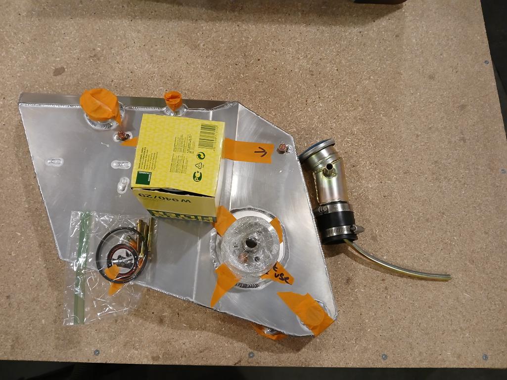

Got a early Christmas present for the 6. Ben does nice work

QUOTE(rick 918-S @ Dec 11 2024, 05:14 PM) *
Hang that sticker with pride. You actually got the last filter console I have. Contemplating making another run. BTW did you find those cis to carb adapters?

Rick, any updates on the project? Will be neat to see the setup hung back in the 914.

Sorry Ben,,,,That SIX deserves an OEM tank..I have several..

QUOTE(sixnotfour @ Dec 19 2024, 07:35 PM) *
I purchased one off ebay a few years ago. I never looked at. Just left it in the box. Turned out to have a giant mouse nest inside and the top was rusted out. I just made a deal on a factory tank yesterday. so the 6 is getting the tank I wanted it to have.
But Ben's tanks are a great option and we are lucky he invests the time to do this.

QUOTE(sixnotfour @ Dec 20 2024, 09:29 AM) *
QUOTE(rick 918-S @ Dec 20 2024, 03:56 AM) *
(IMG:style_emoticons/default/aktion035.gif)
Me and Clay made a swap deal. I wanted a factory tank and he has been wanting a Ben tank for his red car. Worked slick.

QUOTE(rick 918-S @ Dec 20 2024, 05:23 PM) *
I was running the factory tank with the 4.0, and I had to run an adapter to hook up the return line to the tank. With Ben's tank, I can run the correct sized fitting so no adapter. And the six that Rick is restoring really needs a factory tank and accessories. So the trade was a no-brainer.

QUOTE(ClayPerrine @ Dec 21 2024, 09:03 AM) *
Ya that beast you built needed a modern tank with larger filter console. This worked out great. I was kind of excited when you contacted me. (IMG:style_emoticons/default/smile.gif)
Now if I can just get the Alien back up and running so I can get the 6 on it's wheels again... I have two huge builds going at the same time. (IMG:style_emoticons/default/screwy.gif) (IMG:style_emoticons/default/ricola.gif) (IMG:style_emoticons/default/screwy.gif)
