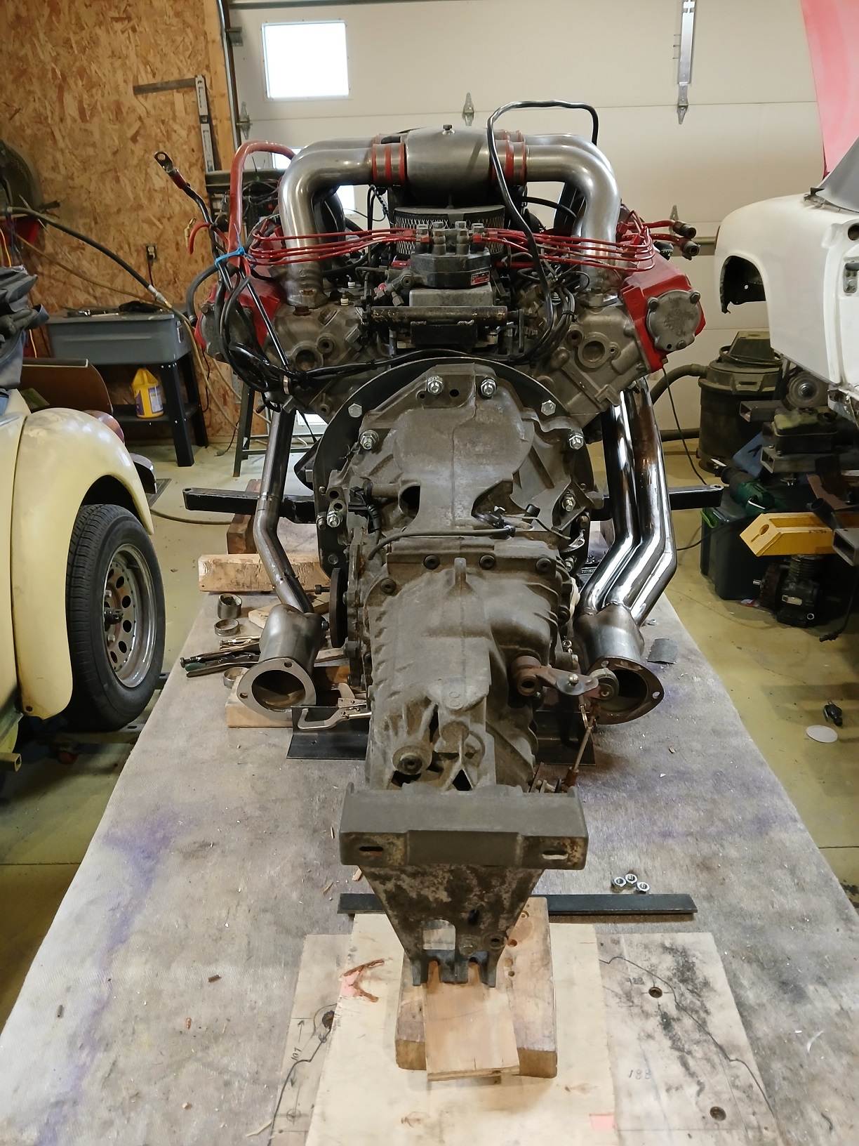

Got my flywheel back and did complete assembly today. Everything work as it should. Next step is to get it back in the car.

I forgot I posted the Alien Engine in the wrong thread.

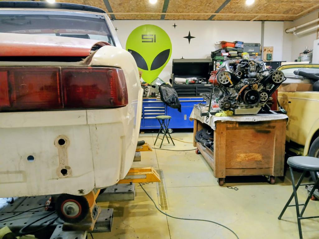

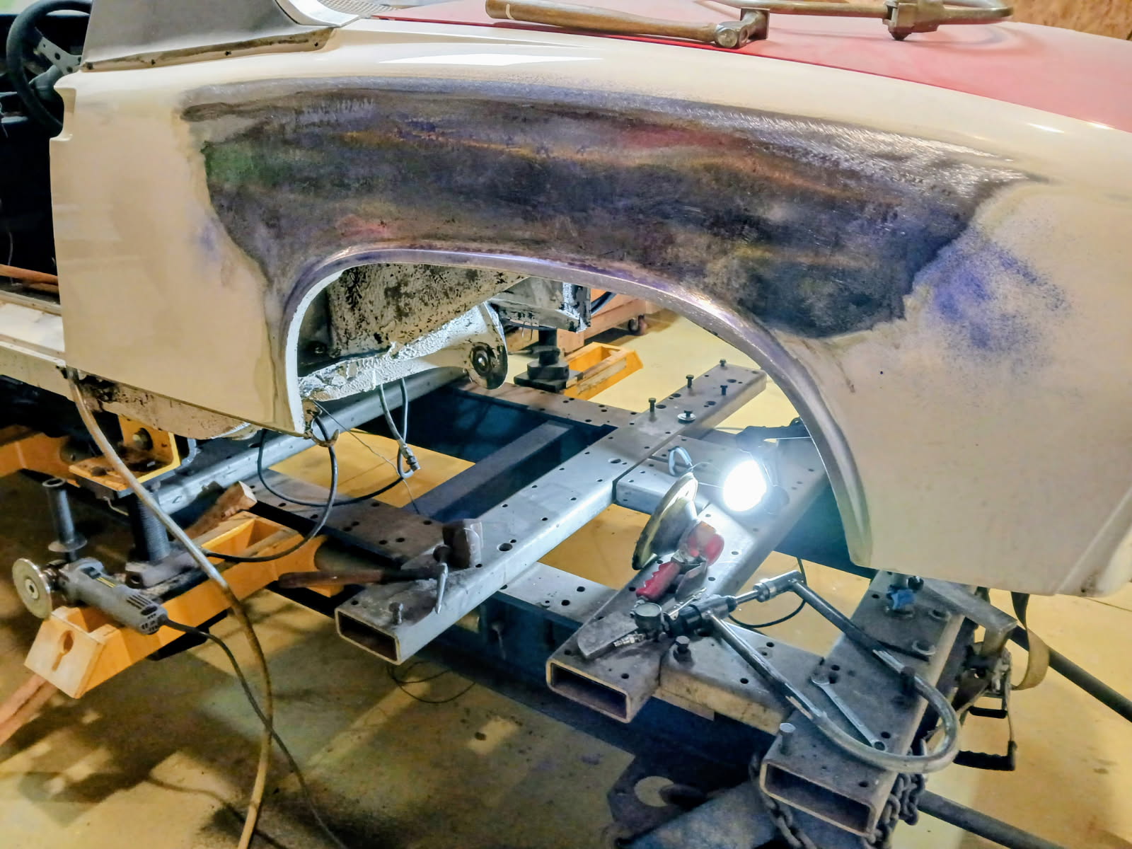

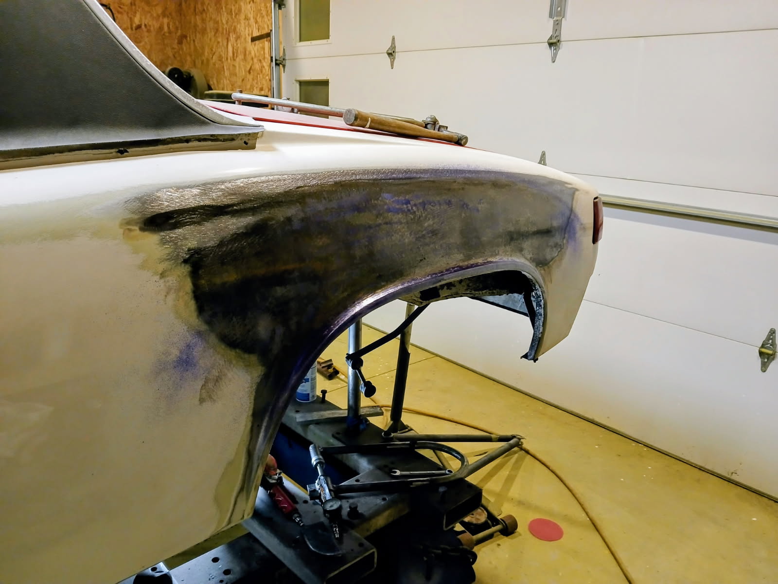

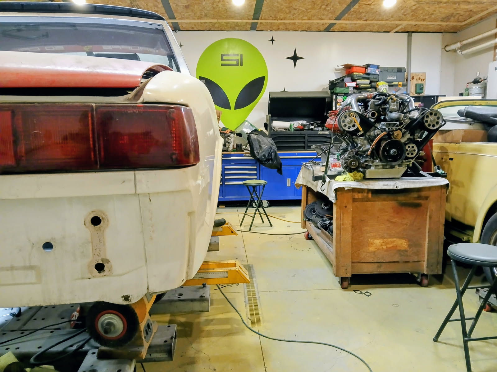

I haven't posted about this car for awhile. I have been working on the Alien. But the work goes on. I have been working to Un-pull the quarters. Lots of time shrinking the panel and reforming the lip.
Not sure if you can see the difference from one side to the other.

You can see the difference in fenders for sure. That must be an exercise in repetitive patience!

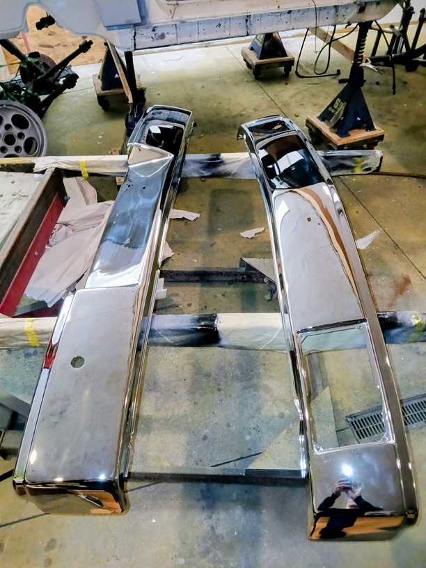

I received my re-chromed bumpers from Bruce Stone. Oscar volunteered to bring them to a local chrome shop but was overwhelmed with life. I do appreciate the effort and I am glad Bruce was able to help. So I am one step closer to getting the 6 back on the road.
Bruce said the cost at this shop will be minimum $850 for front and $750 rear.
Dent and welding may add to the price. The turn around has been two weeks or less. He said he is not looking to be the new bumper king but will help if it does not take too much time and effort on my part.
Cost if he assists will require 50% down and 50% due at completion.
The company is Ultimate Quality Bumper and chrome. They can be found on Facebook, instagram. The website is scarce.

Just a comment, I used Ultimate Quality Bumper and Chrome for my front bumper after the GT modification. The chrome is OK and the bumper looks OK. The first comment I got at a car show was the chrome has a "bluish tinge" to it. In looking at it in the sunlight, I had to agree. Not sure why it turned out like that. I may have it re-chromed at some point.
Juan was easy to deal with and I had no issues with them as far as receiving and returning the bumper. It returned packaged like it could go around the world and have no damage at all. (IMG:style_emoticons/default/beerchug.gif)

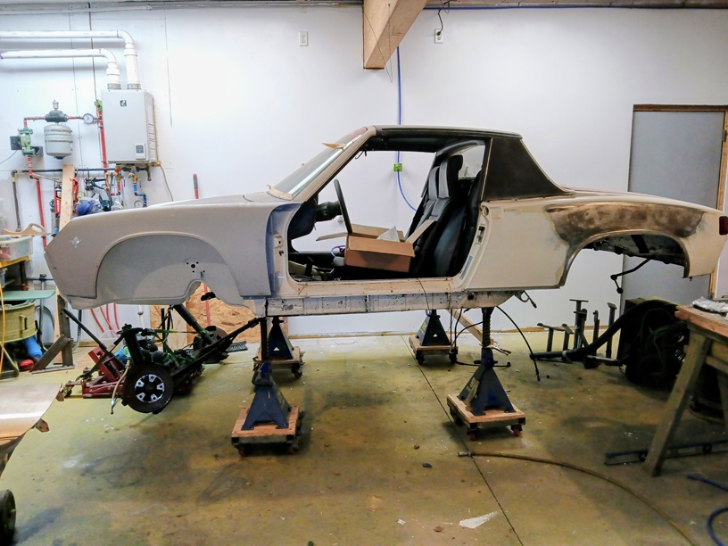

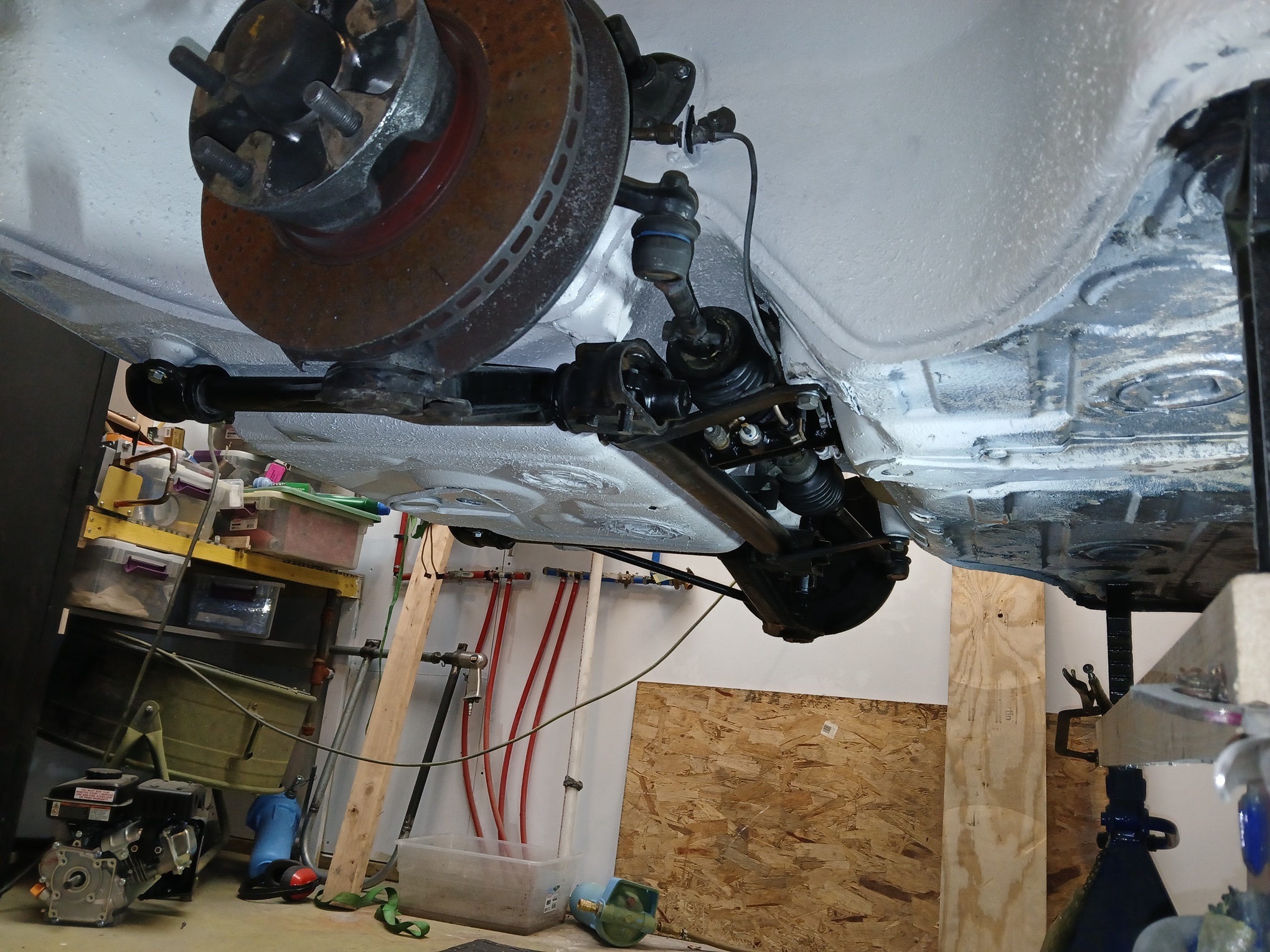

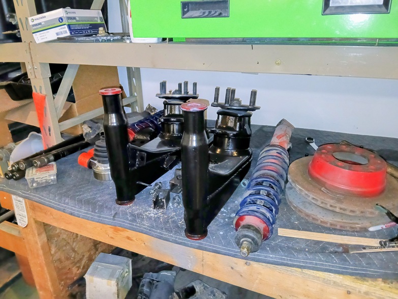

I have the 6 off the Celette and the rear suspension cleaned up ready to install. I have the axles and CV's ready to reassemble. I need to replace the front Arm Bushings yet. They were damaged in the accident.
[/quote]
So did they correct the problem? I have heard that will happen if they don't add copper plating under the chrome. I have seen 4 bumpers they have done and not seen any blue hue.

I did not. I have been swamped for about 3 years on something and figured that was the way they did chrome. I am almost at the end of that long project, so maybe I will reach out to Juan and see what he can do. Thanks for the suggestion Bruce. (IMG:style_emoticons/default/beerchug.gif)

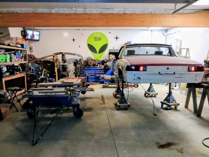

Rick,

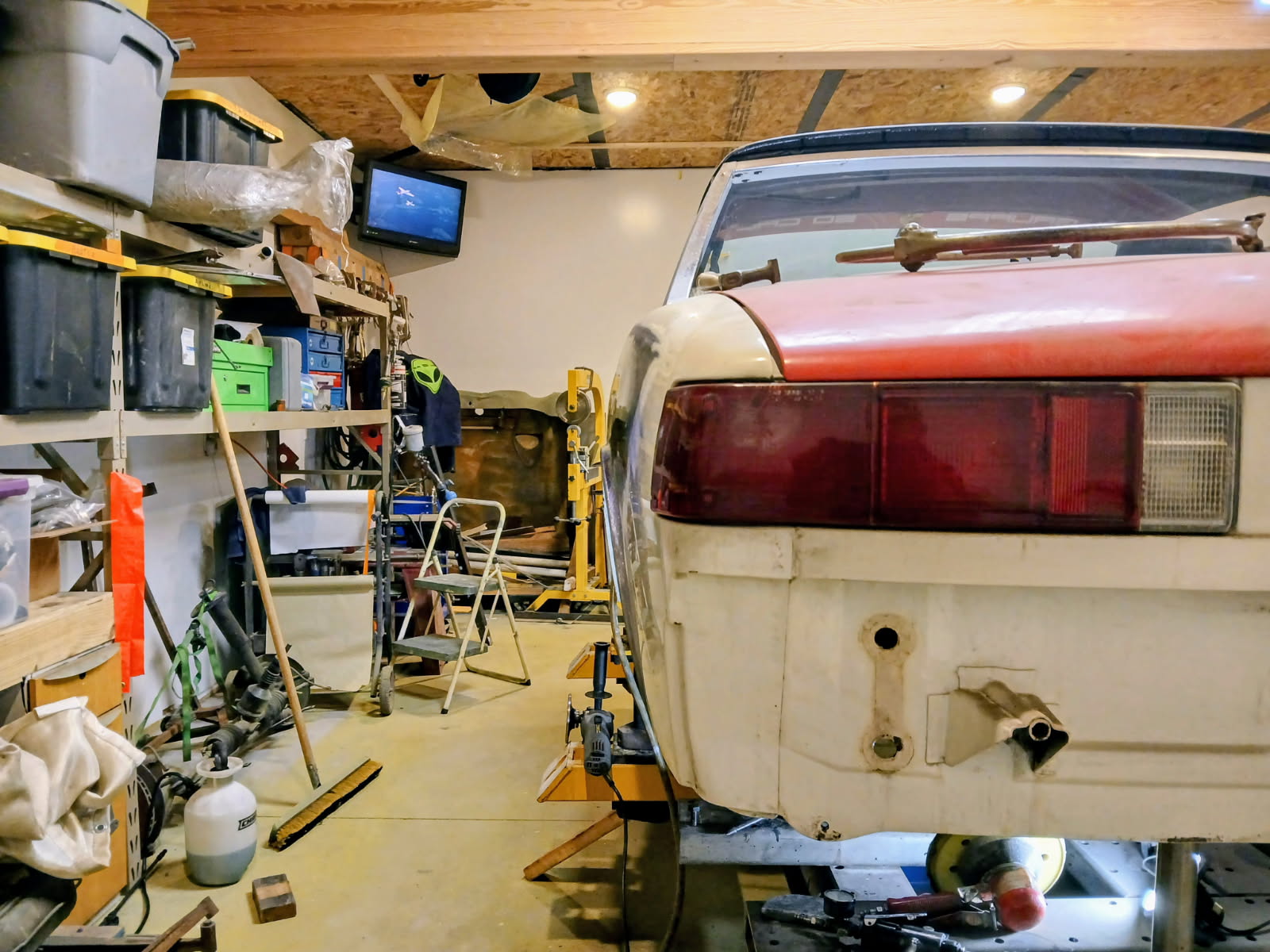

Do you get nervous moving the car on jackstands on the rolling furniture dollies?
rick 918-S
post Nov 20 2025, 09:06 AM
Post #314
Hey nice rack! -Celette
Posts: 21,356
From: Now in Superior WI
Member No.: 43
QUOTE(rudedude @ Nov 20 2025, 09:00 AM) *
Rick,
Yes! It was vey Scary! The stands are bolted to the bases. I ended up clamping braces to the jack stands to keep them from twisting. I only moved the car against the wall. Once the suspension is on the car can hit the floor.

I was thinking the same thing, don't breath in the wrong direction, yikes!

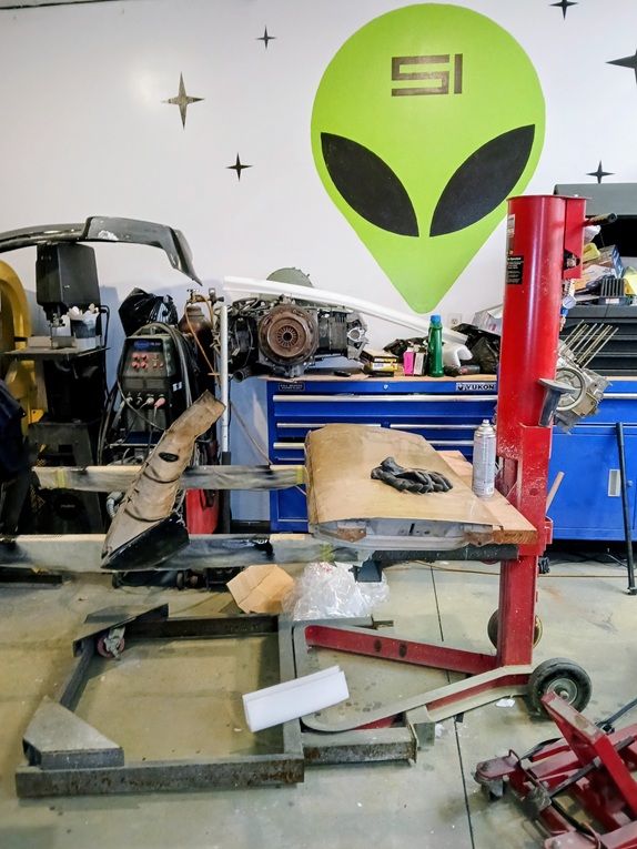

I don't have the height or the space in my shop for a lift. I made this from a 2500lb air jack. It worked to get Jueren's car up on the Celette. It was a bare shell. When I did my 6 it barely lifted it and I was afraid it would topple over. When I took it off the Celette I pulled the doors & lids. I should have used a 4500lb jack.
They make a side lift like this but I don't have the space to store it. This one works but I have a redesign in mind to make it safer.

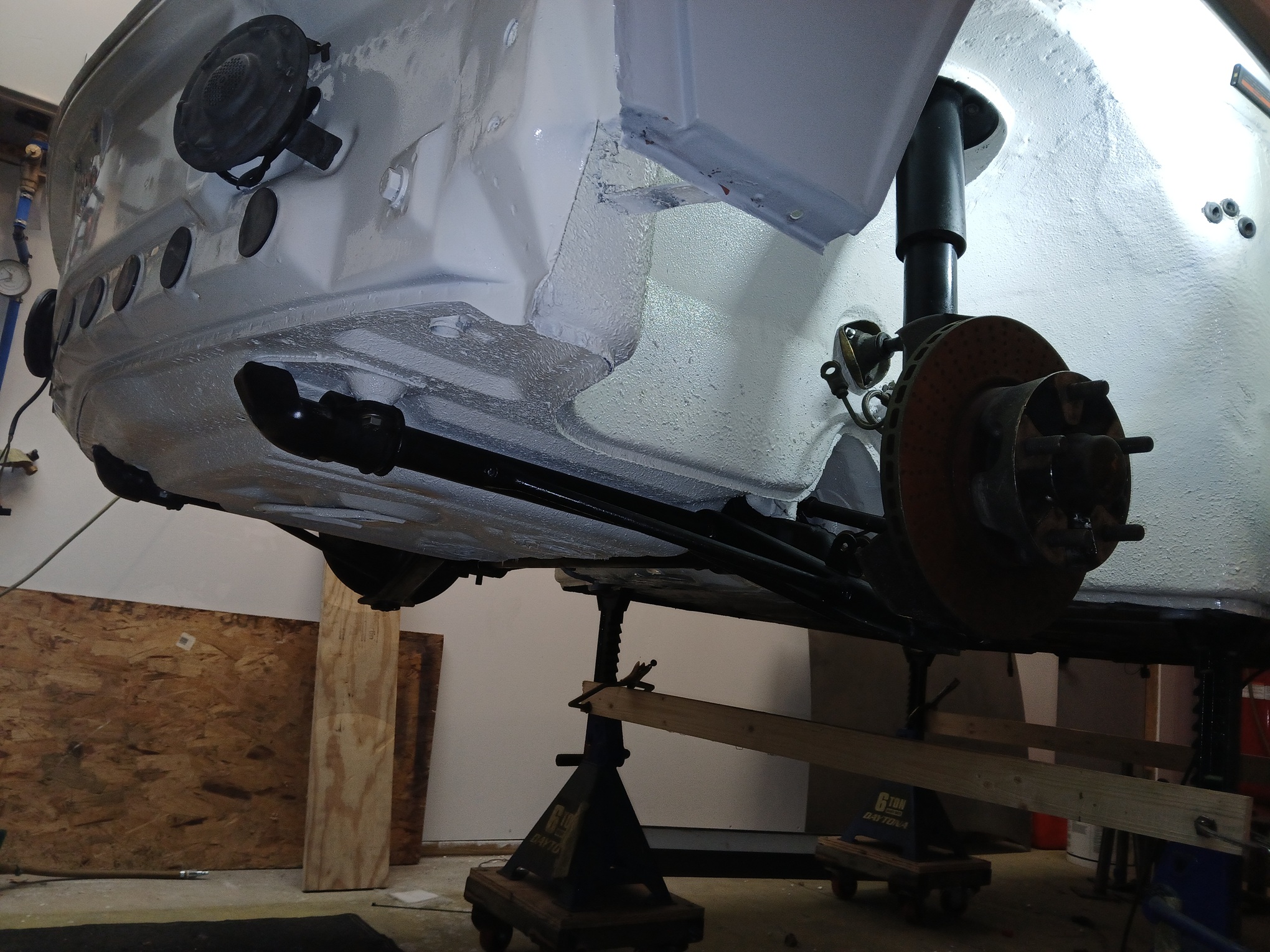

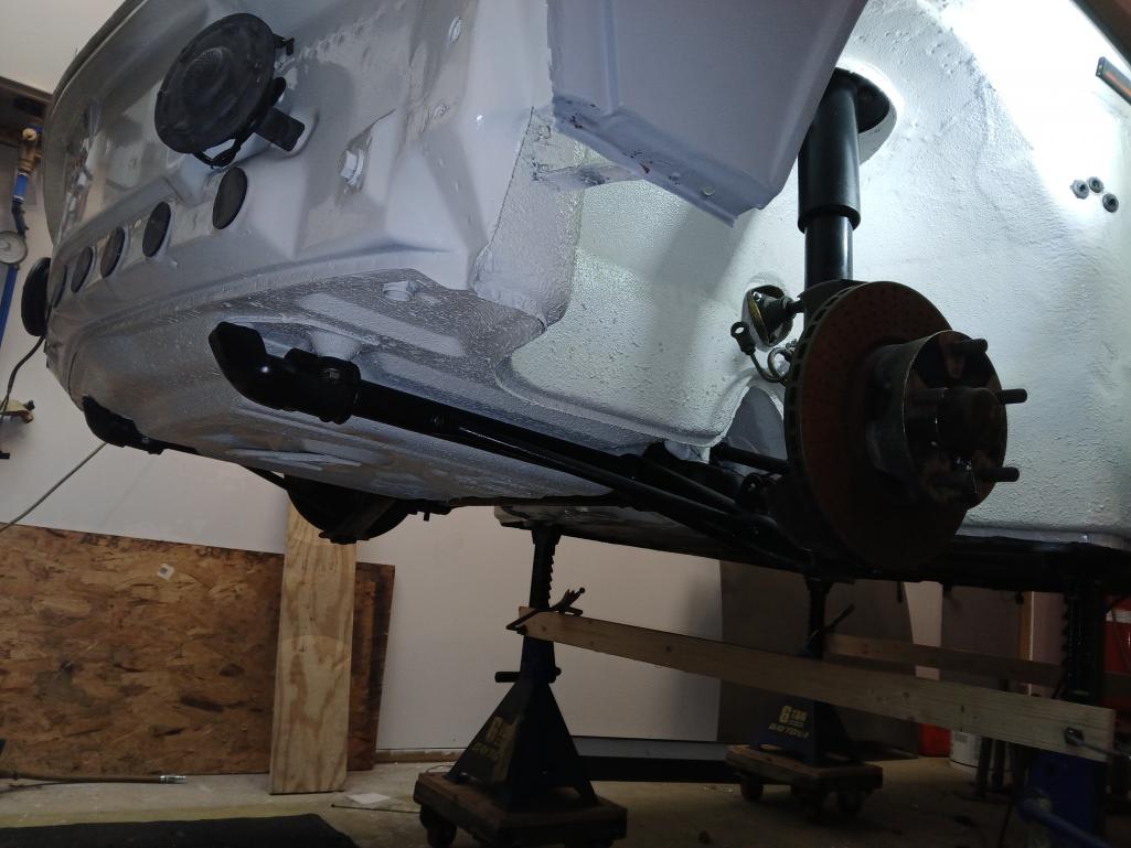

I haven't posted an update for a while. The front suspension is all in with the exception of the calipers and some details. New tie rod ends installed. I have to install the anti-sway bar links yet.
rick 918-S
