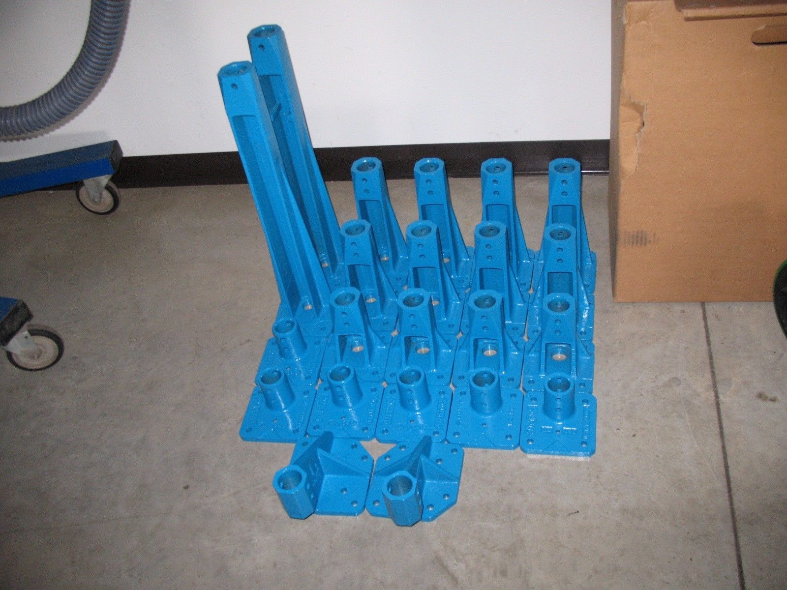

These are the towers for the newer models. They are generic for many models, you own them, then rent the top and bottom portions from Celette for your specific application. The red parts in the next pic are what you rent. Last pic is the actual 914 parts for the older benched like Ricks and one I'm looking at. I'm also pricing out to build one from scratch and so far, when I calculate my time, the materials, and the possibility of surface grinding the whole table, + the plates welded onto it, it makes the cost of a used or even new Celette look pretty reasonable (IMG:style_emoticons/default/sad.gif) You want to know anything about Celette's just ask....I've got more pics then you can shake a stick at. Rick and I have been going over this issue for quite a while now (IMG:style_emoticons/default/dry.gif)

Thanks for posting that Scotty. Yes, I just contacted Celette again today. Jenny verified the original fixtures you see there in red were shipped back to France. She double checked. So they were not sold off to a shop here in the US. She is going to price out the bare bones tower set and send me an email with pricing. The set you see in blue covers a range of many vehicles.

I have a swiss made car o liner that is very similar to the celette..
I have 3 towers and hydraulics 2 benches and a ton of fixtures and a Unik lifter..all for under 3k.. If your going to make fixtures the celette is not necessary...I found both of mine 2 separate deals on craigs list...
The old celette fixture where hella stout..the new ones more for checking
There is also a blackhawk bench that is similar and a few 911 fixture for it..
Unless you want to buy new..then cellette

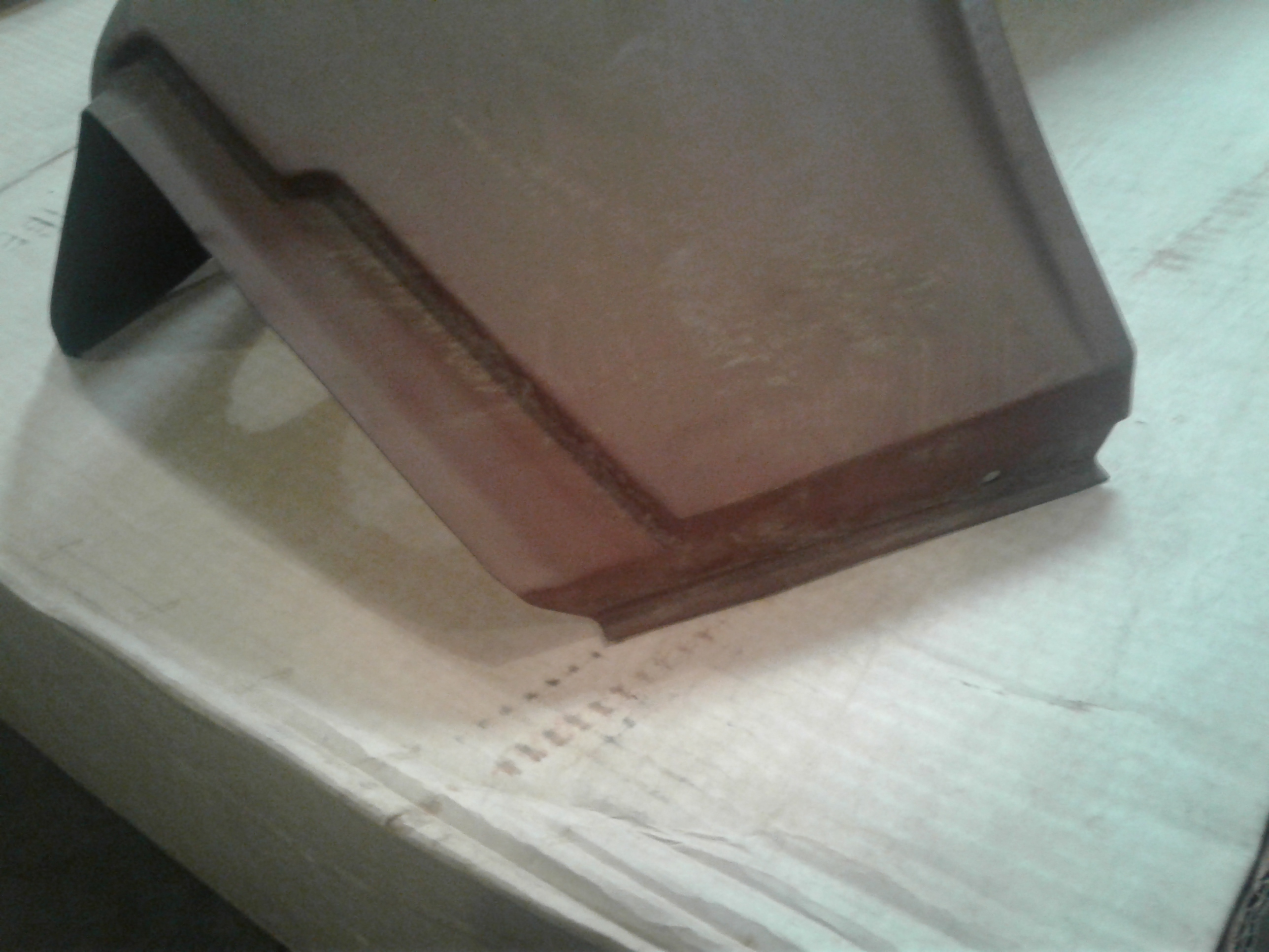

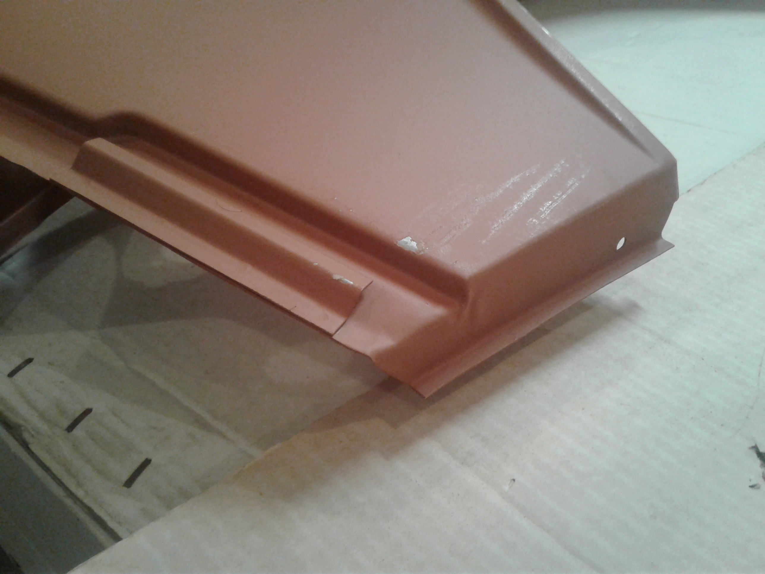

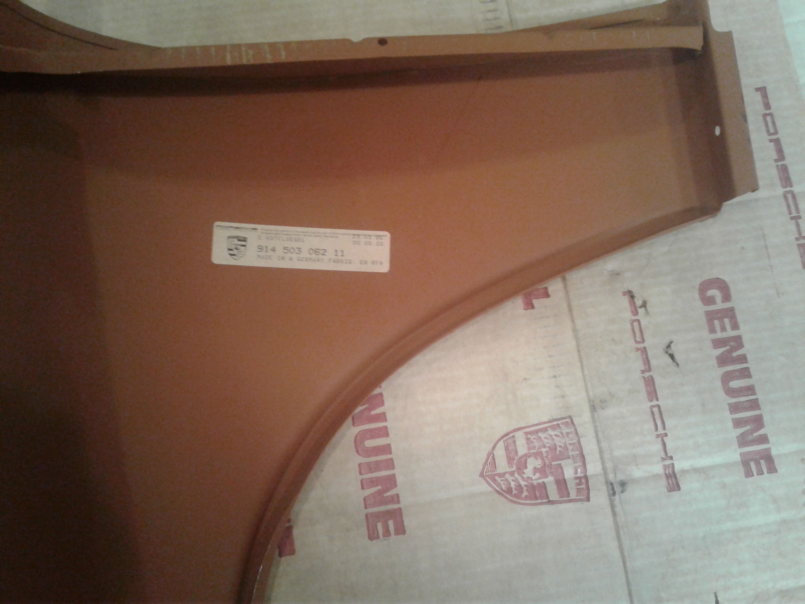

I wanted to include a special thank you to Glenn Stazak. He helped me score a set on NOS front fenders! Wooo hoo!
I now have a left side NOS Euro fender which I will be using on Juergen's car and a set of NOS fenders for my 6. There are still in the factory boxes!

These are late fenders. Couple small differences that are easily erased to make these early style.
There are brackets for the late bumpers and hole for the valence I think.
