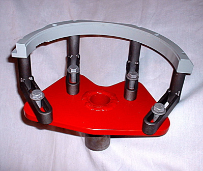

I got one off Ebay that uses a V8 stand as it base, very nice will hold an /6 but it wil also hold a four very well. The VW 2 arm stands can break the case around the upper bolt hole if you are not careful. don't ask (IMG:http://www.914world.com/bbs2/html/emoticons/mad.gif)
So the bucks you save are nothing once you bust a case. I think the guy also advertises in Excellence. Very nice and easy to work with. Here is a link to their site! Attached image(s) ![]() |
