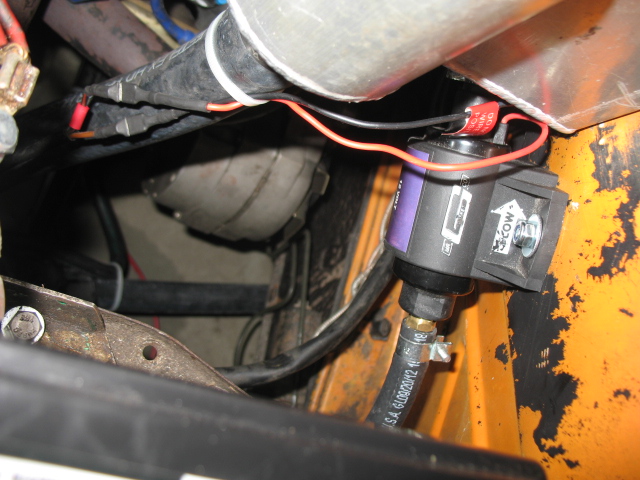

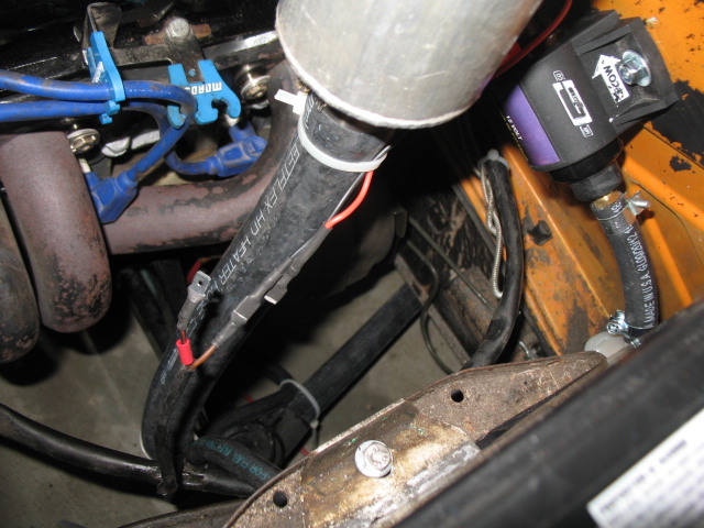

yes - fuel pump connected to stock harness, like it had been before.
and it gets power from key. but also gets power from hazard switch when pulled.

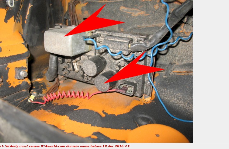

pic shows + disconnected.
the reason I ask is because the + black/red wire goes to relay board (pin 13, I think). but I assume the hazard switch sends power thru the relay board too?

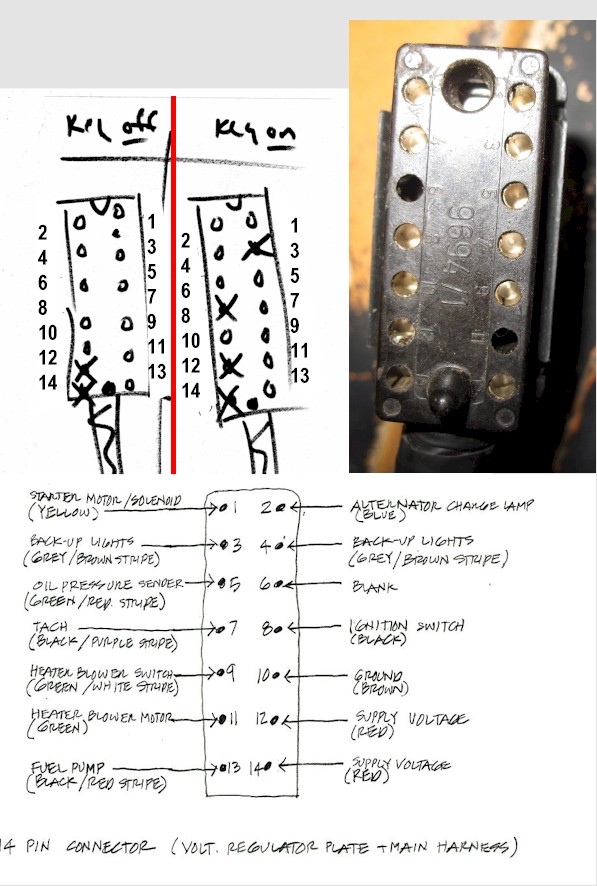

seems my 14 pin plug has power at 12 and 14 pins with key off.
with ignition key turned, 12, 14, and 8 and 3, have power.
I was expecting one pin to flash with the hazards but none did. but I guess without plug connected to relay panel, that was an ill conceived expectation.
pins 11 and 6 are empty.
its got to be how I wired my fuse box???

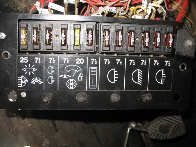

there is a black/red wire at the fuse box but it does not seem to lead to the harness. it comes out of the silver relay and goes to the 20 amp fuse with a red wire, but only red wires are on the other side of the fuse??
to me, it could simply be a coincidence that this wire at the fuse panel happens to be black/red?
if the ecu turns the fuel pump on, then maybe there is no wire to trace, other than the one from pump to relay board?
note: my fuse box did get a little burnt from the recent short/fire, but I think it is ok?

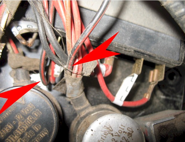

nope - pump did not work with coiled wire (which acts as ground) disconnected from relay board.
though if I leave this wire connected, but run positive wire from fuel pump directly to battery positive, it runs fine.
so the ground thru the relay board is not the problem, the fuel pump harness positive seems to be the problem.
though I did try to get positive from my fuel pump from this spade (pic below) and ground to body, and same problem.
seems to me that these 4 spades on the relay board for fuel injection harness has an issue?

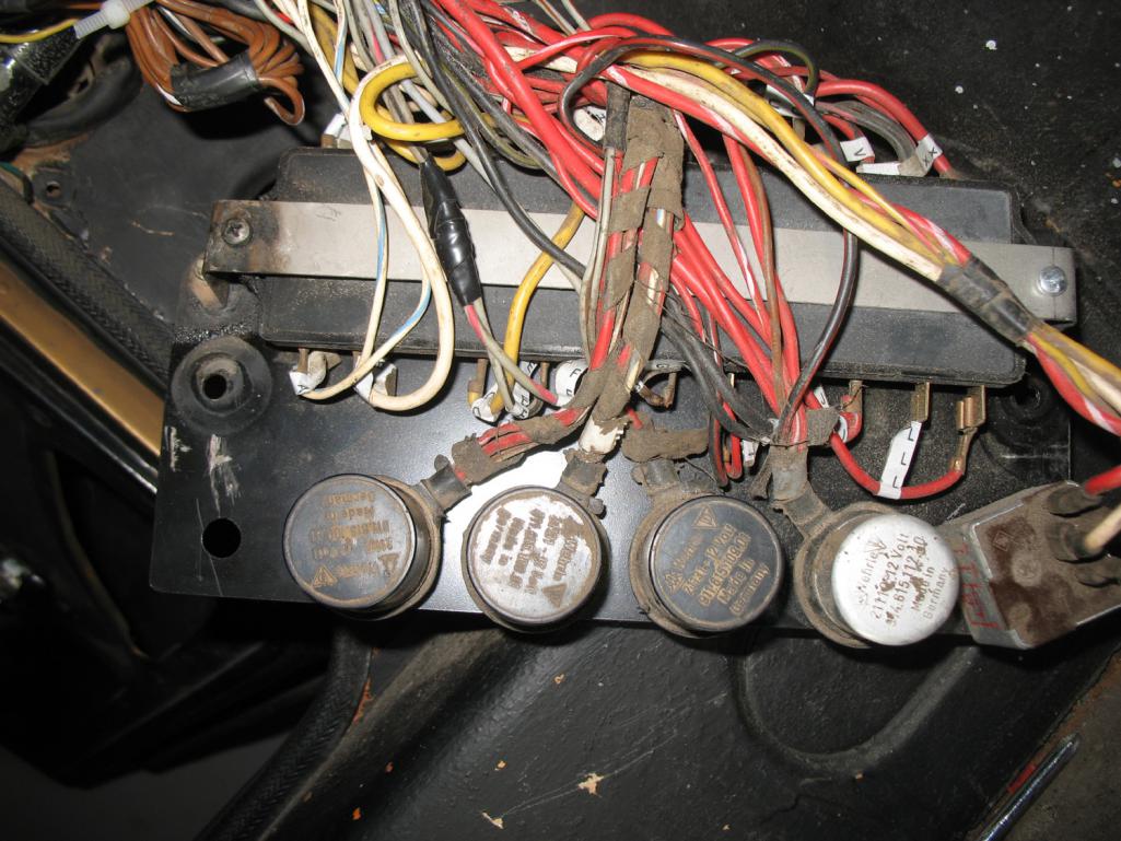

Relays starting from the rear of the car:
1) Heater fan relay that goes on top of the motor: You don't need this one.
2) Fuel pump relay: you need this.
3) Power supply relay: you need this. It provides power to the fuel pump relay coil.
4) Rear window defogger relay: If you don't have the rear defogger, you don't need this.
The fog light relay is in the front of the car.

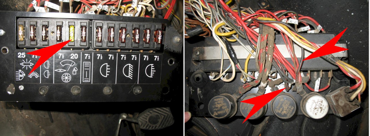

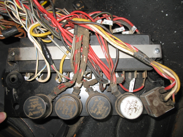

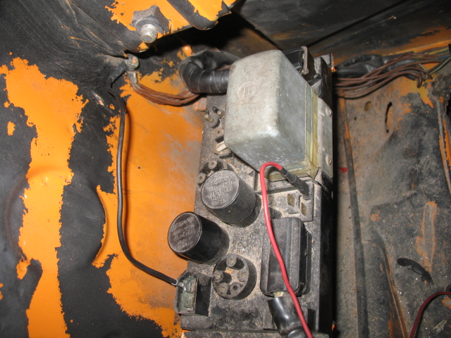

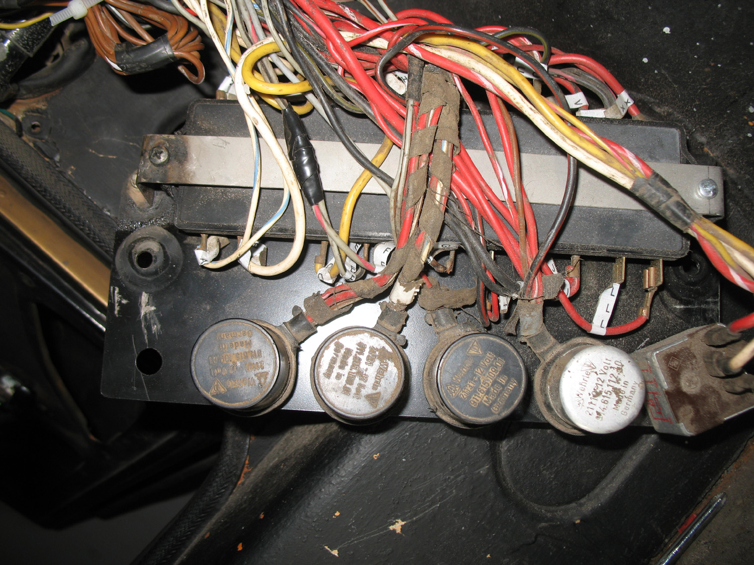

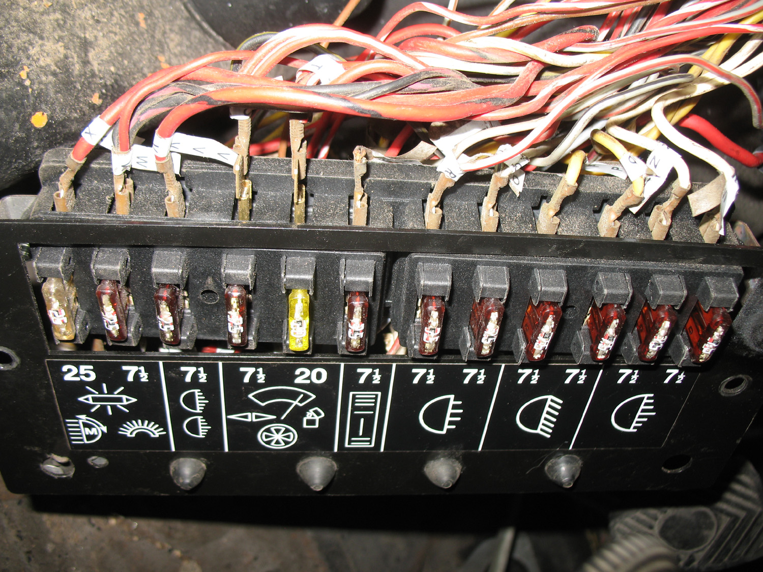

>> 2 FRESH PICS <<
