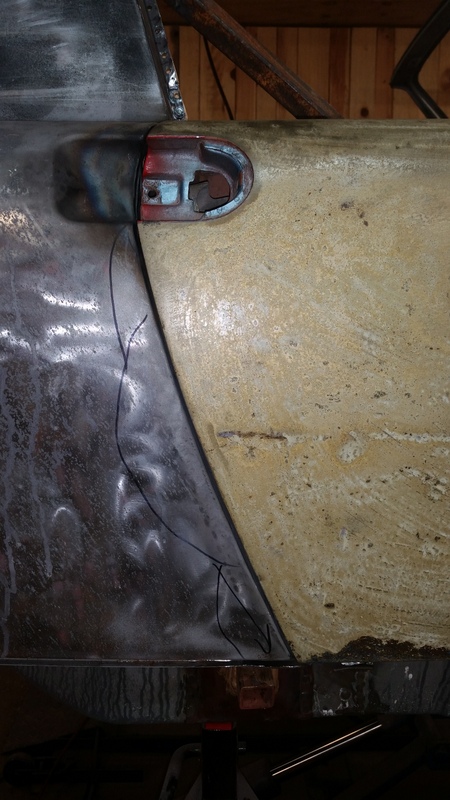

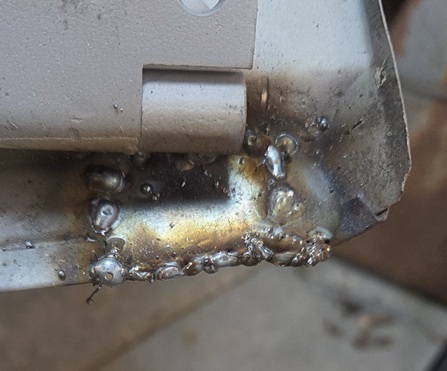

After finishing my rotisserie I am finally getting back to actual car work (started in 03). I am redoing what I did in the past (made a mess of it) and hopefully moving on from there. Doug has is helping me with the restoration, so hopefully we can make some actual progress. The entire passenger side of my car is pretty rotten so we have our work cut out for us. I got the good part of the long cut out so when Doug gets here maybe we can start filling in the gaps.
In this pic I have cut out the outside long bit.

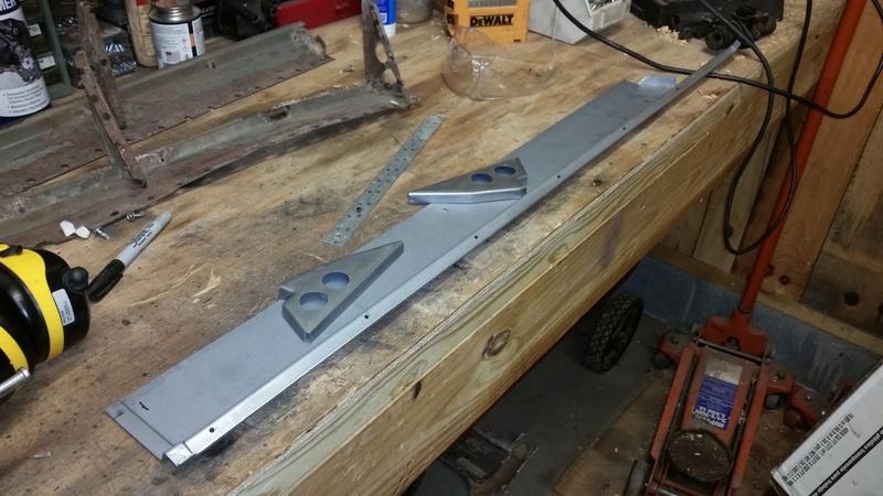

trojanhorsepower   I have an old Restoration Design? patch panel for ...   Nov 16 2013, 08:34 AM
rick 918-S   The dimple actually touches the outside panel. Tha...   Nov 16 2013, 08:46 AM
trojanhorsepower   Thanks Rick, That makes sense. So I need to make...   Nov 16 2013, 09:42 AM
rick 918-S   Thanks Rick, That makes sense. So I need to mak...   Nov 17 2013, 07:21 PM
dlee6204   That makes sense. So I need to make a part to w...   Nov 16 2013, 03:12 PM
trojanhorsepower   That would be great Doug. The outer section is ba...   Nov 17 2013, 08:08 AM

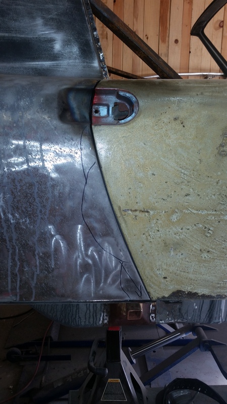

trojanhorsepower   OK so I have started to test fit the outer long pa...   Mar 18 2014, 07:10 PM
trojanhorsepower   :bump: Anyone.... anyone....Bueller...Bueller   Mar 19 2014, 05:13 PM
dlee6204   I wouldn't remove any of it until the long is ...   Mar 19 2014, 06:11 PM
cary   Nothing can come off until the outer rocker is wel...   Mar 20 2014, 02:20 AM
trojanhorsepower   OK, thanks guys.   Mar 20 2014, 02:50 PM

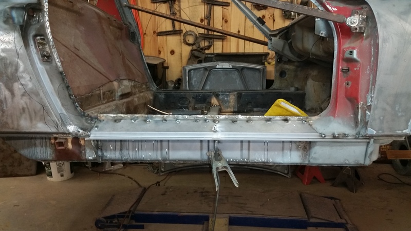

trojanhorsepower   The outer long parts clamped/screwed on. Edit: No...   Mar 24 2014, 04:34 PM
trojanhorsepower   The outer long parts clamped/screwed on.   Mar 24 2014, 04:34 PM
trojanhorsepower   While I wait for some expert double checking on th...   Mar 24 2014, 04:45 PM
