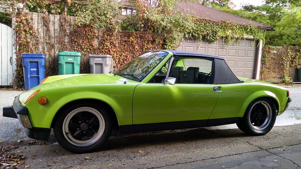

Not the same car but just saw this in the "porsche 914" group on facebook today. Owner says they are 911SC rear flares on all four corners.

I like that one!

Thanks, that's my car (IMG:style_emoticons/default/smile.gif) Here is another pic from a different angle:Attached Image

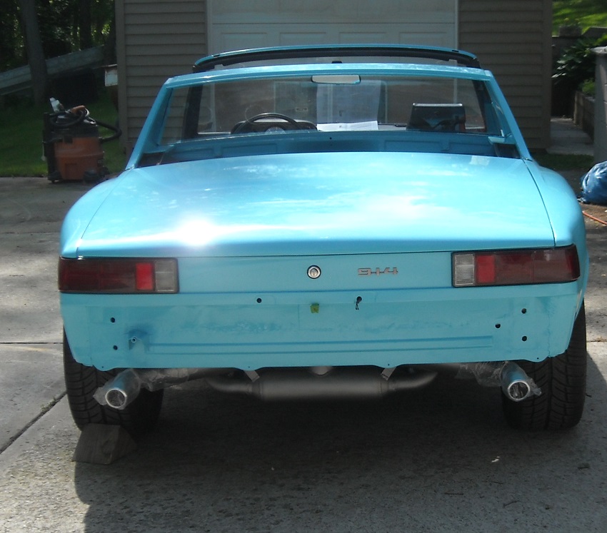

The last posting was 20 months ago. Seeing if anyone has anything to ad to this. I want to run 8 inch 951 Fuchs on the rear of my V8 car because I think I will need more traction than a 7inch 911 Fuchs and smaller tire can me. Even with LSD I think the tires will spin with 400 FPT.
I do not think I want GT flares on this car. Just Flares on the back. Thinking of Carrera or SC flares on back. This is the turquoise (Olympic Blue) car in my Avatar shown with 7 Inch Fuchs front and rear with small tires on it.

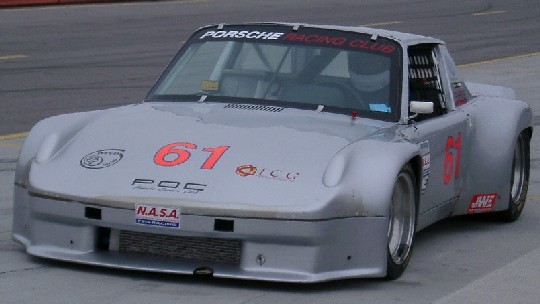

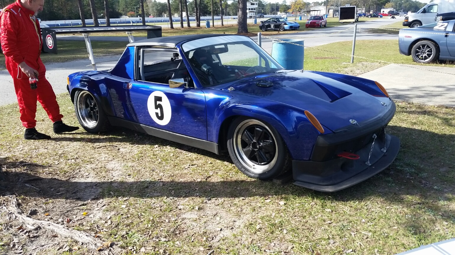

I'm a sbc and I use one of Sheridan's standard widebody's, but my next build will use Rogers widest wide-body.
See image

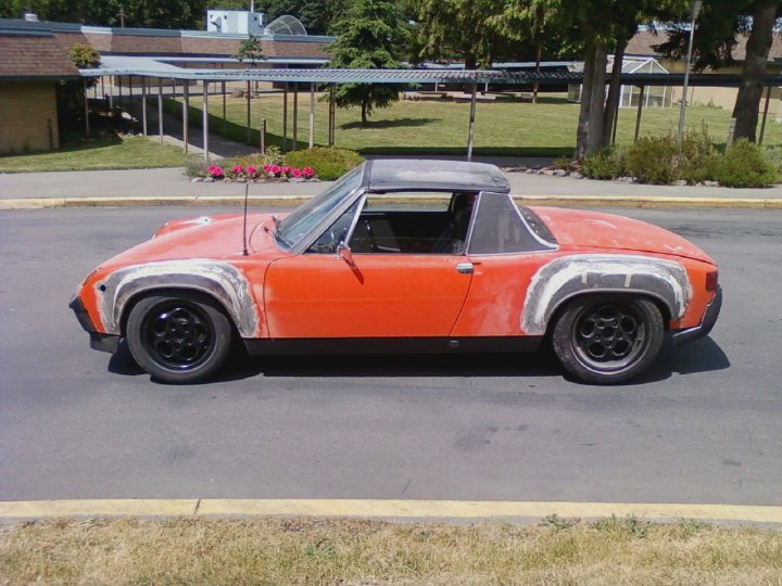

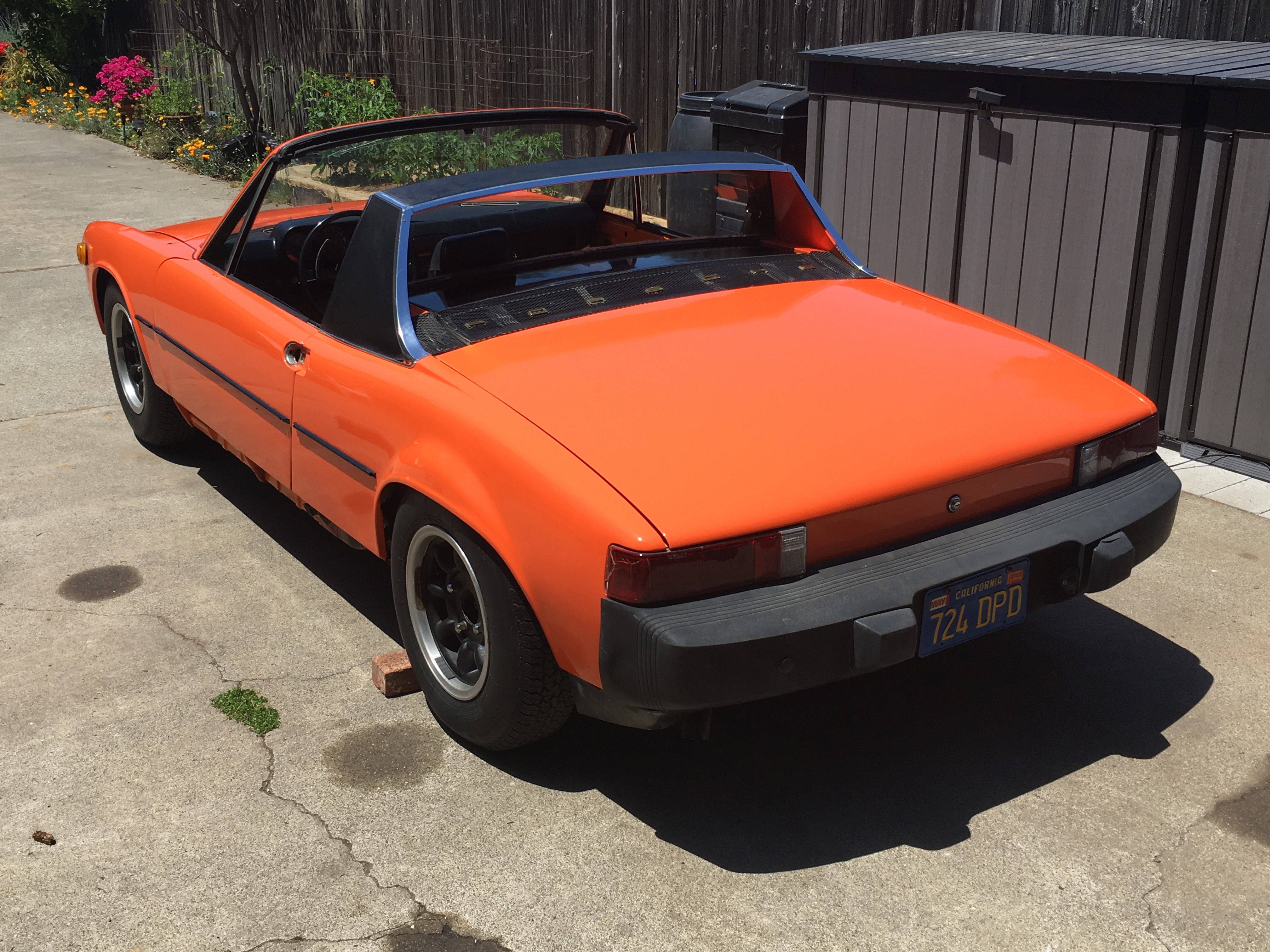

Here's whats on my 76. Definitely a hand job..

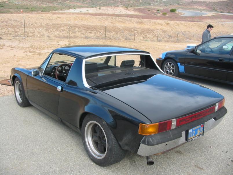

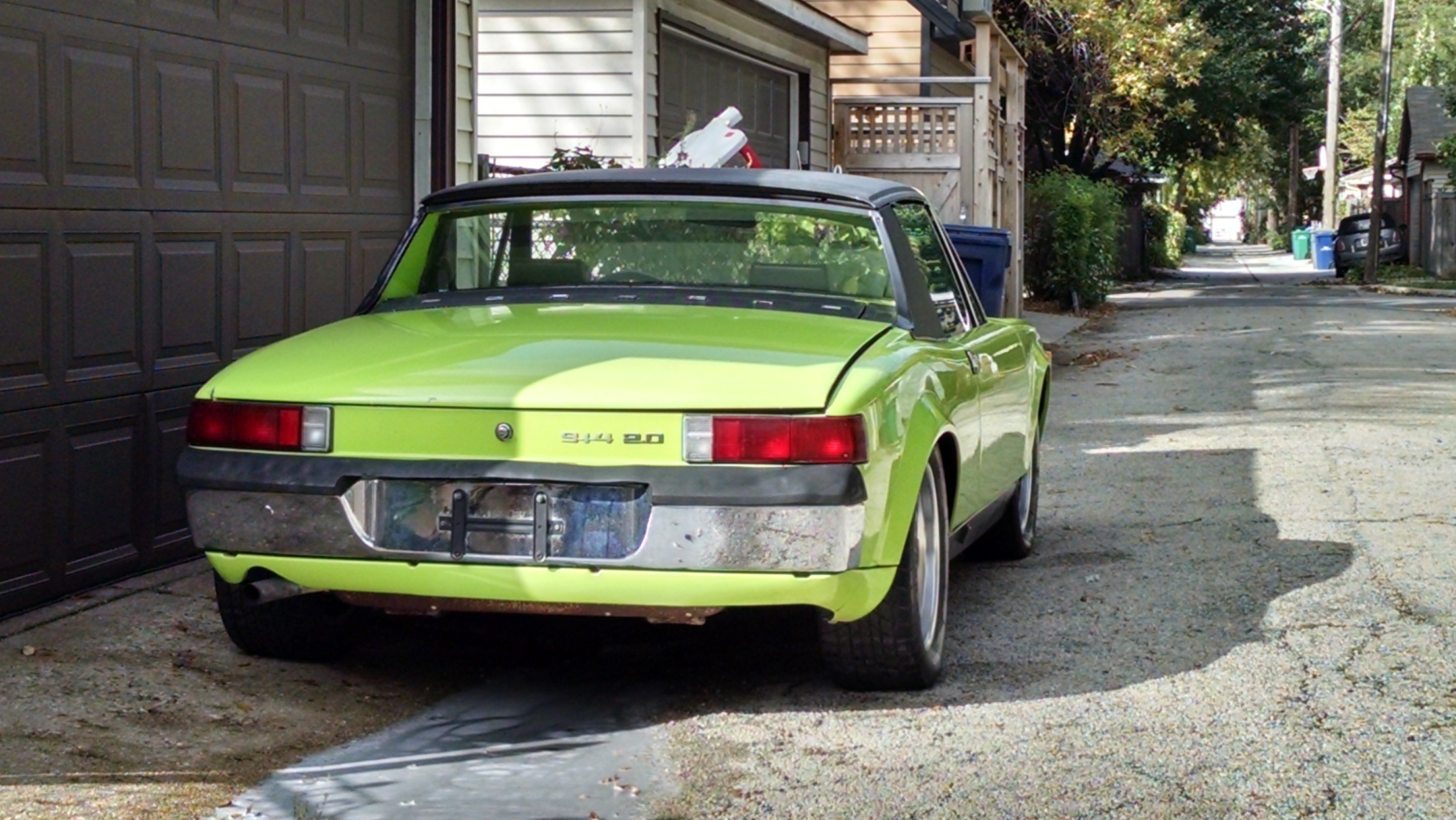

Was told these are sc flares... I've always liked this car... wish I would have bought when it was for sale...

Those SC flares look great! Wonder if I can get my oddball ones to look more like that with the help of a fender roller..

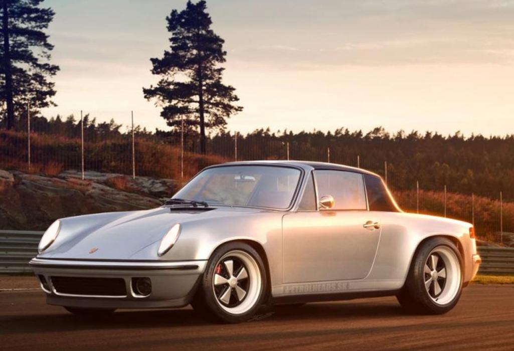

Can't find the drawing I did years ago but this rendering sorta gets it. Basically the GT flares with the 'bulge' tapered like 911s.

I like the look of the "hand job"- it retains the original lines of the fender with the lip which is what I'm planning to do. Since this original post, I've moved and have a 3 car garage with my car on a rotisserie, replacing virtually everything underneath the car including the rotted out floor and all of the suspension components. I've got my wheels and tires chosen, mounted, and have 944 turbo brake calipers all around. I was in a bad accident a couple of years ago not long after moving into my new place and it put me down for about a year and the rehab continues but so does the work on the car. I hope to have more updates as the work continues - keep the pictures and ideas coming!

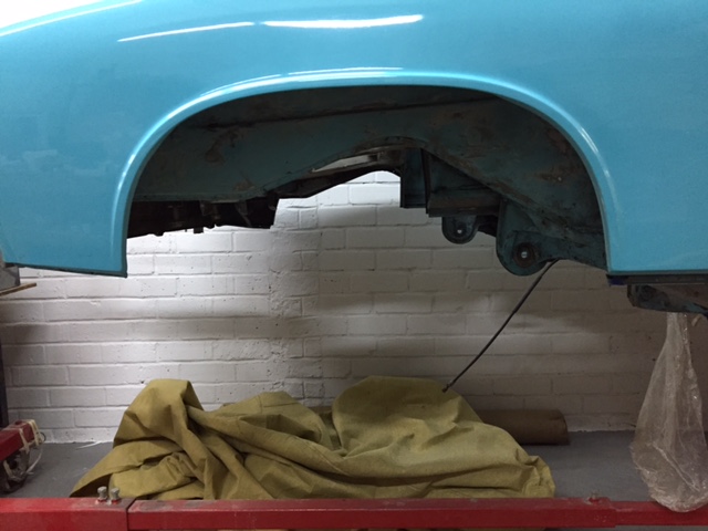

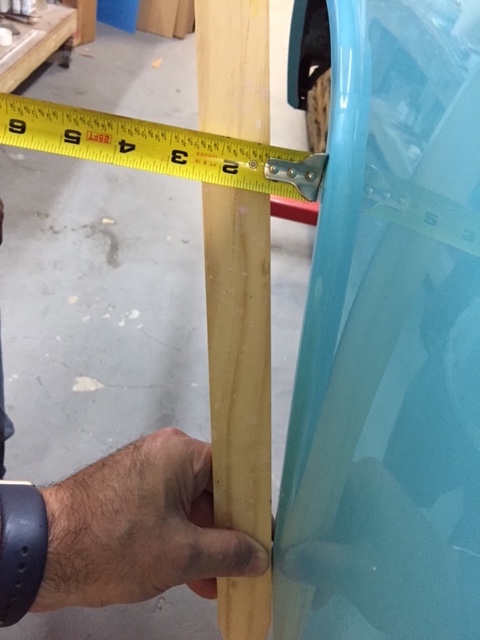

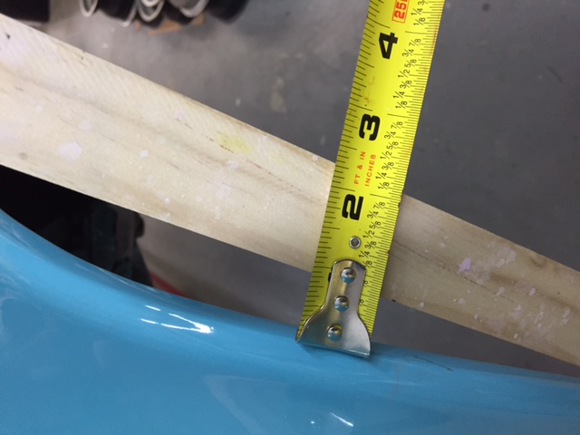

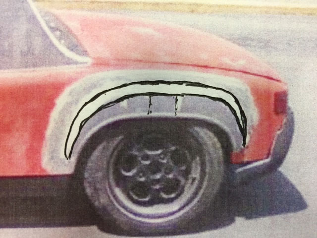

So I made some observations on the 914-body shape and putting on flares or say cutting the factory body and moving it out 1 inch or so. This is what I think Jeff did on posting #21. The bottom of the wheel well goes at a natural taper that way so it seems like this was what done. I put a mixing stick on the bottom and that is the line if you hold the contour.
So I think you cut the line that I show on the picture of Jeff’s car that I marked with pen and then cut some steel to fill it in. I think I will add a piece in the center 1 to 2 inches to
Bow it out, as that is the place where the tires rub on a non-flared car.
You can see the shape of the 914 wheel well and it is longer looking than a 911.

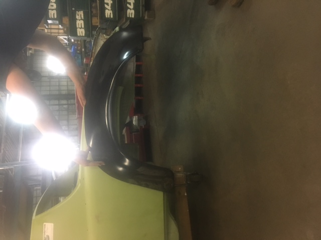

Picture of SC Flare from Peter at Restoration Design.
Bob B
Attached Image Attached ImageAttached ImageAttached Image

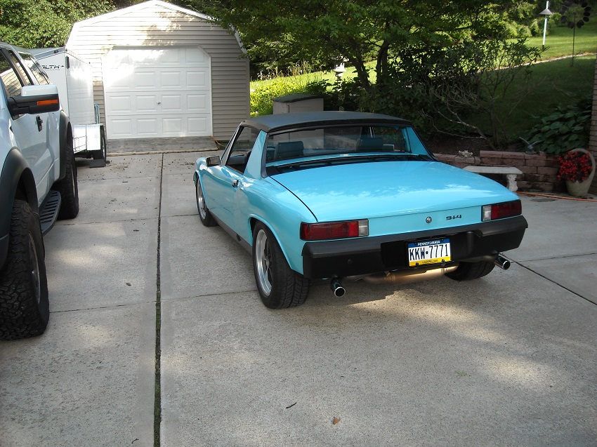

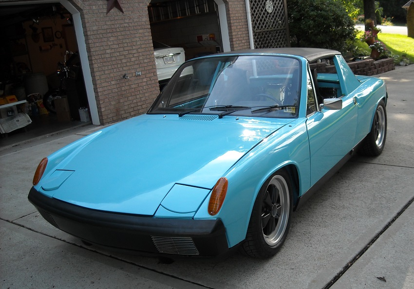

Well I'll jump in here and show you what your car would look like with the Tangerine flares on. It sounds like what you're trying to do anyway.
I have 7s and 8s x16 w/ 225 50 16 on the back.
First without the bumpers on show how wide they are, from other angles you can hardly tell.
These flares are 1" in the front and around 2 1/2" in the rear.
Now the flares on the truck are stock. (IMG:style_emoticons/default/shades.gif)
