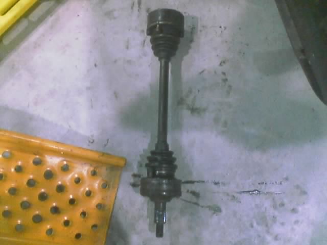

I really need ya'll to come through here for me...
What are these from?

Measurements are a little, depending, 20 inch.
The CV joint thing is like 4 1/8 inch.
And the axle itself is like 1 1/8th inch.

Looks like an early 911 axle with large cv.

From the pic of the cv, it looks more like 4.25 which makes it a 108 mm. Bigger than a 914 cv.

Yeah, these are "big ones". Not sure what that means...
Early like 69-71 911?

Look like bus axles to me. Could be 911 but I would guess they are bus axles, How many bolts in the CV?

I just looked at the early axle that I have and saw that they are shorter than my 914 axles. So that axle you have could very well be bus axles.

I have an early 911 CV right here in my hand:
OD is 4.25"
and it is 1.58" thick (no metal shield like in your picture, bare housing)
this one here has 4 thru holes for bolts and 2 thru holes for pins
the 911 assembly should be about an 1" shorter than a 914 assembly

I thought I gave you this link, see page 3 big axles
We've identified mine as '95 911...

They are 4 bolt with 2 pins.
