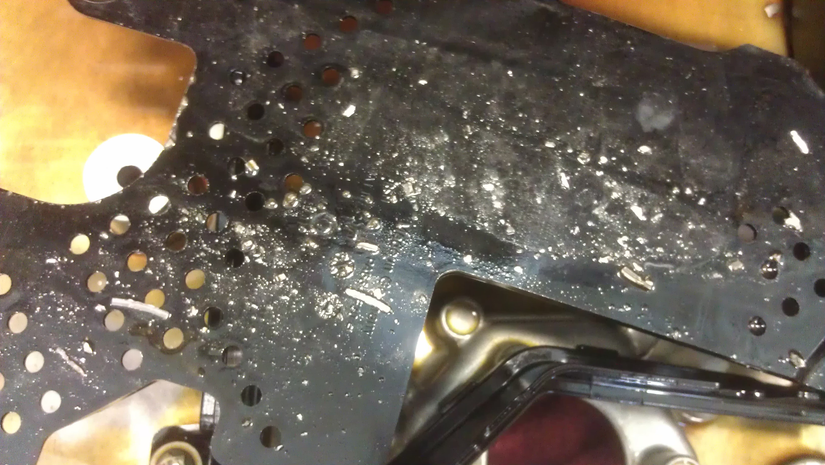

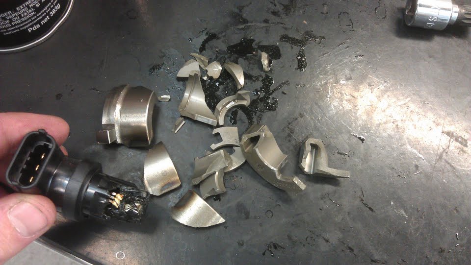

These are just a few of the engines I have gone into recently.
Cayman R with under 1,000 miles. Car was one month old when this happened. Oil pump failure. My instructions from Porsche were to dissassemble the engine, find the point of failure, and determine if the engine should be rebuilt or replaced. This engine had cylinder scoring so it was replaced.
997 Gen 2 water pump pulley disintegrated from an outside influence. Car was driven till it stopped running. Cylinders were found out of round and scored. Notice the coolant displacement plugs are melted. Engine replaced.
Panamera V8, camshaft failure due to a locked up high pressure fuel pump. Engine dissassembled and cleaned of all debris, reassembled and returned to a happy customer.
Now of course, I must have sourced all of these pictures off the internet since king raby says he is the only one that goes into these engines and the dealer just boxes them up and sends them back to Germany. And of course I'm sure these were all improperly diagnosed as well since dealer technicians are a bunch of idiots without a clue. Just a bunch of misinformation from a fellow that can't help but self promote himself.

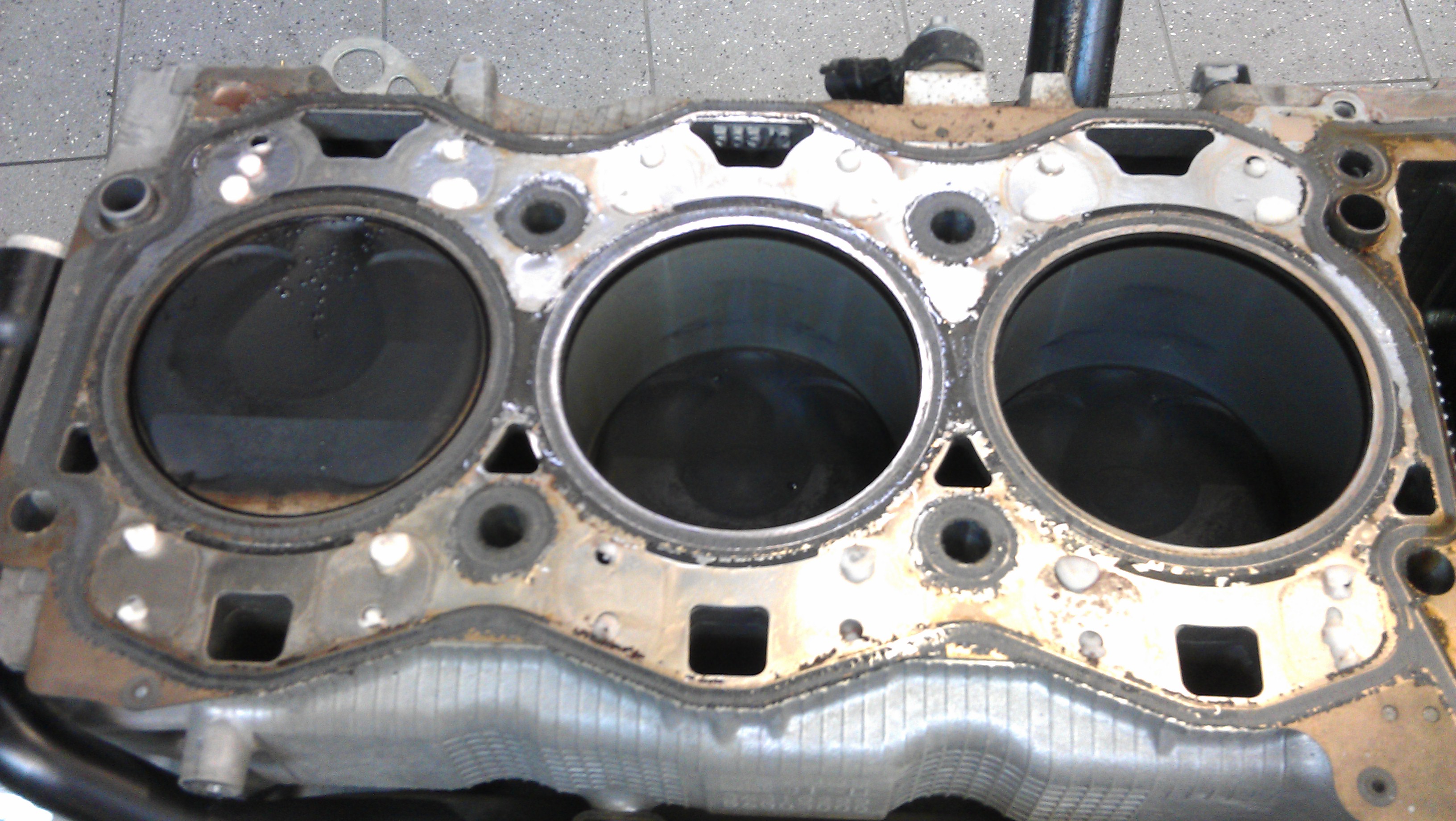

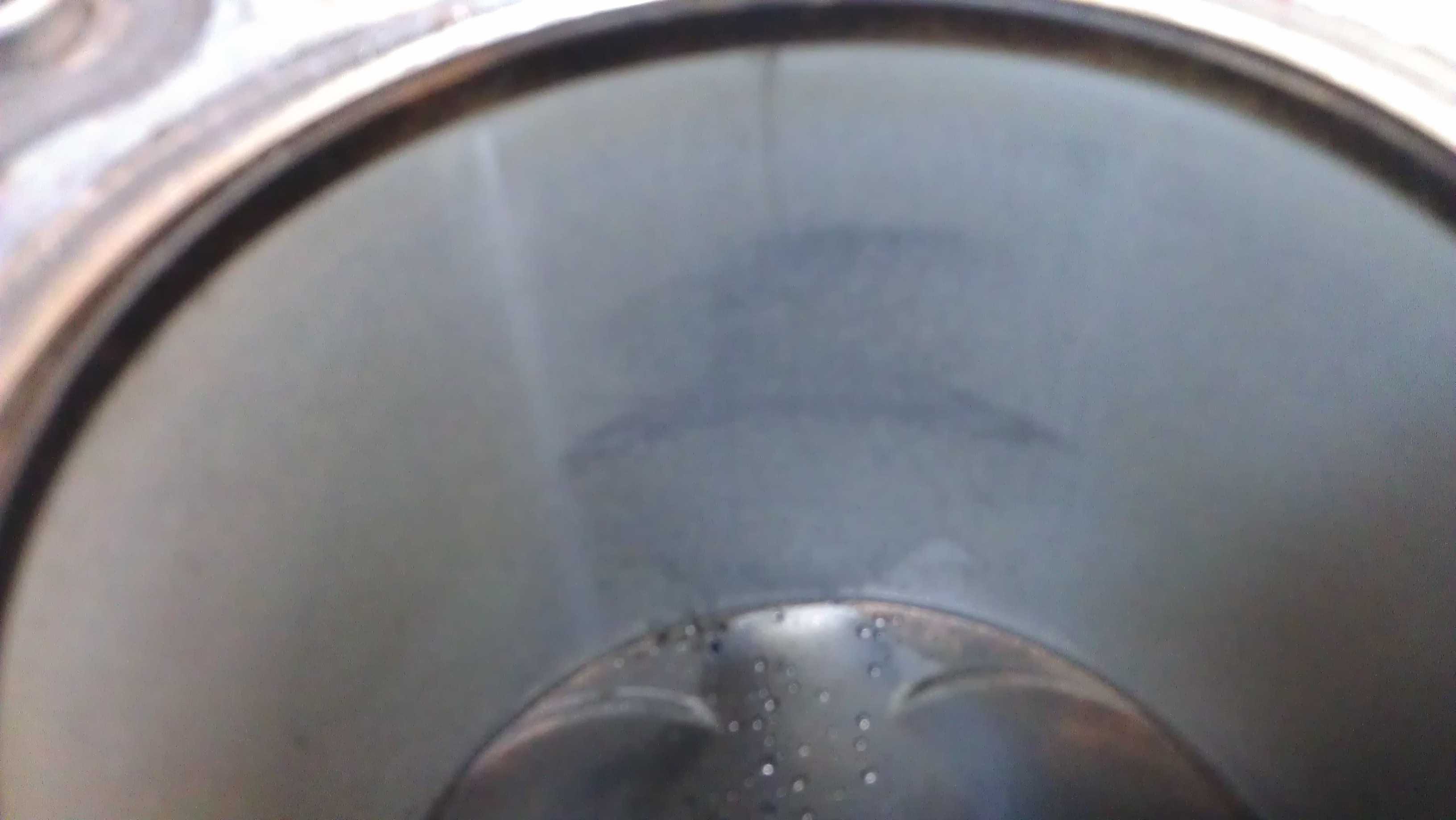

I have seen the same cylinder wear in the 9a1 engines, one at 14K and another at 4,165 miles.
They came apart because they weren't big enough :-)
