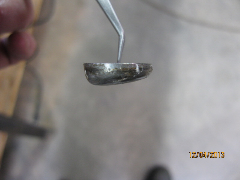

Jake Raby   The M96 engines DO NOT blow head gaskets. Period...   Dec 4 2013, 08:25 PM
Woody   You need someone with a clue about M96 engines t...   Dec 4 2013, 09:13 PM
Jake Raby   Now.. Wonder how I guess about your failed water p...   Dec 4 2013, 09:57 PM

Woody   Ive done over 100 water pumps on m96 and 97 engine...   Dec 4 2013, 10:14 PM
Jake Raby   Ive done over 100 water pumps on m96 and 97 engin...   Dec 4 2013, 10:27 PM
Woody   Have had plenty with broken or missing blades and ...   Dec 4 2013, 10:35 PM
Jake Raby   Have had plenty with broken or missing blades and...   Dec 4 2013, 10:50 PM

Jake Raby   Where the debris ends up there's no way to rem...   Dec 5 2013, 05:39 AM

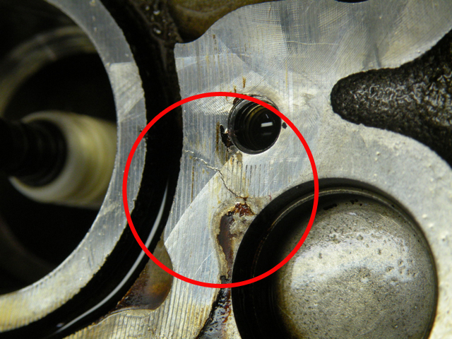

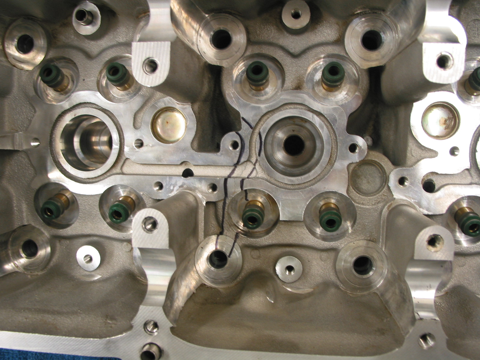

bam914   Every car that comes in the shop with inter mix he...   Dec 5 2013, 12:51 PM
jesiv   God I wish someone would have explained what would...   Dec 5 2013, 12:58 PM

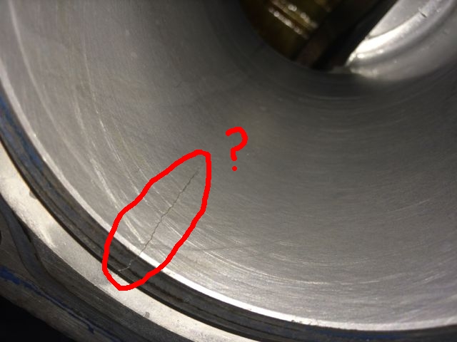

timothy_nd28   Hey, how do you repair these cracks? Do you v-not...   Dec 5 2013, 03:48 PM
Jake Raby   Hey, how do you repair these cracks? Do you v-no...   Dec 5 2013, 03:51 PM
