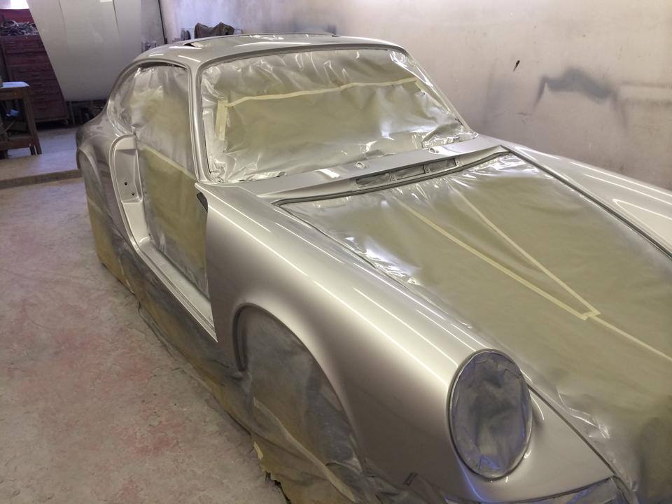

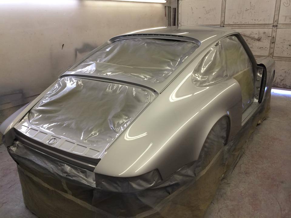

Off the tub went to be stripped and prepped for flares and paint work. Here you can see the "after" shot with the flares on and glass panels being fitted:

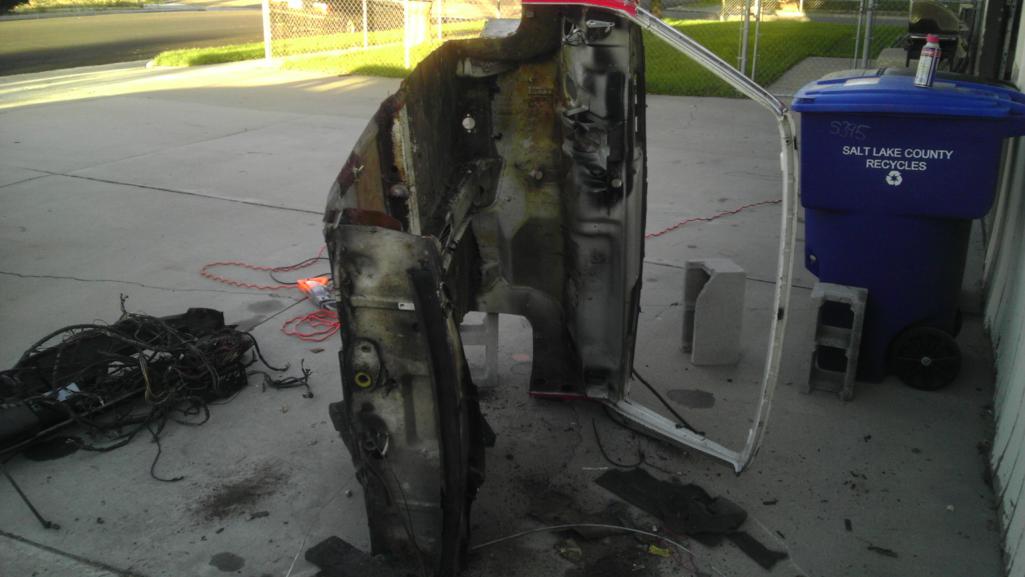

There was a lot of metal work needed as indeed... the rust was free on this one. Before flares could go on, a new quarter panel was needed and various stiffening kits (factory and 914LTD) added to ensure minimal twist with an impending 3.6 install. The car was then painted "Signal Orange" and given back to Mike for some detail installments.

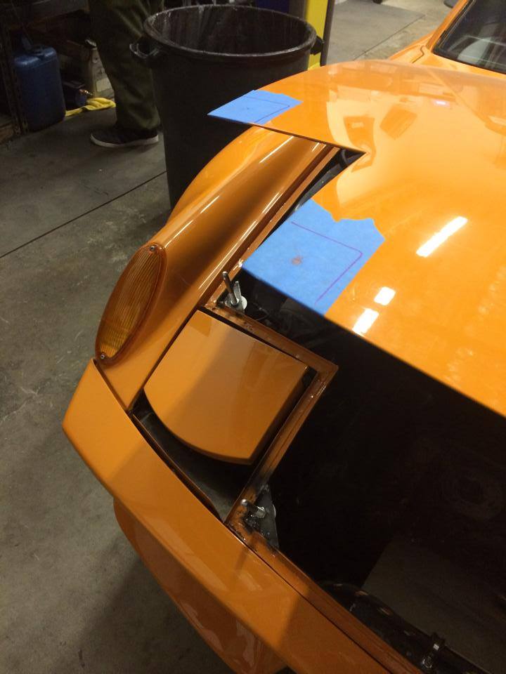

Eric_Shea   Rear hood tie-downs in place: http://www.914world...   Dec 7 2013, 06:40 PM

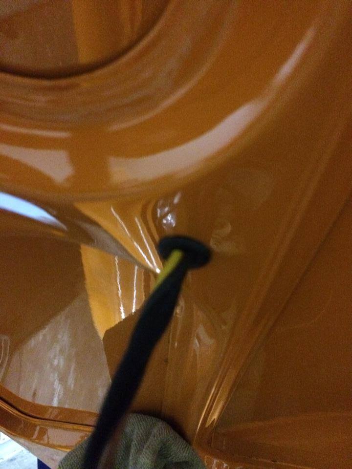

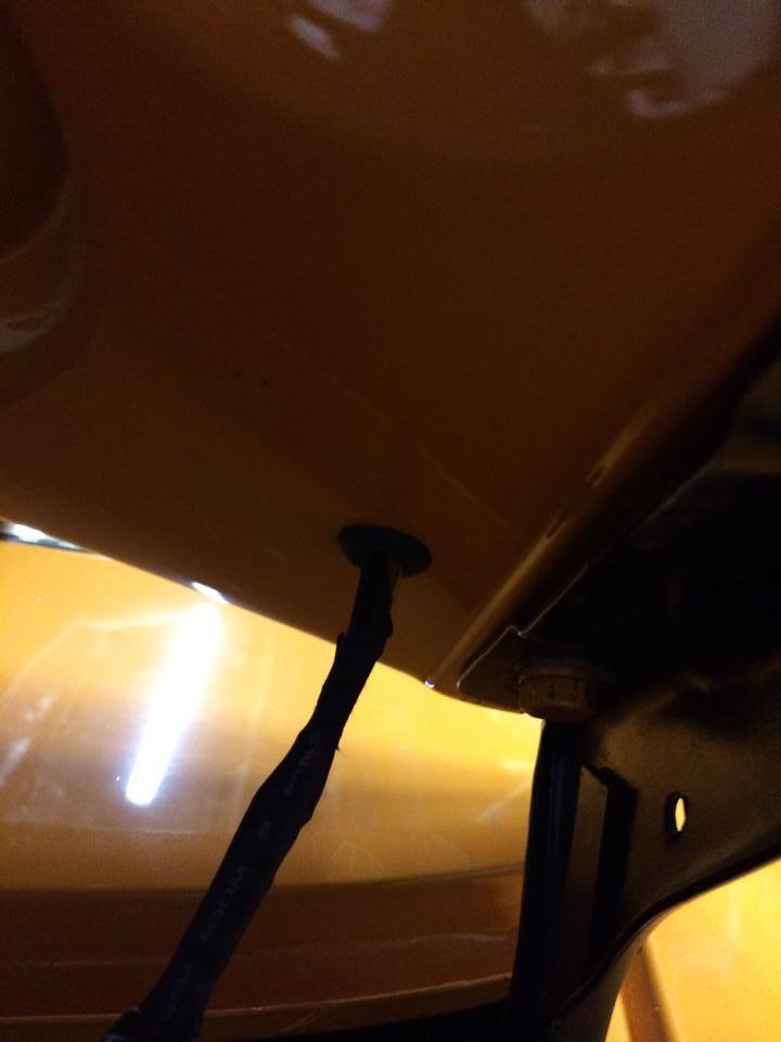

Eric_Shea   Wiring harnesses built and run for the Cibie hood ...   Dec 24 2013, 10:49 AM

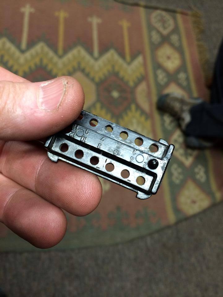

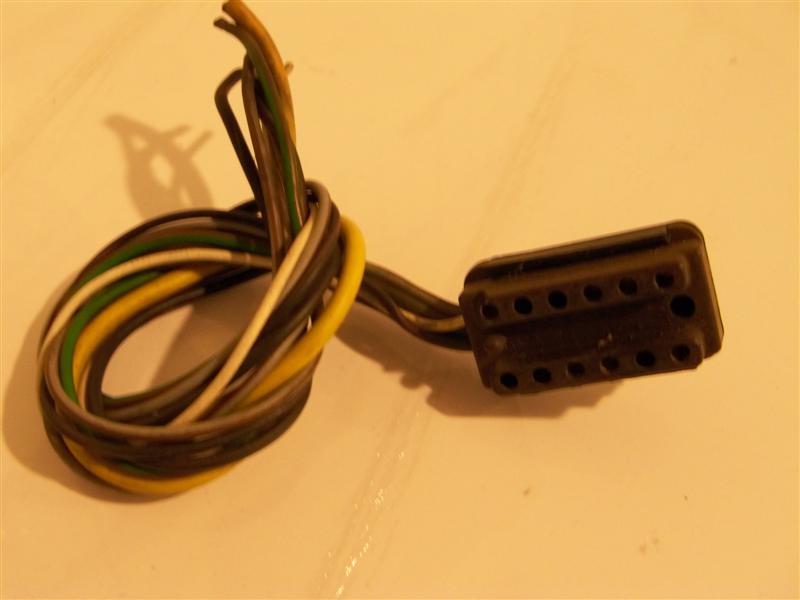

Eric_Shea   Rich saves the day and the 12-pin connector is bac...   Jan 8 2014, 11:19 AM

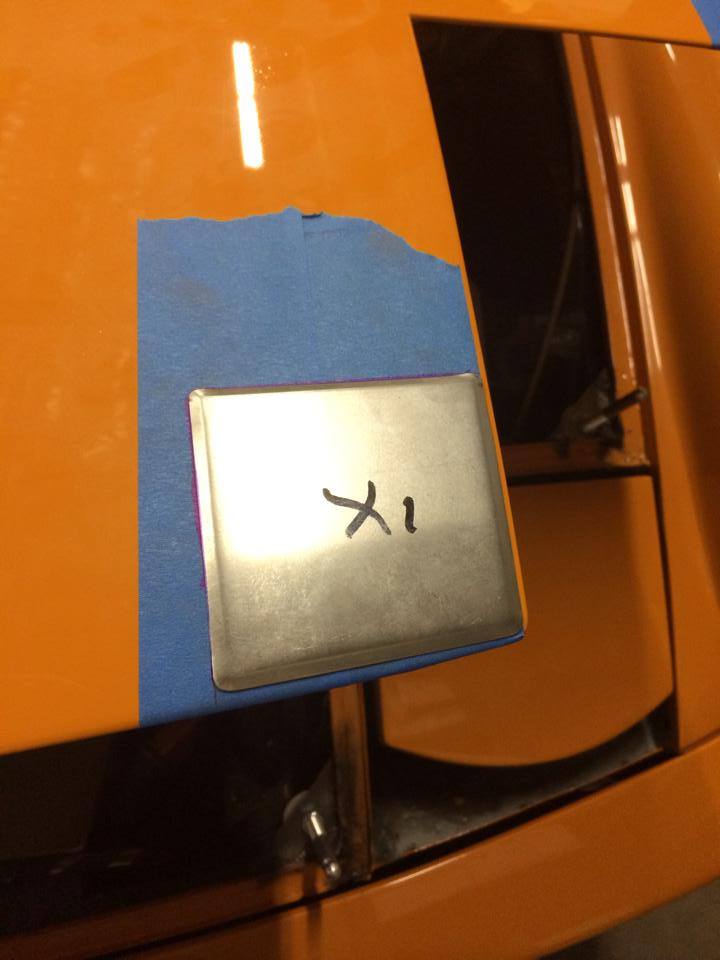

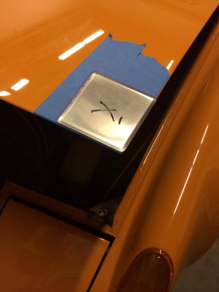

Eric_Shea   We finished off the pins but I've neglected th...   Jan 29 2014, 01:23 PM

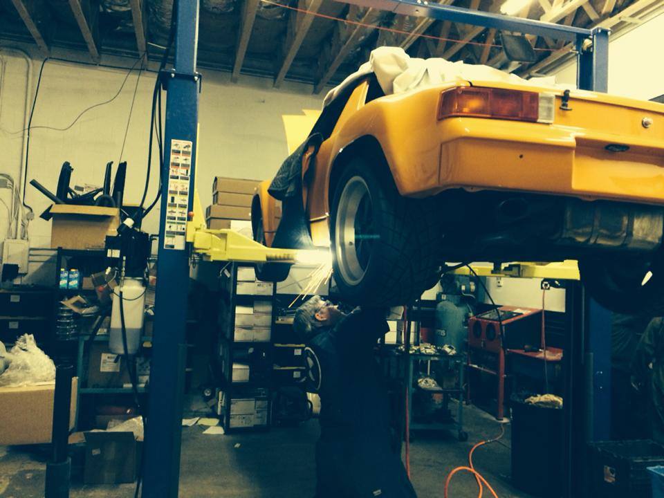

Eric_Shea   Next, out comes the 3.2 and we get ready to finish...   Jan 29 2014, 01:53 PM

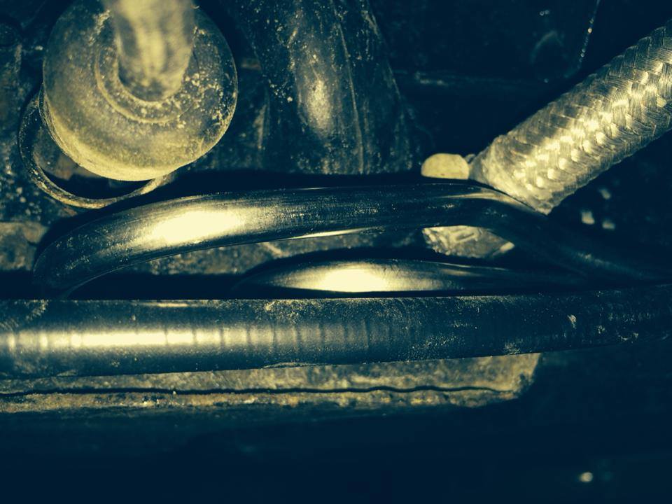

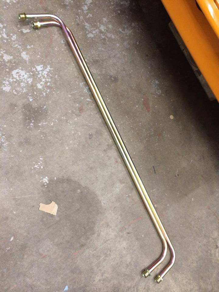

Eric_Shea   Next is the hard line install. If you recall, the...   Jan 29 2014, 01:58 PM
r_towle   Very nice. Is that a 914LTD long plate of steel on...   Jan 29 2014, 03:09 PM
Eric_Shea   914ltd kit. Regarding the lines; not there yet wi...   Jan 29 2014, 03:38 PM

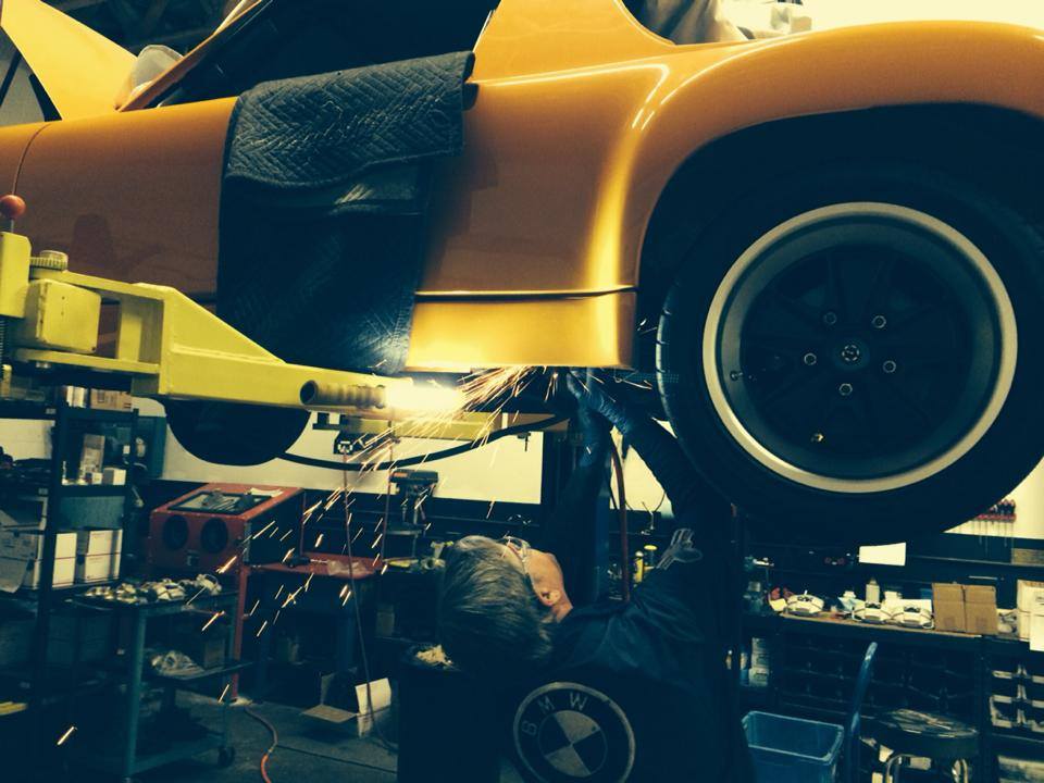

Eric_Shea   So much has been done but so little to show! I...   Apr 30 2014, 06:57 AM
