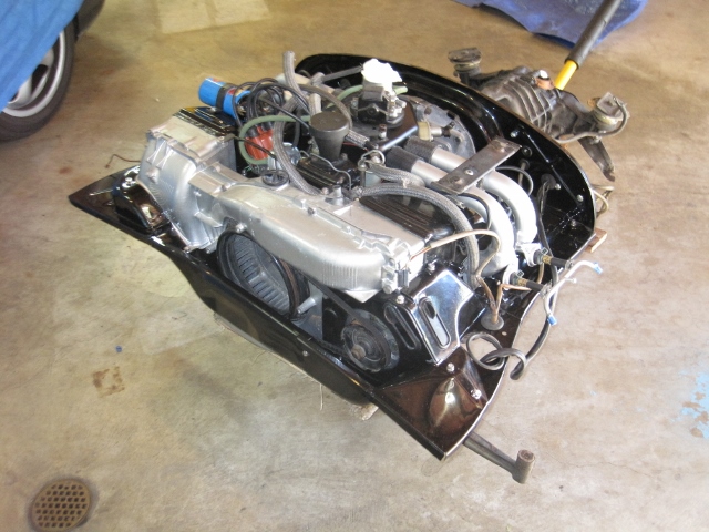

Hi guys,
I spent last few weeks to prep on my newly acquired 2.0 and it's finally in the car! But she doesn't wanna wake up.... (IMG:style_emoticons/default/sad.gif) I know our Bay has been cold lately...but today is beautiful!!!
It turns over, has fuel pressure around 30psi when cranking(20psi soon after when the key turned off), static timing done after points gap adjusted, all the electrical connections checked I think, and what else???
Actually there're at least 2 concerns I can think of. When I got the motor, the dizzy rotor was pointing somewhere around#4 position when the TDC mark was showing in the round window. So I moved the gear in order for rotor to point #1 as I confirmed the valves were loose. But wondering if I did it correctly. I took the gas tank out as I installed stainless fuel lines. The tank was sitting in my garage for about a week or so then it developed some rust. So I cleaned inside with rust remover. But I might not have rinsed it well enough. New fuel filter still looks clean after uncountable numbers of attempt of starting the motor. New fuel sock is in the tank.
So I am stuck now (IMG:style_emoticons/default/sad.gif) (IMG:style_emoticons/default/sad.gif) (IMG:style_emoticons/default/sad.gif) (IMG:style_emoticons/default/sad.gif) (IMG:style_emoticons/default/sad.gif) (IMG:style_emoticons/default/sad.gif)
What do you all think I screwed?
Thanks in advance,
kkid (IMG:style_emoticons/default/smile.gif)

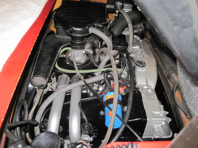

QUOTE(krazykonrad @ Dec 13 2013, 02:37 PM) *
Are you starting the engine with it in the car o on an engine stand?
Konrad
it's in the car already as seen on the 2nd pic.
