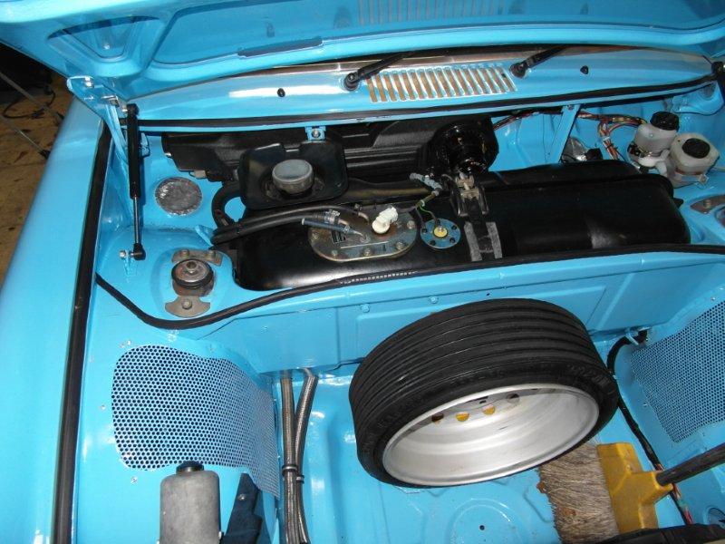

BIGKAT_83   Like mine here. Both heat and AC. Still have to f...   Dec 16 2013, 10:22 PM
mepstein   Like mine here. Both heat and AC. Still have to ...   Dec 17 2013, 08:57 AM
nsyr   Like mine here. Both heat and AC. Still have to ...   Dec 17 2013, 12:41 PM

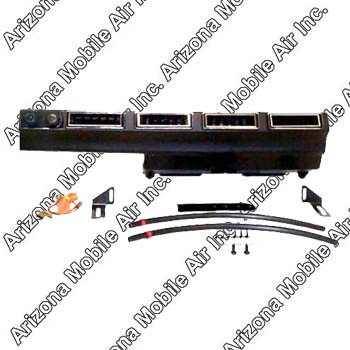

Chris H.   Is this what you used Bob?   Dec 17 2013, 01:48 PM
BIGKAT_83   Is this what you used Bob? I was going to use...   Dec 17 2013, 03:27 PM
mikesmith   The unit you linked is one of the Vintage Air unde...   Dec 17 2013, 01:54 PM
gryphon68   The unit you linked is one of the Vintage Air und...   Dec 17 2013, 02:14 PM
Chris H.   Ah OK. I was trolling all his old threads...we...   Dec 17 2013, 02:05 PM

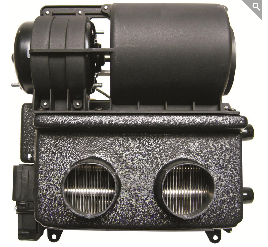

CptTripps   I'm looking at this, thinking it may work well...   Dec 17 2013, 02:17 PM
badmiata   I have seen the under dash ones. Renagade, Pelican...   Dec 17 2013, 02:34 PM
andys   I have seen the under dash ones. Renagade, Pelica...   Dec 17 2013, 04:08 PM

CptTripps   I ordered this one today. I'll let you all kno...   Mar 6 2014, 01:01 PM
