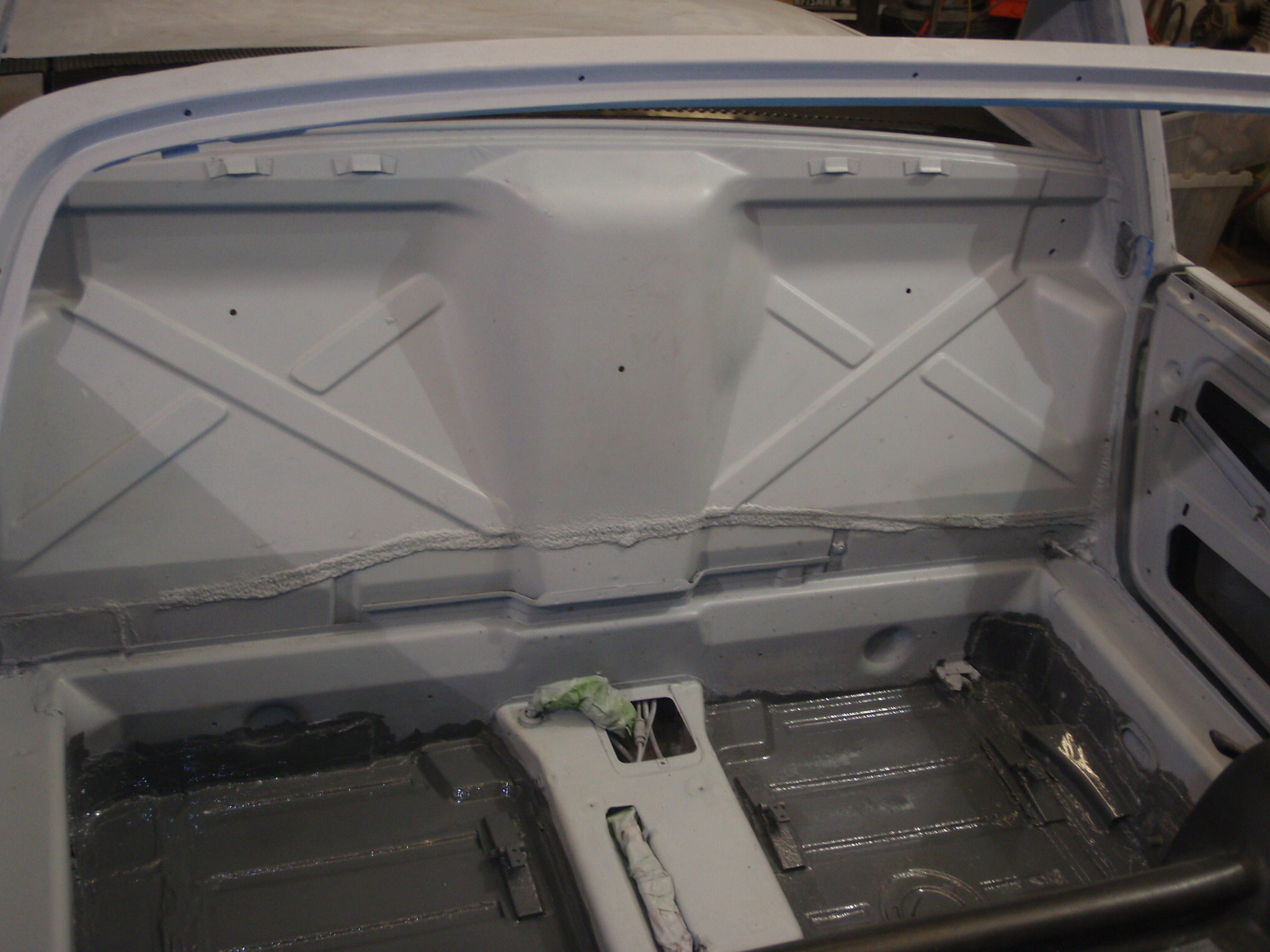

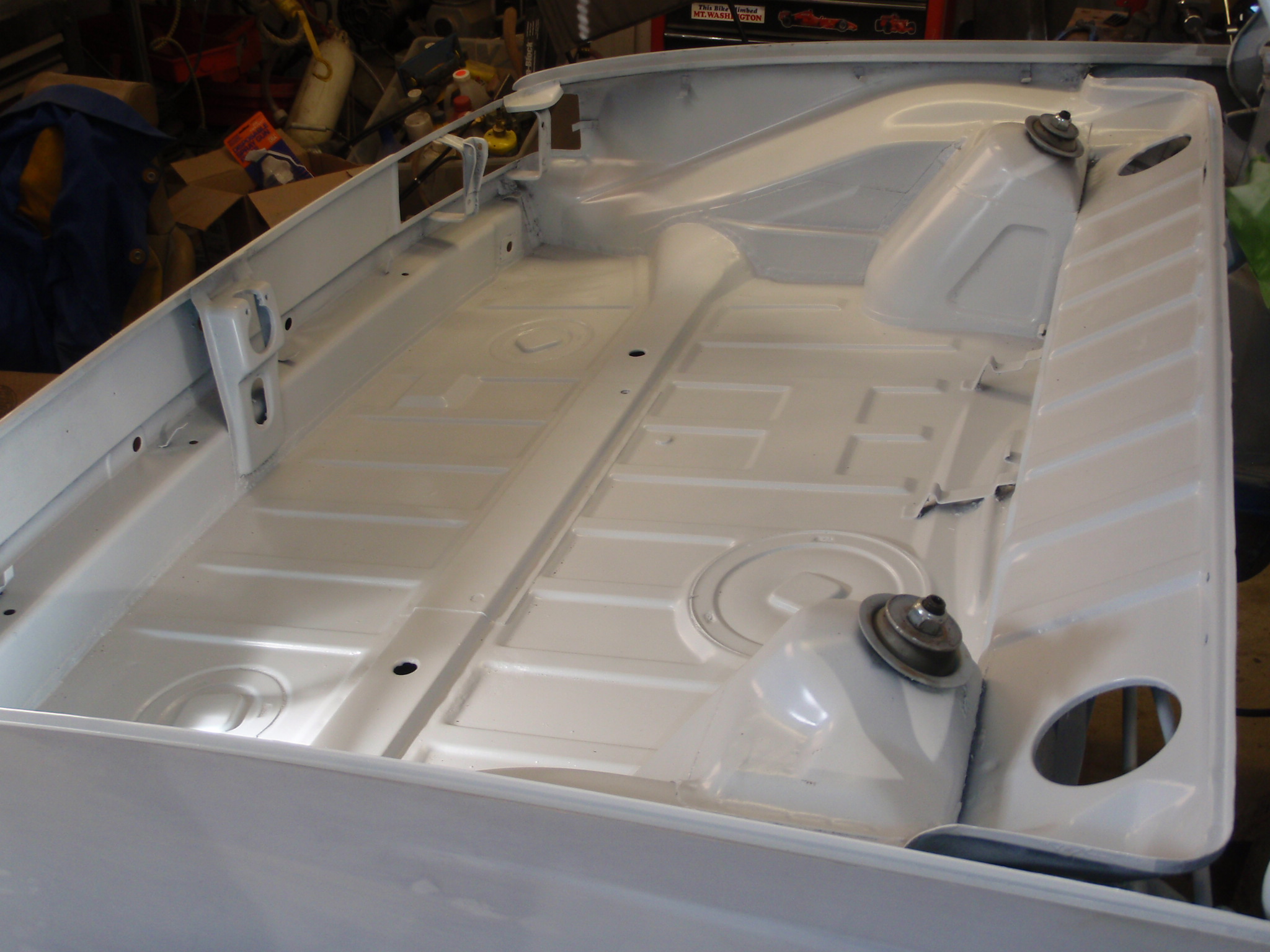

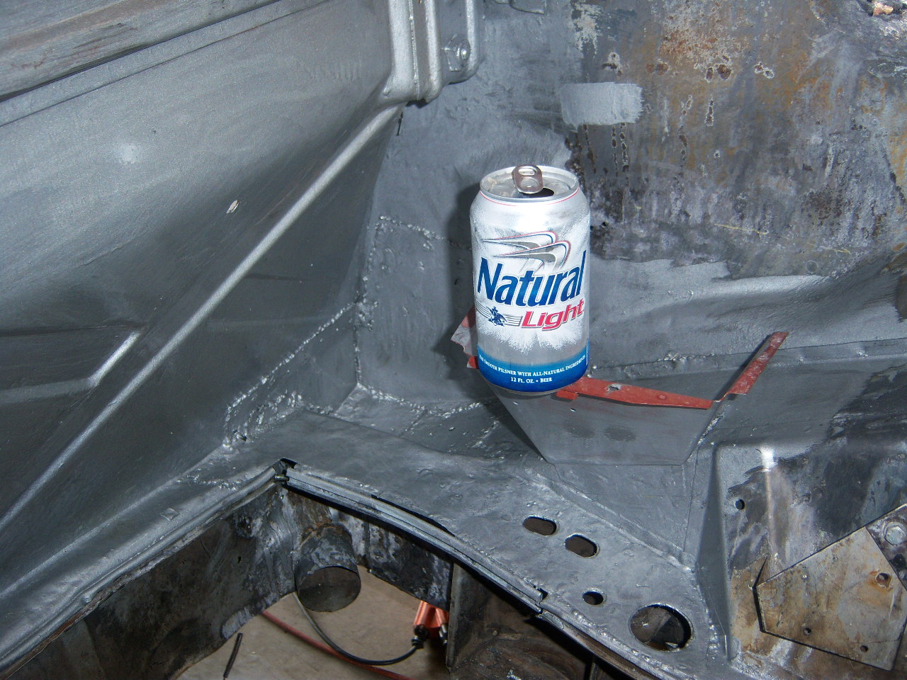

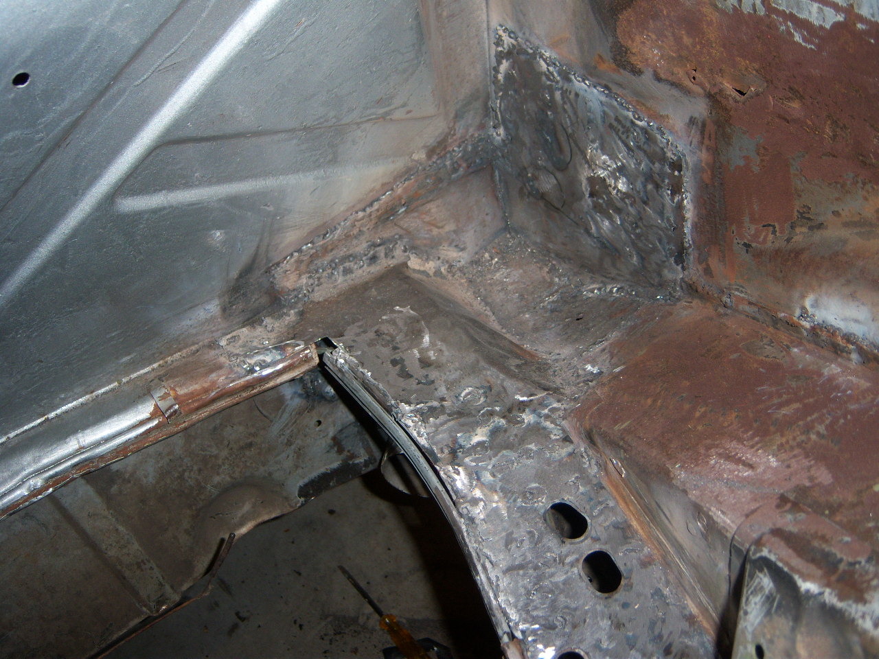

My hell hole, after my ugly welding
And after the POR-15 process. It won't hurt it, but the sun will change the color. They recommend a light sanding and any top coat.

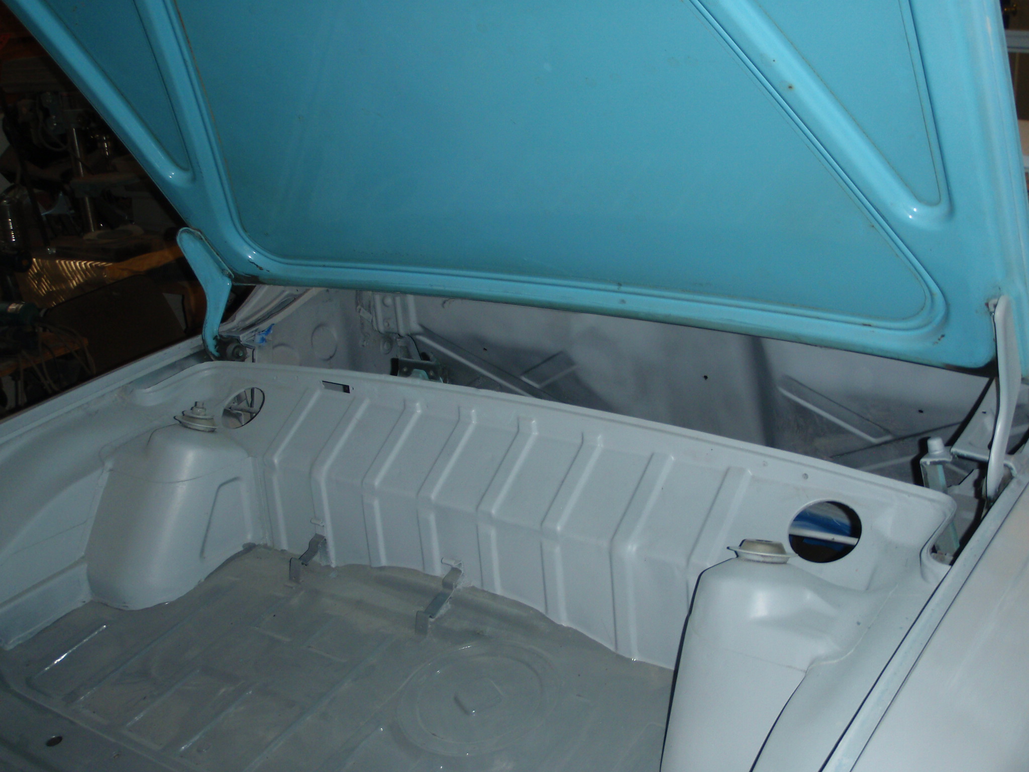

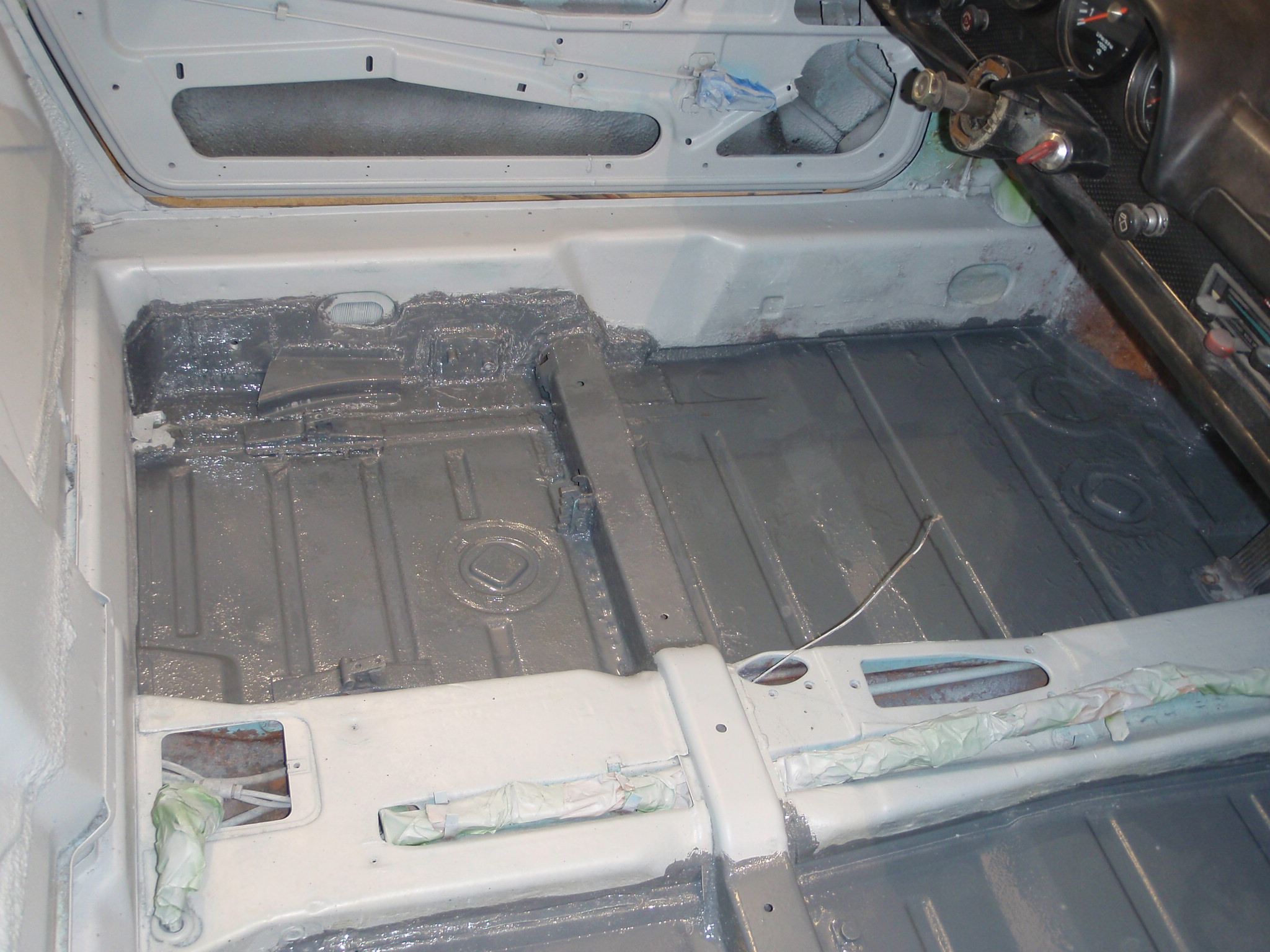

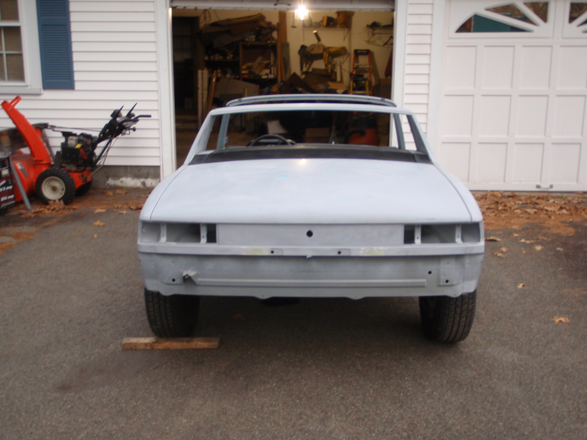

Here are a couple of more shots of how I used POR15
First after application:
Now After Sealer
