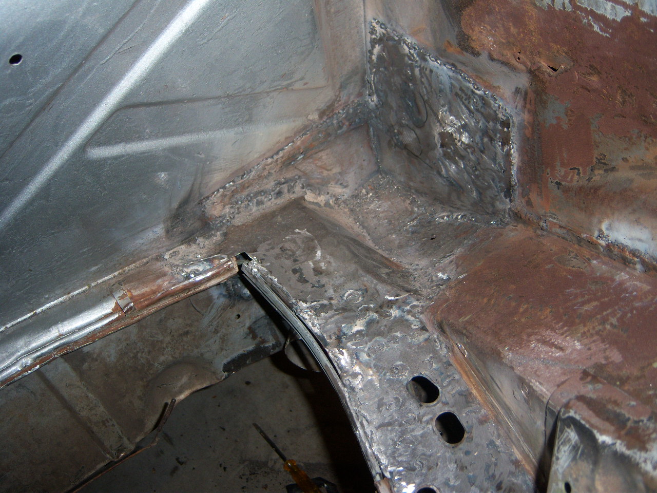

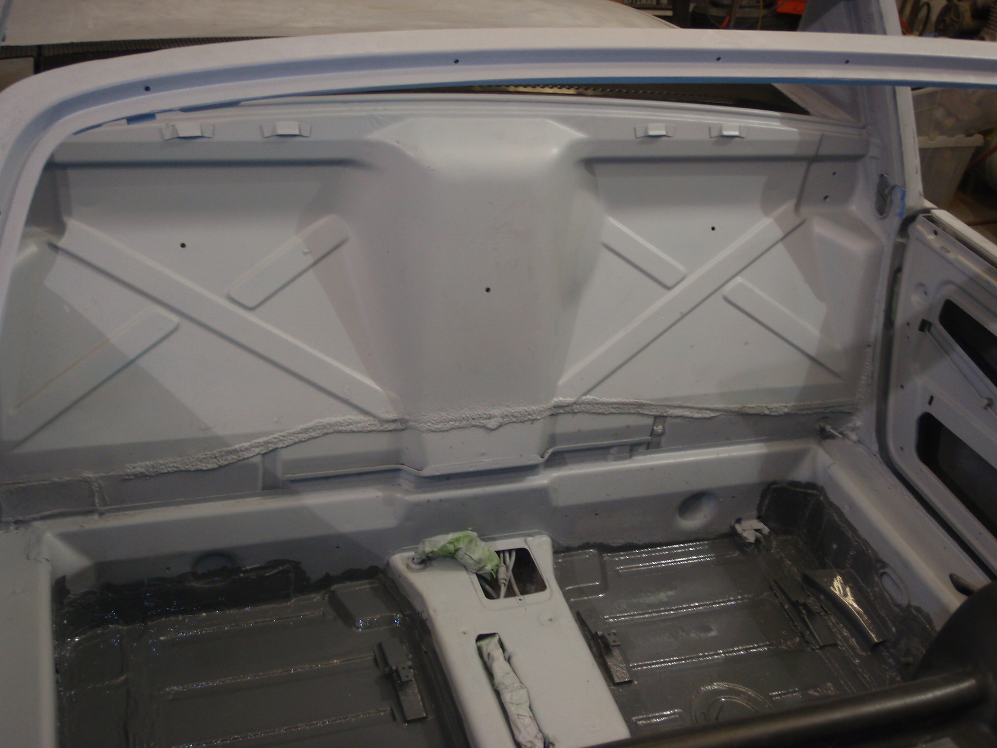

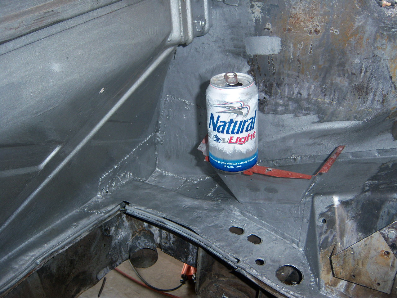

My hell hole, after my ugly welding
Click to view attachmentAnd after the POR-15 process. It won't hurt it, but the sun will change the color. They recommend a light sanding and any top coat.

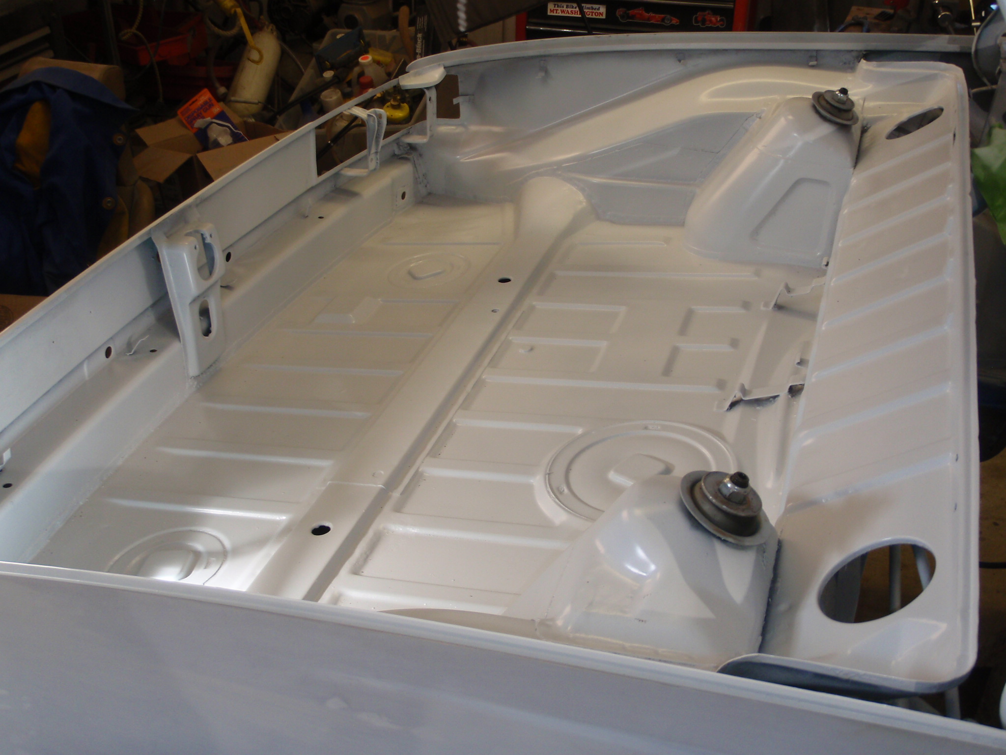

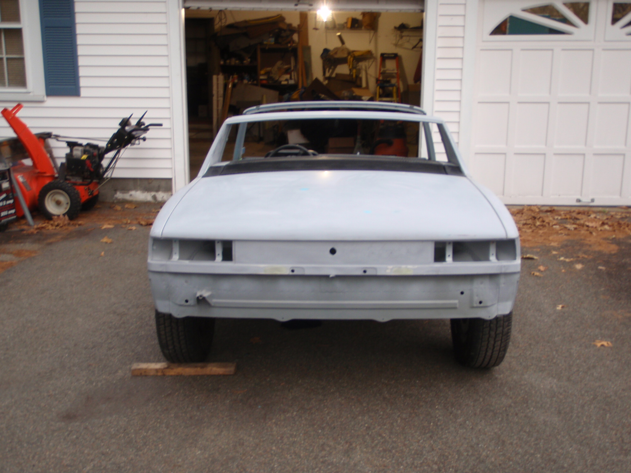

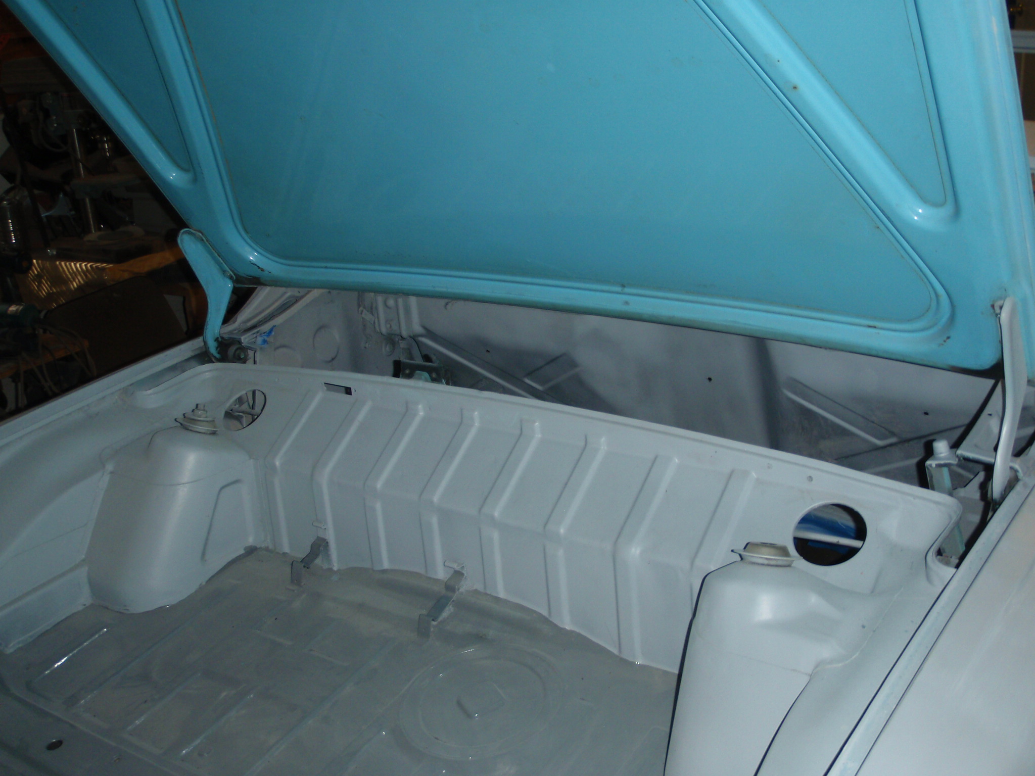

I used the POR15 on pans and trunks after the rust was neutralized and primed. It produces a very hard finish. Oh and I used it behind the bumpers on front and back of car.
Click to view attachmentClick to view attachmentClick to view attachment

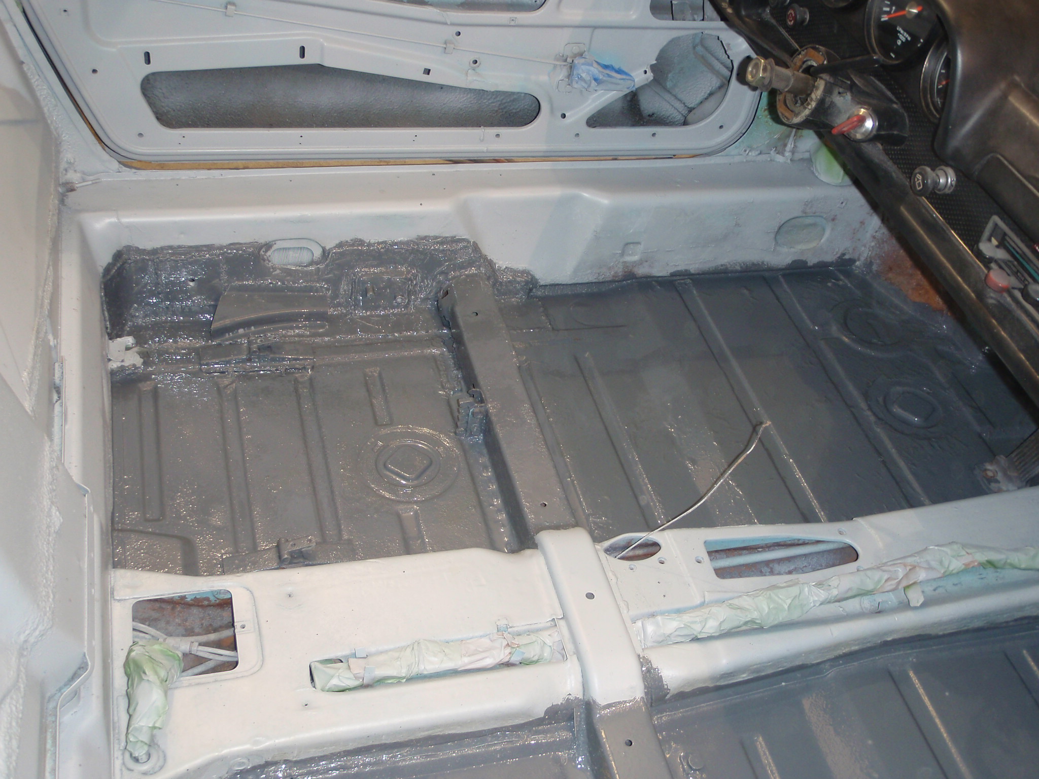

Here are a couple of more shots of how I used POR15
First after application:Click to view attachmentNow After SealerClick to view attachment
