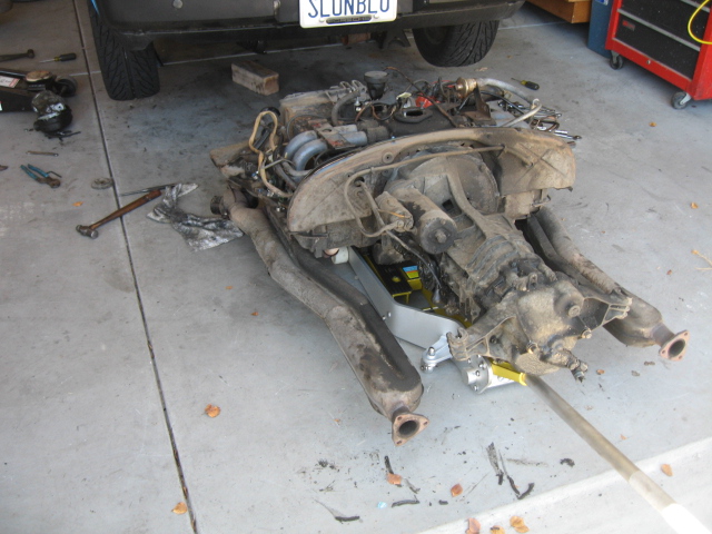

I have used the motorcycle lift. Works pretty good as it gets almost low enough to slide the engine out from underneath the car. I had to jack up the car a little to get the engine out. The table looks a little high and would have the same problem.

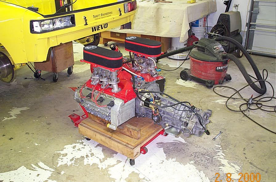

I use a lift table like the one you linked to. It is quite sturdy but you really have to jack the car up to a ridiculous height to clear the halfshafts and carbs, at least on a six. I've done it this way half a dozen times but I'll probably use a motorcycle jack next time around.

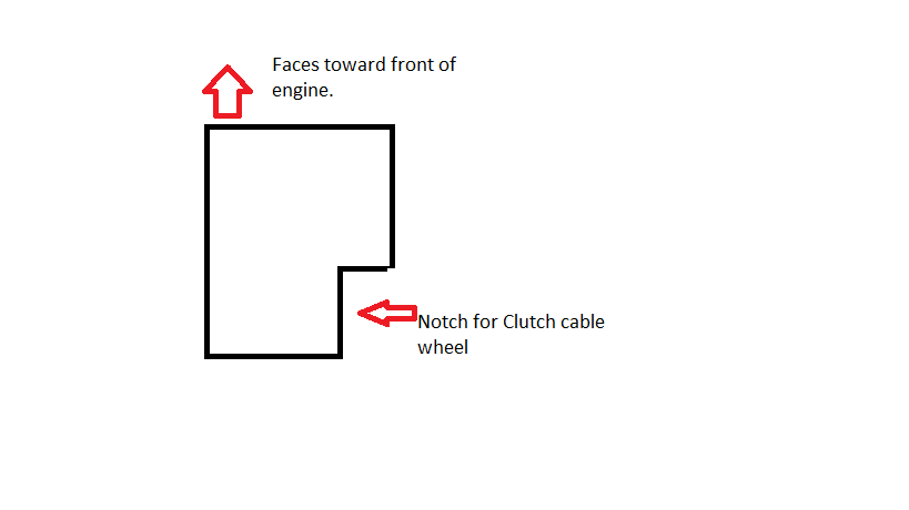

Bill I used a transmission jack from HF. Works great, only need to remove air box to have enough room to slide engine out from under car. I would also suggest adding a piece of wood to the plate of the jack and cut a notch out of it for where the clutch cable wheel is on the trans.

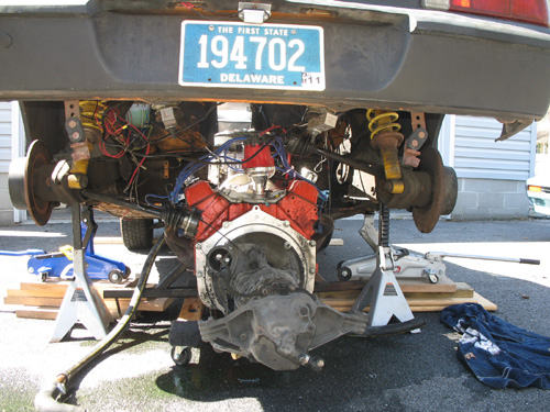

for carbs, remove them from the intakes leaving the linkage/package as is. for fi remove the air filter assem. furniture dolly, wheels off, a floor jack under each control arm as high as they will go, a little dunnage to approximate the angle of the car when it's in the down position, slightly loosen all fasteners, disconnect wiring/hoses, lower onto dolly, remove fasteners, raise back up to full height, roll engine out from behind. you never have to put yourself in harms way or worry about the engine crashing to the ground. you have COMPLETE control of the procedure.
