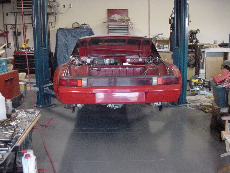

jimkelly
Dec 20 2013, 10:39 AM
furniture dolly is totally fine.
the challenge is getting the car up high enough, safely.

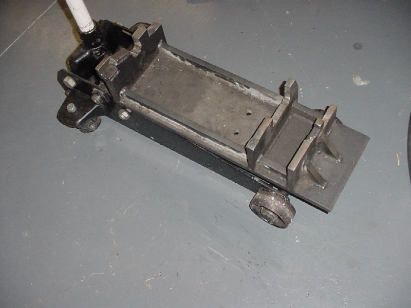

boxsterfan
Dec 20 2013, 10:51 AM
QUOTE(Racer Chris @ Dec 20 2013, 06:09 AM)
QUOTE(cgnj @ Dec 20 2013, 09:03 AM)
I use Tangerine racing's adapter. Works good easy to store
Tangerine RacingI have one on the shelf. Ships USPS Priority.
Does that actually attach to the floor jack or just rest upon it?

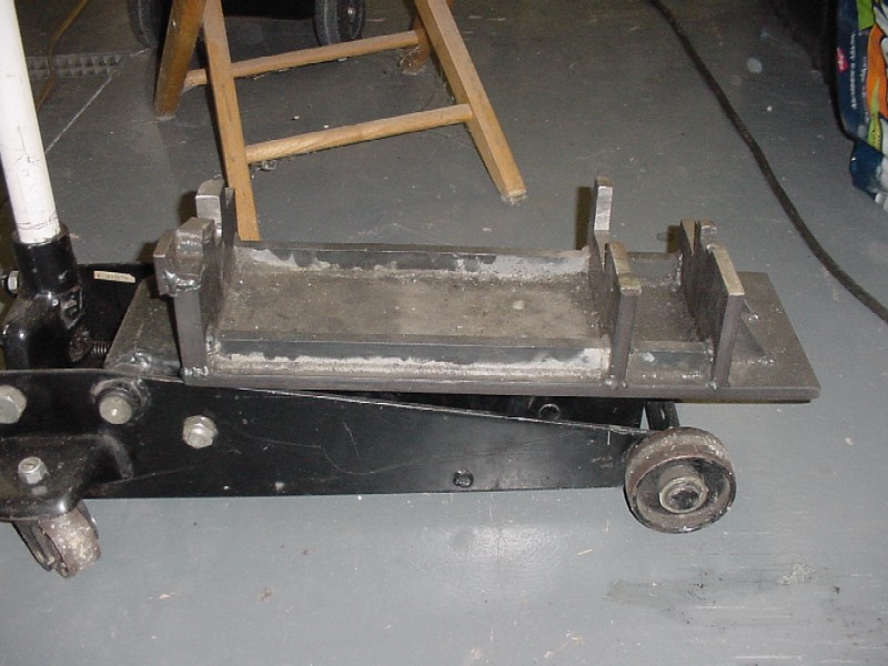

Dec 20 2013, 11:52 AM

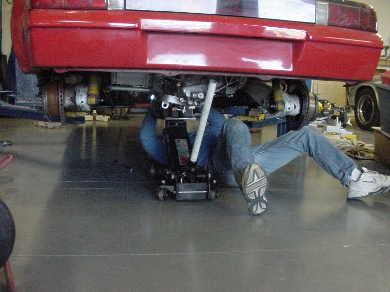

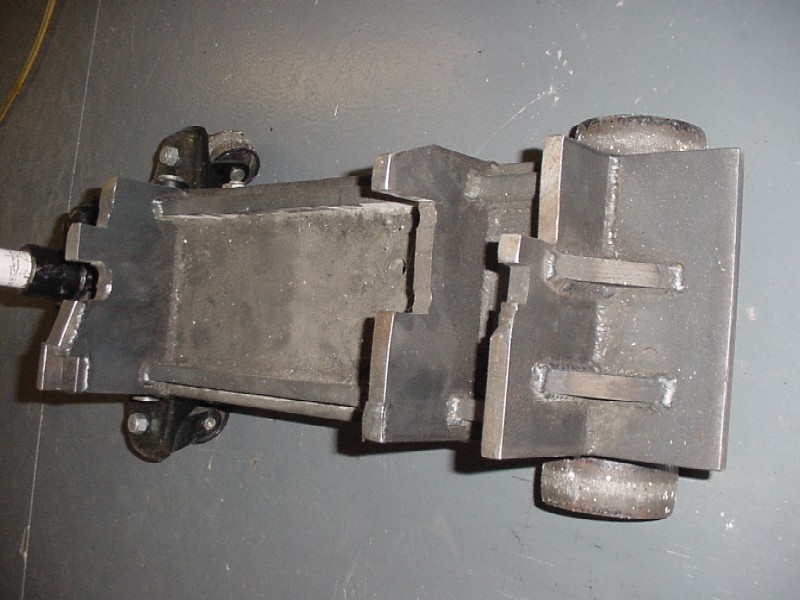

That low profile transmission jack looks good to me. The adjustable tilt feature is something you'll use; it's a nice feature. Also, the wide stance helps with stability.
I made one specific to my engine/trans combo, but it was a lot of work. Used the heck out of it.

ChrisFoley
Dec 20 2013, 11:56 AM
QUOTE(boxsterfan @ Dec 20 2013, 11:51 AM)

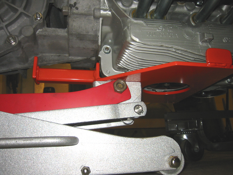

A large diameter pin on the underside of the lift plate drops into a hole found in most older full size jacks. If yours doesn'thave that feature, its simple to bolt a block of wood with a center hole onto the jack.
I modified the Sears jack shown by removing a long bolt that secured the jack top plate, and replaced it with two short bolts to keep the arms attached to the top plate. The center hole was just the right diameter.

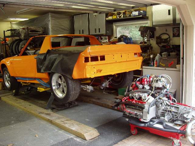

Dec 20 2013, 06:51 PM
QUOTE(jimkelly @ Dec 20 2013, 08:39 AM)
Jim, thanks - that's a fairly terrifying picture given that I'm doing this inside, between another car and our two-wheelers.
How much of that height is actually required? It looks like you still have the carb / distributor on the block - would removing them have helped clearance much?

My car is lowered. I lift it slightly, slide furniture dollys under the bar. Lower the car on the dollys, support the tranny with a jack and unbolt everything. I then lift the car up with my cherry picker and slide the motor out. I hook the cherry picker on my cage inside the trunk. This method won't work on a stock car.

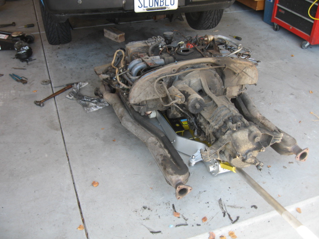

euro911
Dec 21 2013, 12:36 AM
QUOTE(iamchappy @ Dec 20 2013, 10:42 AM)
Lift table doubles as a work area for your engine also.
I've done the furniture dolly method, standard floor jacks, M/C jacks and hydraulic tables. I've currently got pretty much the same set up as Chappy and it's by far the best for a one man operation as far as I'm concerned

QUOTE(andys @ Dec 20 2013, 12:52 PM)
Andys
That is a sweet looking rig

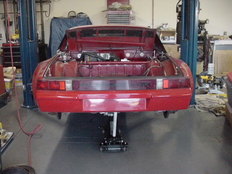

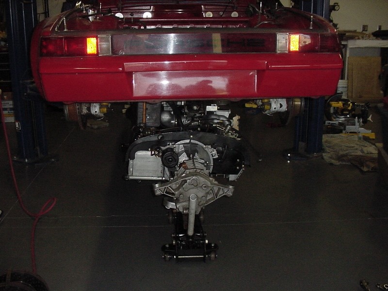

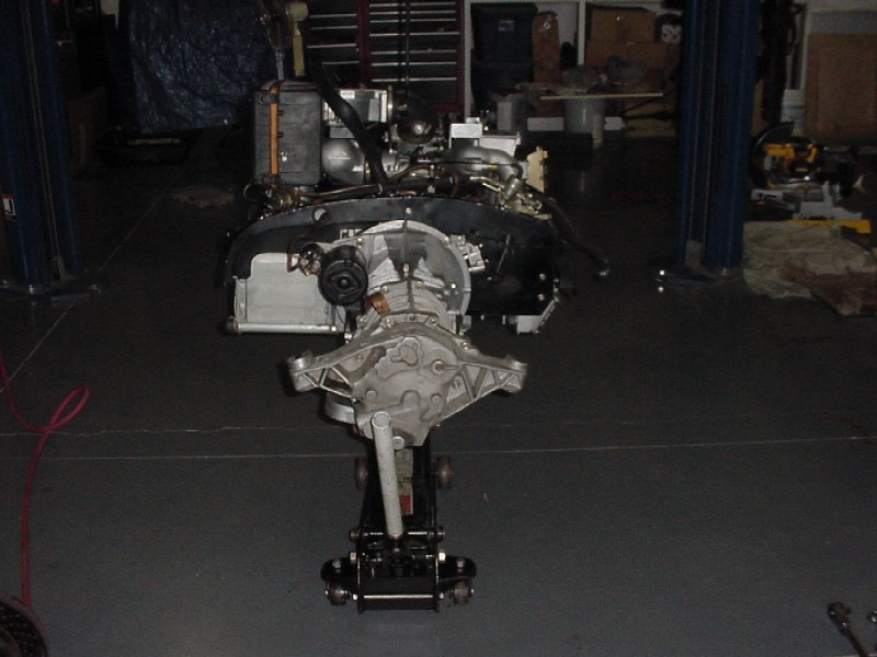

J P Stein
Dec 21 2013, 10:59 AM
QUOTE(J P Stein @ Dec 20 2013, 04:52 AM)
I dropped/installed the motor at least once a year.......it's worth taking the time to make a set up. ......
Click to view attachment Click to view attachmentWith that set up I could drop or install the motor in a couple hours *working alone*. That is starting out with the car setting on the tires. When you're working alone, stability is paramount & a good idea with help.
I did have a few years of practice.

0396
Dec 21 2013, 04:57 PM
QUOTE(Racer Chris @ Dec 20 2013, 09:56 AM)
Click to view attachmentChris,
Who sells these type 4 engine cradle depicted in your picture?
Thanks.
