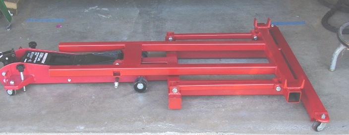

That low profile transmission jack looks good to me. The adjustable tilt feature is something you'll use; it's a nice feature. Also, the wide stance helps with stability.
I made one specific to my engine/trans combo, but it was a lot of work. Used the heck out of it.
Andys

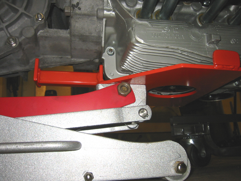

QUOTE(boxsterfan @ Dec 20 2013, 11:51 AM) *
Does that actually attach to the floor jack or just rest upon it?
A large diameter pin on the underside of the lift plate drops into a hole found in most older full size jacks. If yours doesn'thave that feature, its simple to bolt a block of wood with a center hole onto the jack.
I modified the Sears jack shown by removing a long bolt that secured the jack top plate, and replaced it with two short bolts to keep the arms attached to the top plate. The center hole was just the right diameter.

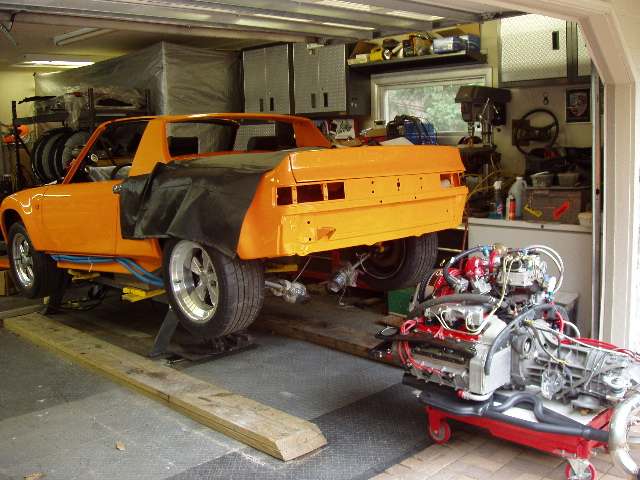

Does anyone know the outside width of an engine without the engine mounting bar?
I keep seeing a car show called wheeler dealers and he rolls a table under the car and lowers it from the lift.
I have a 4 post drive on lift and I am hoping I might be able to do his, once I remove the engine bar.....just lower the motor to the table and lift the car off.

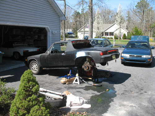

QUOTE(jimkelly @ Dec 20 2013, 08:39 AM) *
furniture dolly is totally fine.
the challenge is getting the car up high enough, safely.
Jim, thanks - that's a fairly terrifying picture given that I'm doing this inside, between another car and our two-wheelers.
How much of that height is actually required? It looks like you still have the carb / distributor on the block - would removing them have helped clearance much?

QUOTE(mikesmith @ Dec 20 2013, 04:51 PM) *
My car is lowered. I lift it slightly, slide furniture dollys under the bar. Lower the car on the dollys, support the tranny with a jack and unbolt everything. I then lift the car up with my cherry picker and slide the motor out. I hook the cherry picker on my cage inside the trunk. This method won't work on a stock car.

QUOTE(iamchappy @ Dec 20 2013, 10:42 AM) *
Lift table doubles as a work area for your engine also.
I've done the furniture dolly method, standard floor jacks, M/C jacks and hydraulic tables. I've currently got pretty much the same set up as Chappy and it's by far the best for a one man operation as far as I'm concerned (IMG:style_emoticons/default/shades.gif)

QUOTE(andys @ Dec 20 2013, 12:52 PM) *

I think removing dist and carb would require 4" or so less lift.
be careful to unbolt trans first when uninstalling and bolt trans last when installing, to keep pressure off the trans ears, as they are know to break.
I think getting the front up a few inches would result in car being at less a precarious slant.

especially on a sloped driveway! carbs and linkage off in one piece my way. no need to pull the distributor.
