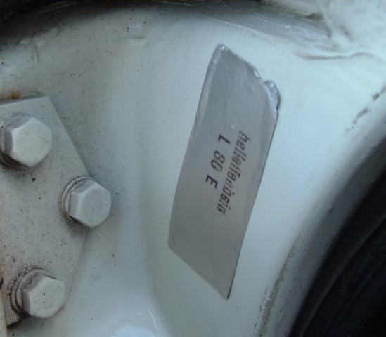

I am trying to duplicate the paint code sticker that goes in the left door jamb for my 74 restoration project (paint code L80E). I am having a problem trying to determine the actual size of the sticker itself. Does anyone have a car that still has the paint code sticker in the left door jamb? If so, could you provide some measurements of the actual size of the sticker as well as the font height?
See the links below for reference.

Greg,
Maybe some of the local PNW-teeners will have a car with their color sticker still intact close enough to you for reference?
Tod914 may be another reference for the size & material, as he's restored several 73-74 preservation class 914s over recent years, although I think all are sold now, but he may have good pix & idea of size. PM & email him off the search members, cuz I've not seen him on here for awhile & I think he was moving from NJ to TX too.
I'm restoring my 73 2L L80E as well, so would be willing to share repro costs with you if not too much, to make one for my resto. Just send me an email/PM when you have costs & more info.
If you can repro with the ability to drop in any color code & name, then you'd get a better audience/customer base, and 911/912 guys would also be possibles too, as I think the stickers were the same (you'd need to research that).

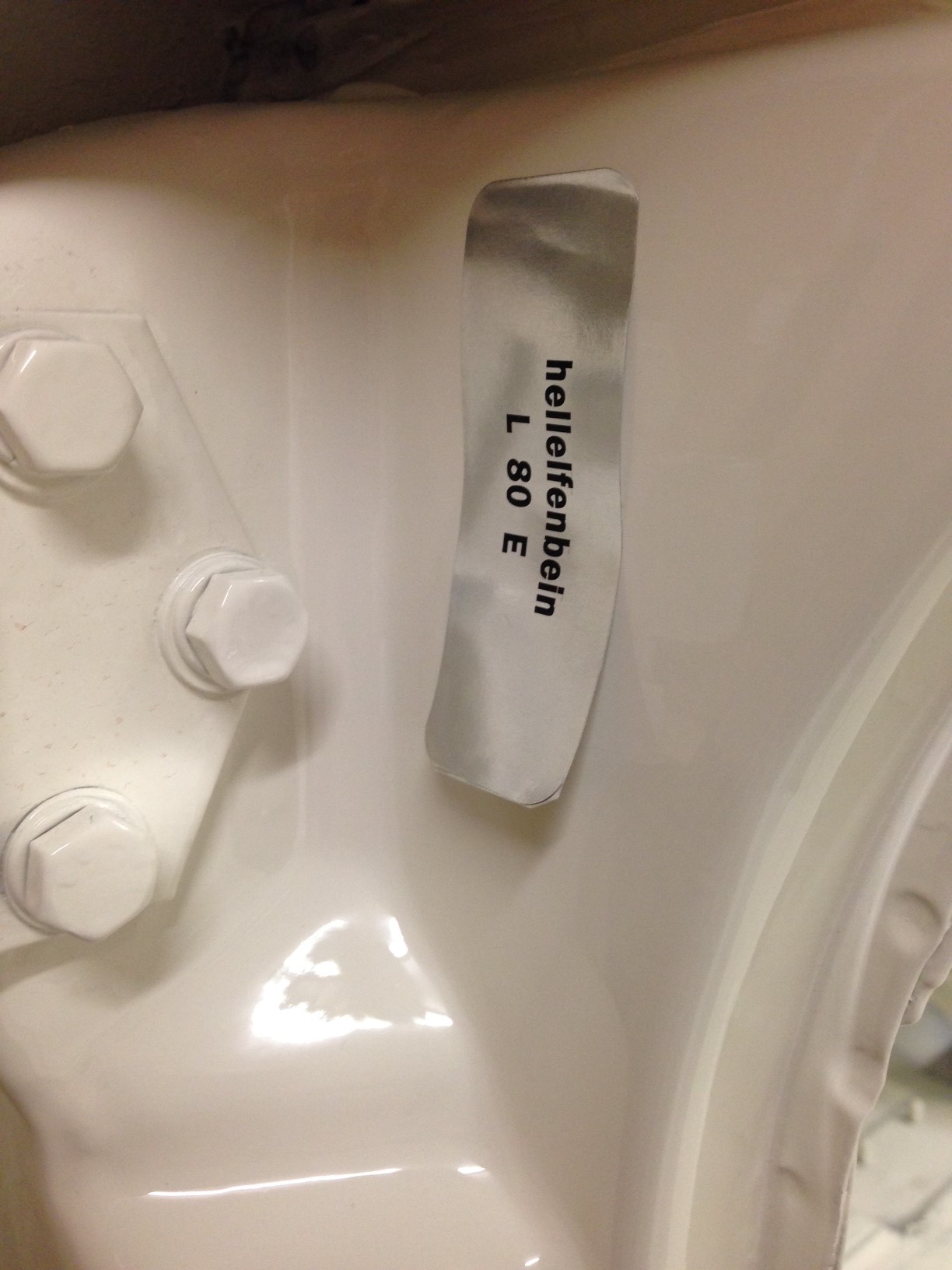

Hi Tom,
Thanks for the help. I will PM Tod. I found a label company that will print just about anything. They have the foil labels and, if needed, will cut custom sizes. I have ordered just about ever stock size label that would be close but I cannot get a tight bead on the size.
See the pictures below. I didn't stick the label down fully on my car but I wanted to see how close I was getting. At this time, too narrow of a label and the corners are too rounded.
I'm working on the font also. The one I used is close. Let me know what you think.

Greg,
Their font was a condensed font - Helvetica or similar I think, and maybe the semi-bold vs. your bold font standard width.
Corners are indeed more rounded than original, but you could use square & cut round corners with an exacto knife & circle template for closre radius.
I think you can measure the nuts & door hinge base on your car, then use that to compare to Jeff's pic to measure size of label proportionally, using the known bolt head &/or hinge measurement.
Also, SocalAndy on here has the thread to make repro VIN door stickers, if you'll need one of those as well, so PM/email him if necessary.

Here is my latest proof on the size and font. The sample is not in foil at this time. I wanted to test the size of the label and the font. I didn't bother with the rounded corners. The final foil label with have slightly rounded corners.
The label is 28mm x 77mm. Using this size label keeps the same height length ratio of the original label. The font is 20pt. Still need some work on the "L 80 E."
Getting closer. Thoughts?
Greg

Looking real good Greg. Your font seems to be just slightly more compressed (narrower width) than the factory font. If you can bring the original Porsche label into your paint system as a background layer, and your font in as a top layer with transparency, you should be able to get it perfect by scaling the font you plan on printing with. The background layer you'll have to rotate.

QUOTE(tod914 @ Jan 6 2014, 01:50 PM) *
....slightly thinner on the font face too ... I think they call that demi-bold as opposed to the bold font, or something similar.
Also, the bottom loop of the "e" is closed in a bit more than on the OE sticker, if you can trim it or look at another version of that font (many versions out there: knock-offs like TrueType, Bitstream, original Helvetica series, etc.).

Hi Tom,
See the following pictures. I'm trying to factor in serveral images to come up with a common font style. My sample is a bit narrow though.
Greg

Gotcha Greg .... as with many things 914, it varied from car to car, MY to MY, etc.
You'd still need to open up the slot on the lower case "e" on yours, even with the bold-condensed font of these other 3.
My thinking was that the bold may be closing it off too much, & maybe demi-bold/semi-bold condensed font would open it up just enough ... worth a couple of mouse clicks & test print on plain paper to see anyway. Otherwise you'd have to use photoshop or some font customization/graphics program to open it up.

Greg in regards to your spacing, the L and 80 should be one space over to the left. Look which letters they fall under on the original label. L falls under the "el", 8 falls under the "l". 0 under the "e". Don't mean to nit pick it, but seems like you want it perfect.

The font you're using looks like Impact ? Impact is like microsoft version of univers which isn't quite right either. I think the font is supposed to be DIN engshrift.
I have a 'L50k neptunblau' sticker like this in my bus, I will have to measure it.

That font looks PERFECT. I will download it in the morning and get a new sample. I can tell its correct when looking at the 6 and 9. They are very unique.
