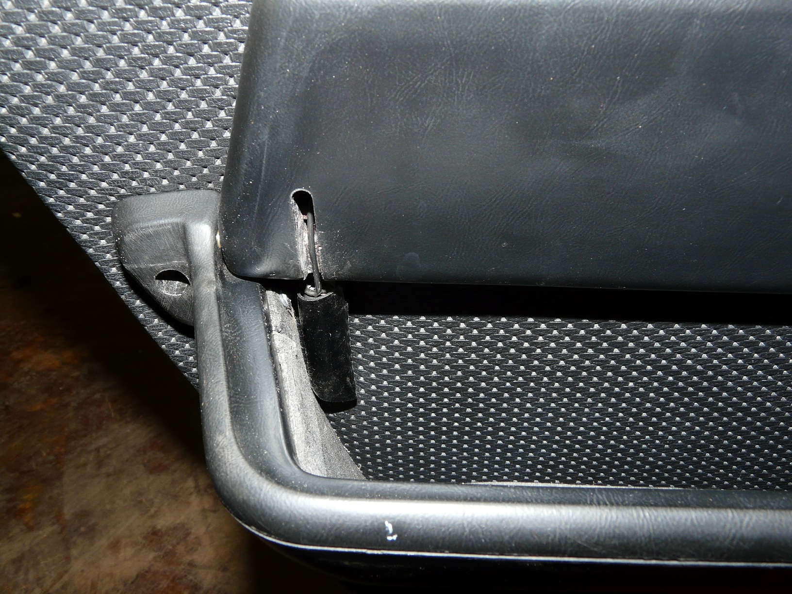

I'm not sure but that looks like the spring that I threw away since I couldn't find where to put it. (IMG:style_emoticons/default/headbang.gif) Luckily, I got it out of the bin before that was emptied. Somewhere on this forum I found a picture of this spring.
I thinkit holds the cover of the compartment under the drivers armrest.
I took the photo attached to this message. There is a plastic tube/cover around the spring.

The one on the arm rest flap is too short, probably the throttle return spring?
