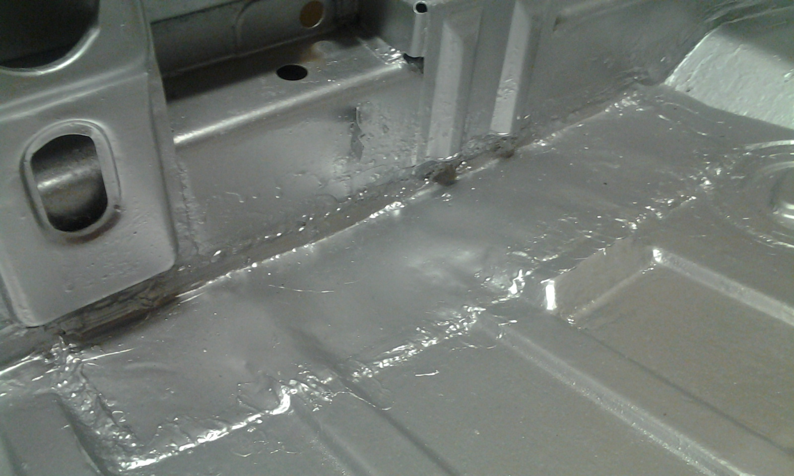

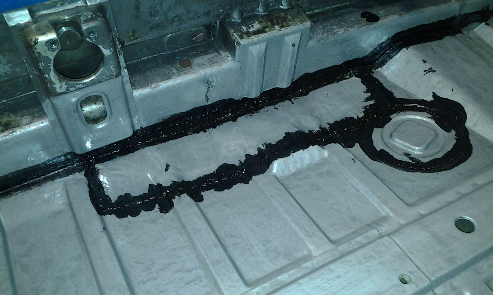

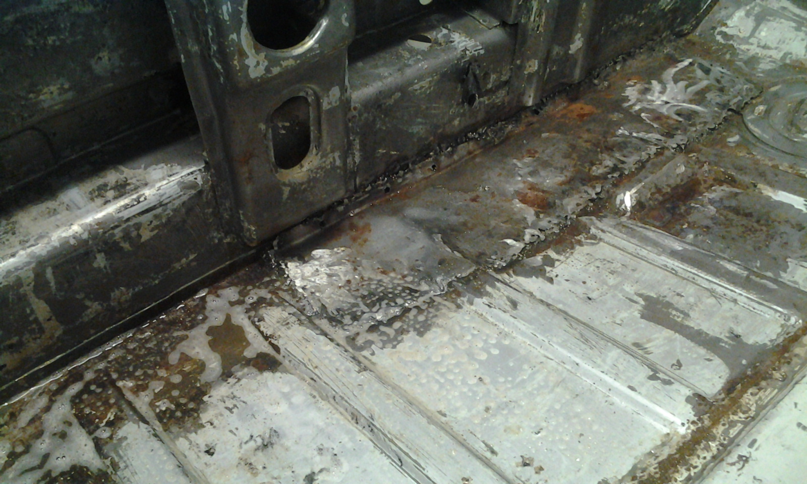

I have heard the good and the bad stories, and I have used POR-15. What I have found is that if you FOLLOW THE INSTRUCTIONS to the letter, you will get great results. There is a post above, complaining about removing the rock hard POR-15. That is how it is supposed to work. I say try it, then you will know. I basically painted my whole car with the stuff. inside the gas tank too. Here are some shots:
my trunk after a patch job. the bubbles are either the "metal ready" or the "marine clean" working. This is my 1st time I welded in 30 years, so don't be critical. (IMG:style_emoticons/default/piratenanner.gif) I also used the POR patch as a seam sealer, also highly recommend that product.
POR patch is black.
I ruffed it up with a light sanding then painted over the seam sealer. It will look even better when the carpet is on top of it..... (IMG:style_emoticons/default/aktion035.gif)
