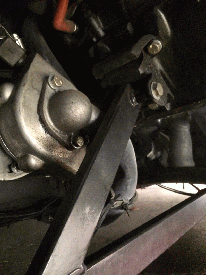

Ever since I did my SBC conversion, I've never been happy with the sharp turn the 1 1/4 gate hose had to take from the water pump to follow the bottom of the car. When the hose is cold the turn actually causes the hose to kink, but once the pump pressurizes the system the hose fills out and unkinks.

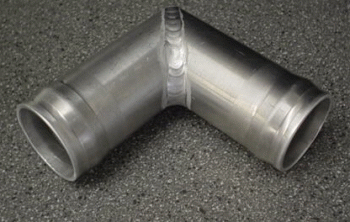

Anyway, what I need to do is add a 90 degree turn either with some pipe or a formed piece of radiator hose. I would appreciate some ideas how you would approach this.
Ideally it would be nice to have a curved piece of pipe welded to outlet on the pump, but not even sure if you can. It's made of cast aluminum I believe. This would then only require one clamp where the pipe would join the hose.

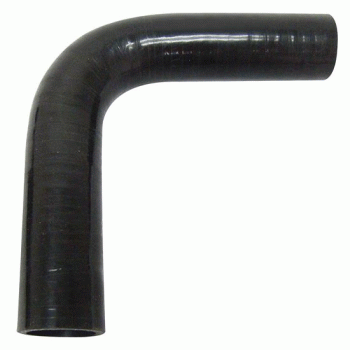

Alternately, I could purchase a 90 degree radiator silicone elbow but then would also need a union tee and multiple places to clamp.

Why not take the elbow off and bring it to a radiator shop to have them weld you a 90 degree extension? You could mock up the bend that you require with some electrical conduit... or get it at least close enough to demonstrate what you desire. Good luck!

Usually when I have that sort of problem I go to my local parts store and ask if I can go in the back and look at their formed hoses. Then I will buy one where at least some portion has the right bend (or very close to it) and I'll cut off the excess. It looks cleaner that way IMO and there are fewer connections to leak

I have done it a couple ways. The formed hoses are good they just mean you need a sleeve (pipe) to make the transition between the 2. I've use the muffler pieces as you can use them as a reducer if need be too. Getting a pipe with a 90 bend that you can attach to the mount is a decent idea too. You just have more short hoses to deal with.

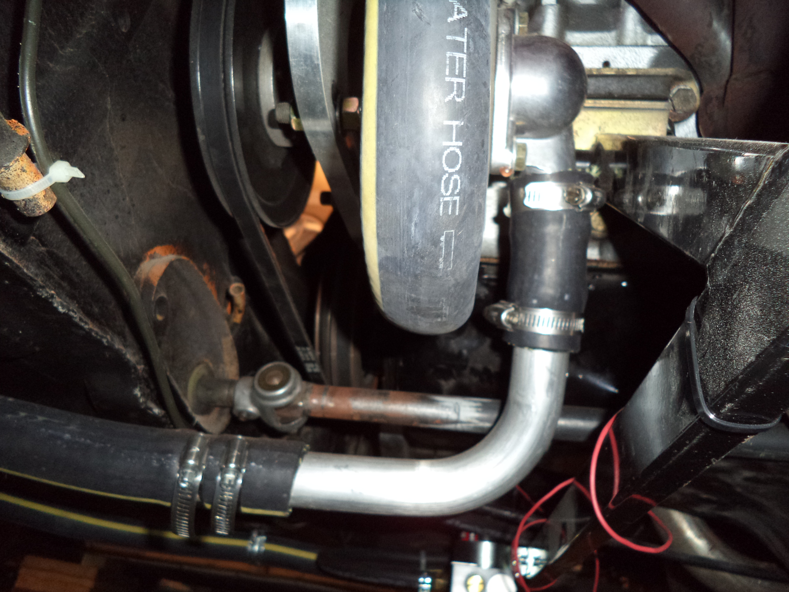

Jim Kelly used a 90degree. Think he got it off ebay???
(IMG:http://www.914world.com/bbs2/uploads/post-2460-1383845430.jpg)
yup-
(IMG:http://www.914world.com/bbs2/uploads/post-2460-1380491473_thumb.jpg)

jimkelly
post Jan 23 2014, 08:47 AM
Delaware USA
Posts: 4,969
Joined: 5-August 04
From: Delaware, USA
Member No.: 2,460
a better pic I just took.

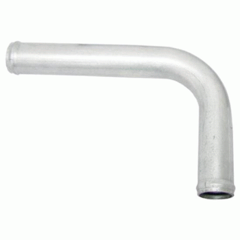

Thanks all for your ideas. Jim, that's pretty much what I had in mind. The stainless tube that you purchased--seems to me to be the simplest, yet functional solution. I wasn't crazy about renegade's 90 degree fitting.
I'm pretty ignorant when it comes to what types of metals can be welded to another. Is it possible to weld that 90 degree tube to the actual cast aluminum outlet that bolts to the water pump?
Those tubes can be purchased from Speedway http://www.speedwaymotors.com/Shop/Hoses-a...t-Pipes/12.html for $16.99
