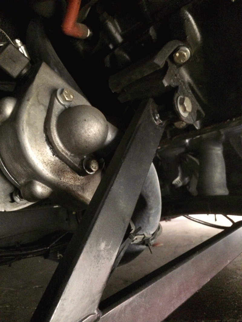

Ever since I did my SBC conversion, I've never been happy with the sharp turn the 1 1/4 gate hose had to take from the water pump to follow the bottom of the car. When the hose is cold the turn actually causes the hose to kink, but once the pump pressurizes the system the hose fills out and unkinks.
Anyway, what I need to do is add a 90 degree turn either with some pipe or a formed piece of radiator hose. I would appreciate some ideas how you would approach this.
Ideally it would be nice to have a curved piece of pipe welded to outlet on the pump, but not even sure if you can. It's made of cast aluminum I believe. This would then only require one clamp where the pipe would join the hose.

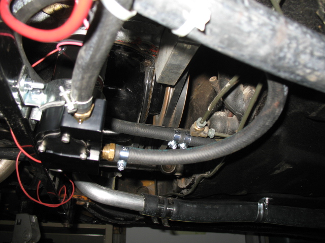

Jim Kelly used a 90degree. Think he got it off ebay???
IPB Image
yup-
IPB Image

jimkelly
a better pic I just took.

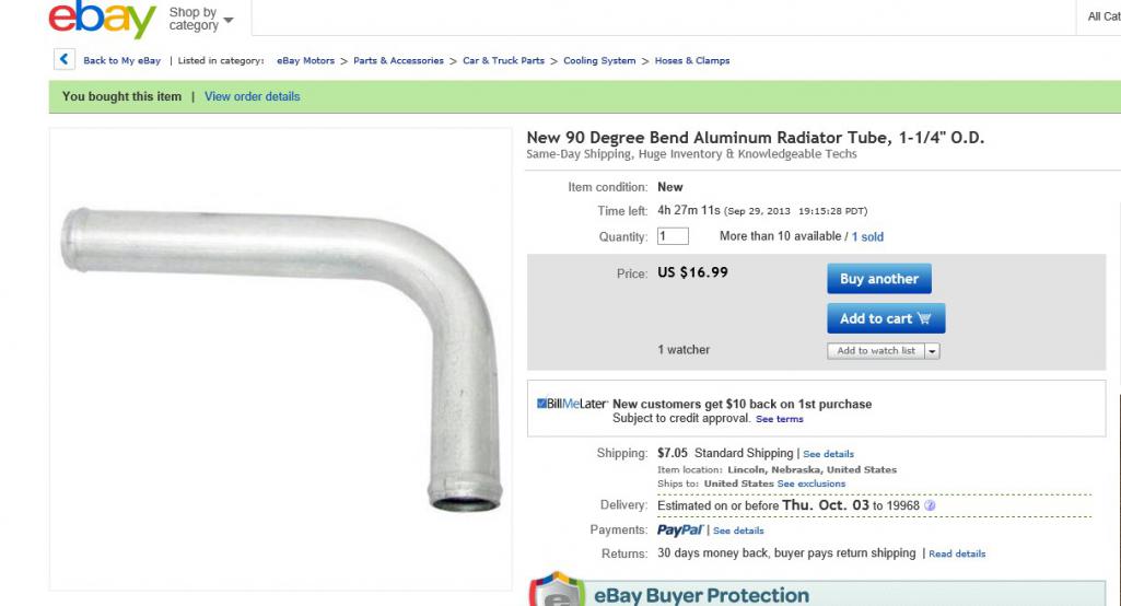

Thanks all for your ideas. Jim, that's pretty much what I had in mind. The stainless tube that you purchased--seems to me to be the simplest, yet functional solution. I wasn't crazy about renegade's 90 degree fitting.
I'm pretty ignorant when it comes to what types of metals can be welded to another. Is it possible to weld that 90 degree tube to the actual cast aluminum outlet that bolts to the water pump?
Those tubes can be purchased from Speedway http://www.speedwaymotors.com/Shop/Hoses-a...t-Pipes/12.html for $16.99
