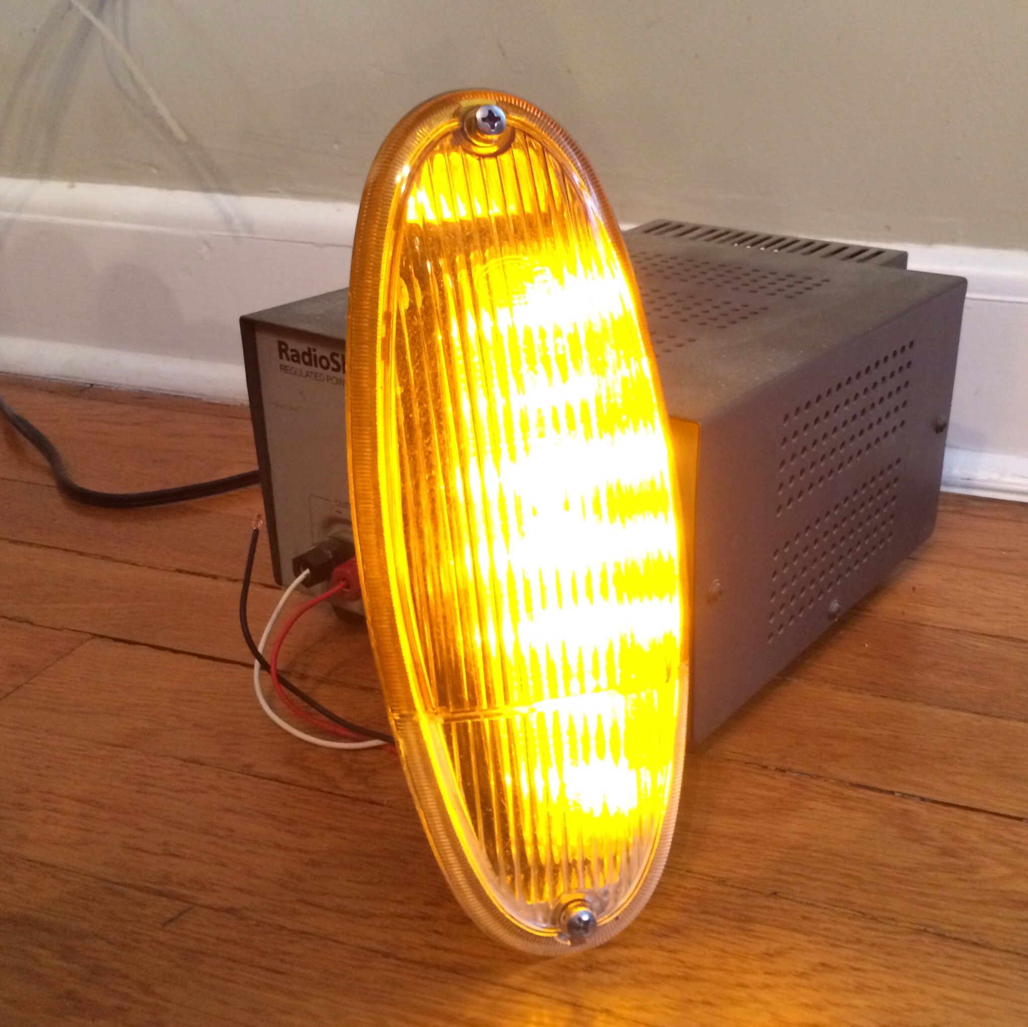

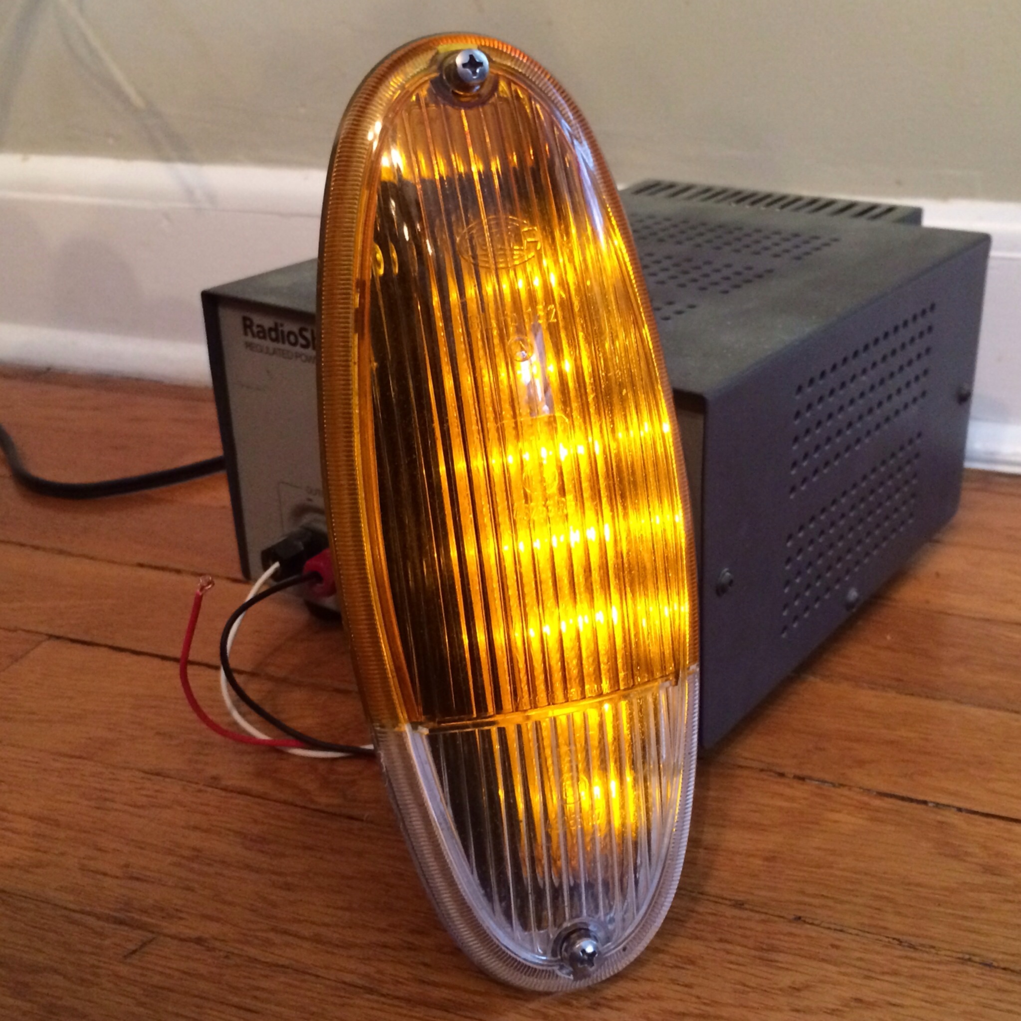

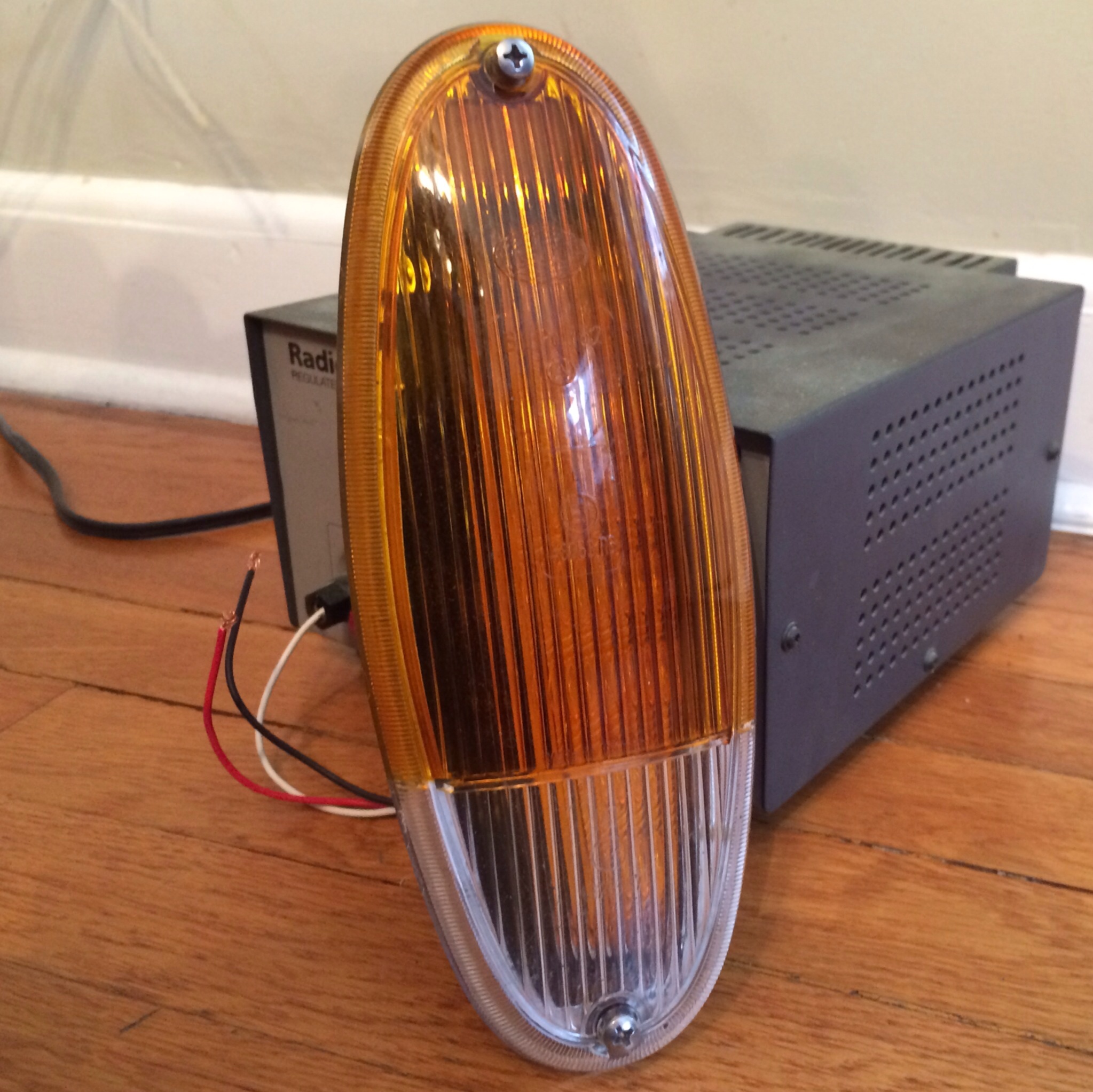

Turns out that my amber lens is a Euro lens, so here goes. You get the idea.
https://www.youtube.com/watch?v=VRYuFVIluiE
Hope that helps.

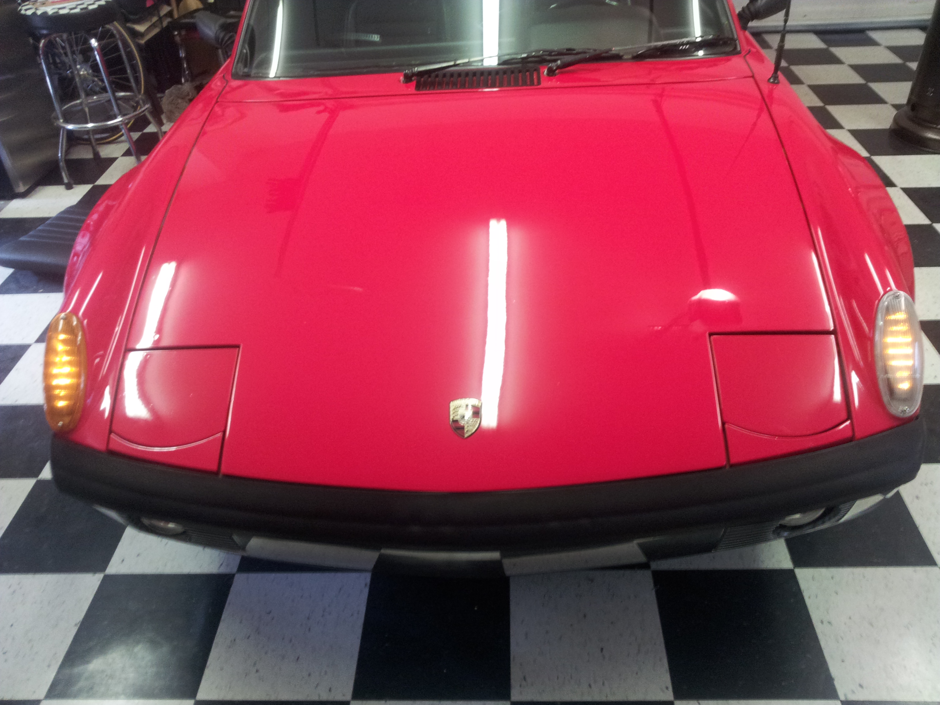

Doug led the way on this project.
Here is a picture of the LEDS behind a clear lens and a stock amber lens - parking lights on. The output is similar and pretty damn bright.

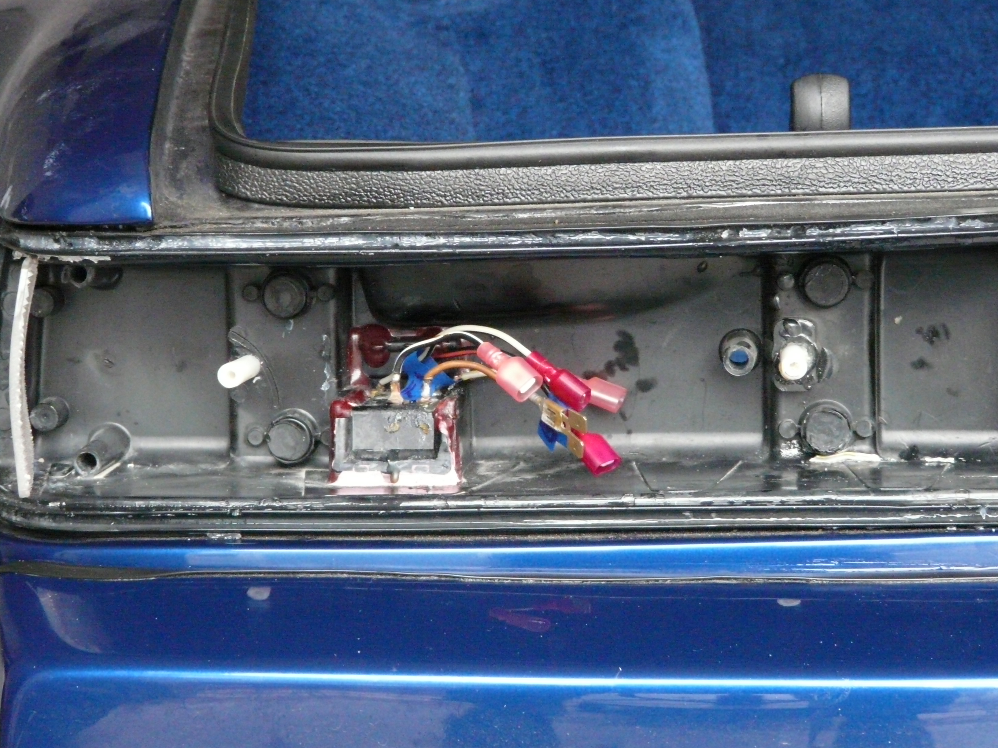

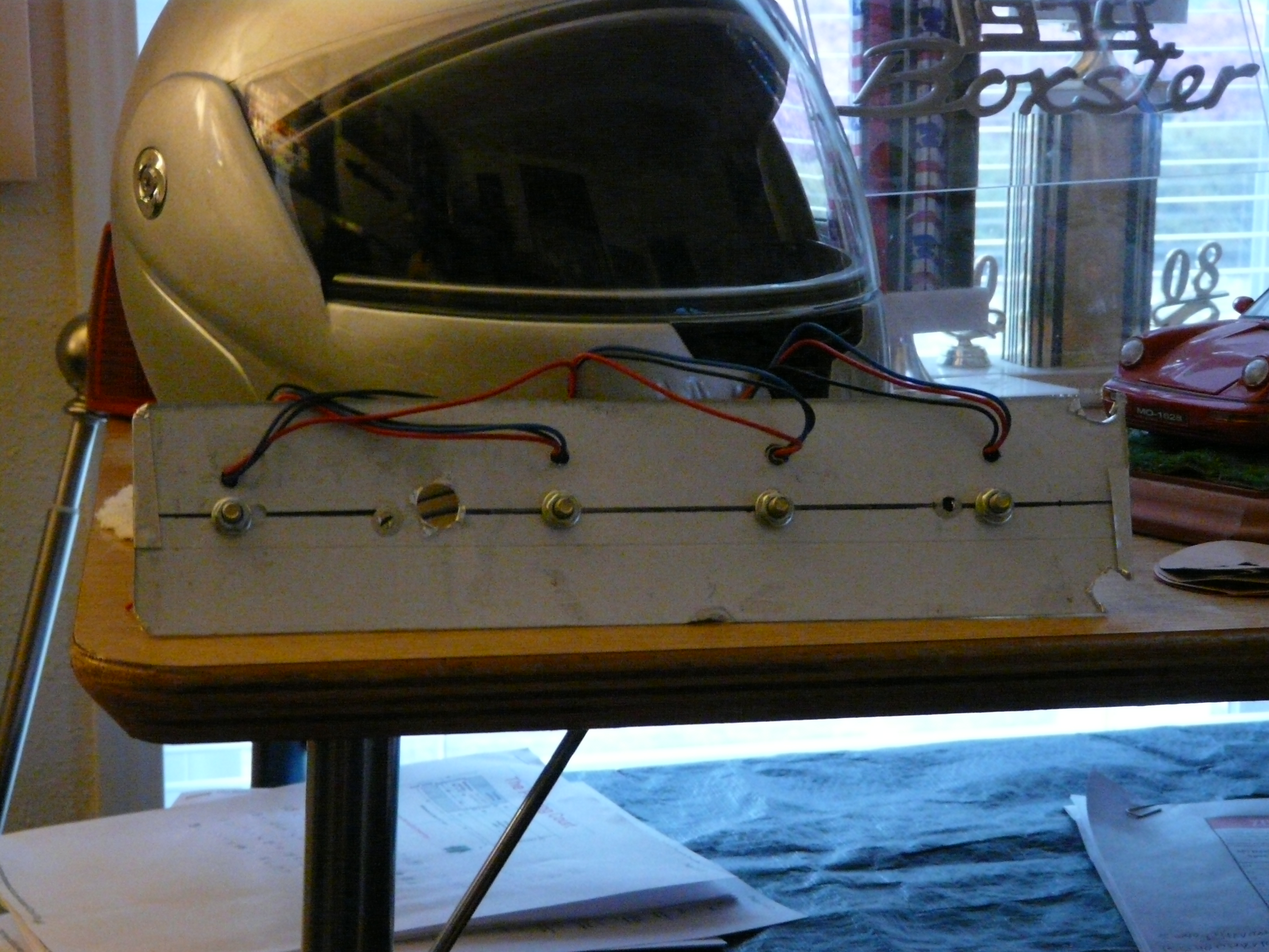

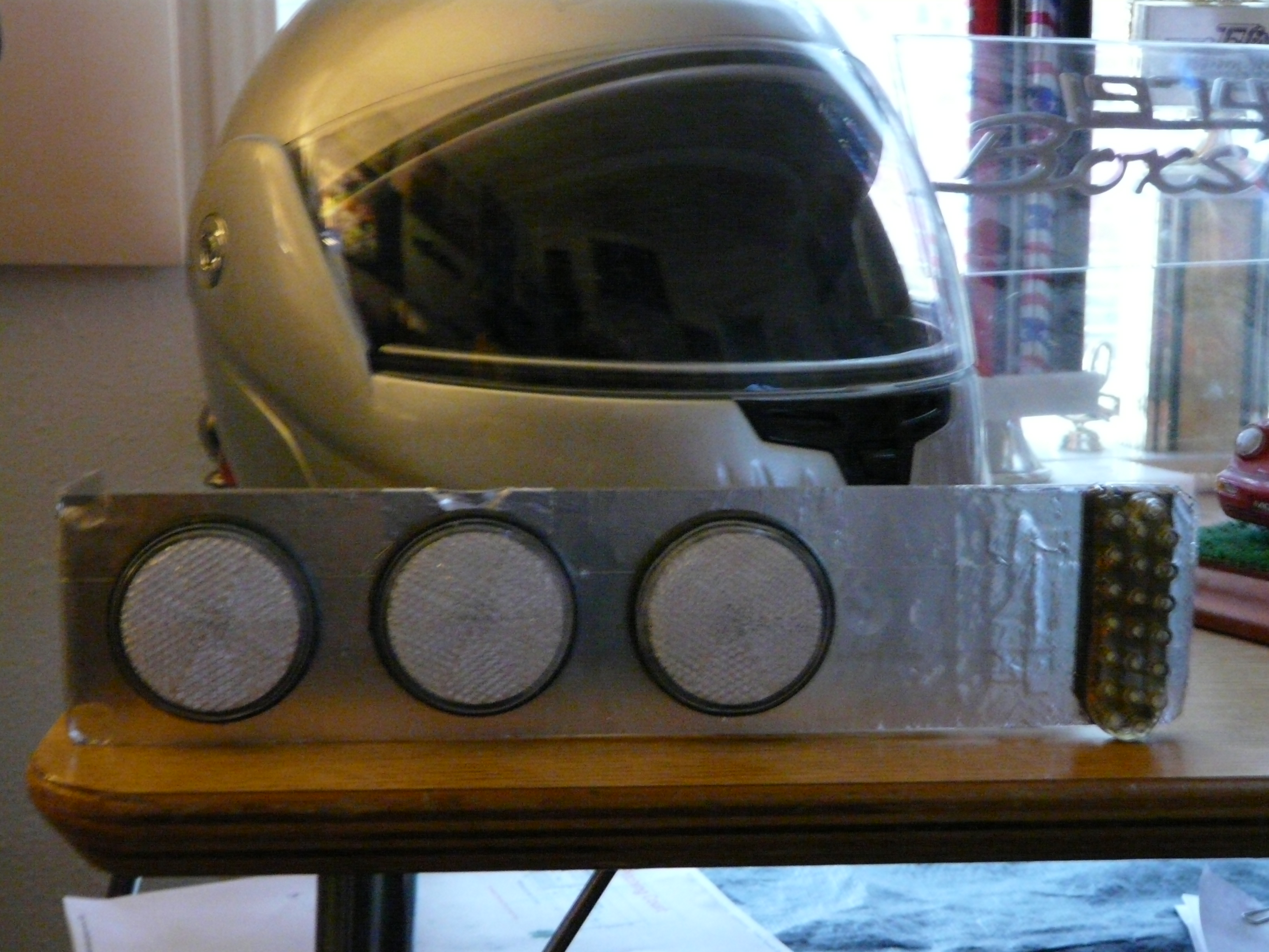

I also did the Cat-Eye LED front running/turn signal lights. So thought I could find something that I could change the rear tail lights to LED. On Ebay I found these round 2 3/4" LED lights that have a high and low feature. So I bought 6 of them, 3 for the right side and 3 for the left side. What I did is mounted 3 of them on a panel that would fit inside of the tail light assembly. Here are a couple pictures of how I did it.

post Mar 13 2014, 04:48 PM
Post #60
Posts: 370
Joined: 21-August 03
Member No.: 1,055
QUOTE(pjhaun @ Mar 13 2014, 03:46 PM) *
QUOTE(pjhaun @ Mar 13 2014, 03:44 PM) *
Second picture.
Third picture.
