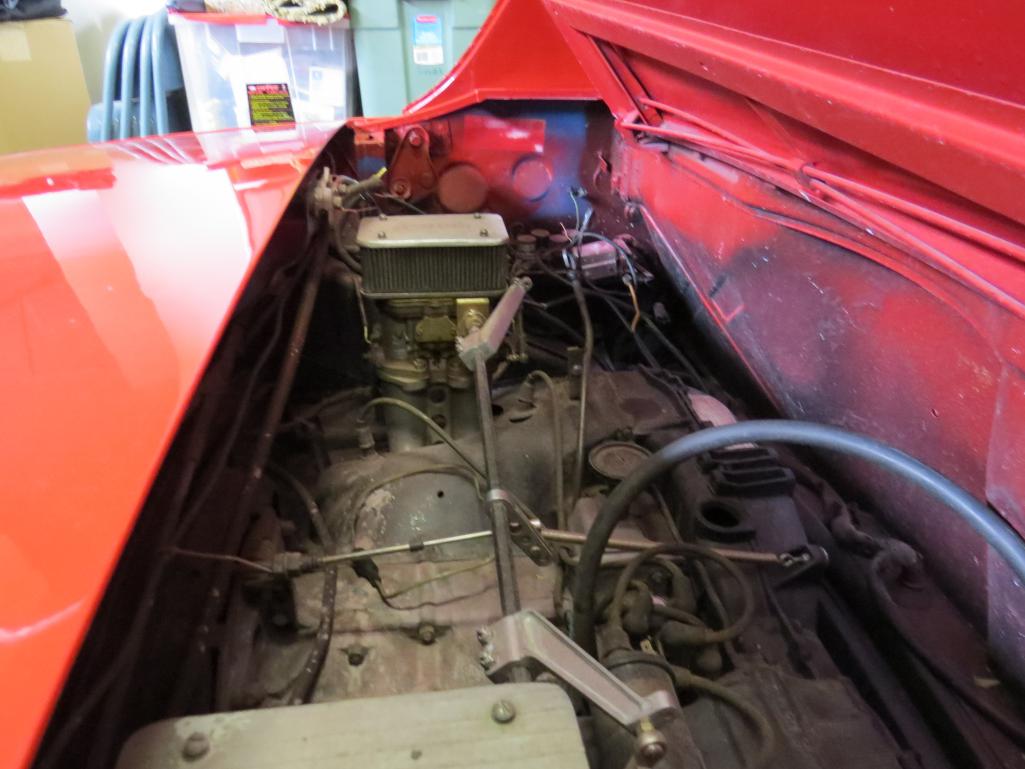

The 74 I just bought doesn't have the original engine, how do I know if this car came with a 1.8 or 2.0 ??? vin#4742906720

The engine you think you have is substantially different from other Type 4 based engines, and it's unlikely to be in your car. Let's see a picture of the top of the engine .........

The number on the engine is CV0444076 and when I looked it up it stated 80-83 vanagon 2.0Attached Image
See the red rectangle on the drivers sidewall? Is the emissions sticker under the red paint? Try to clean the sticker carefully, I used brake cleaner, and see what it says.

dlkawashima   It reads engine size 120 CID In that case, you...   Feb 13 2014, 06:49 PM

Jeff Bowlsby   120 CID = 2-oh!   Feb 13 2014, 06:33 PM
