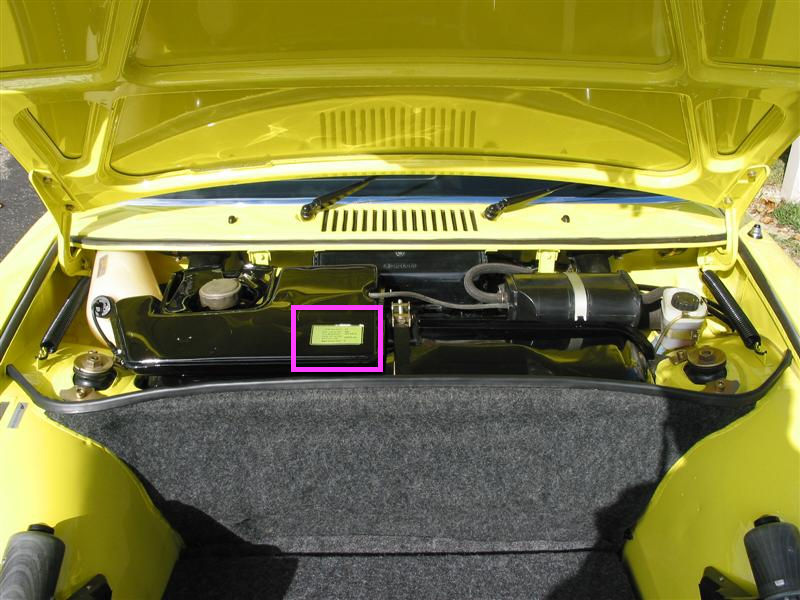

Do you know if your car has its original gas tank? If so, what is the tire size indicated on the label (see below)? 165 HR 15 was spec'd for 2-liter cars.

QUOTE(dlkawashima @ Feb 13 2014, 10:18 AM) *
Just went out and looked it says 165 R 15 so I guess its safe to assume it came with a 2.0 ?

bajafreaks   See the red rectangle on the drivers sidewall? Is ...   Feb 13 2014, 03:26 PM
dlkawashima   It reads engine size 120 CID In that case, you...   Feb 13 2014, 06:49 PM
bajafreaks   [quote name='bajafreaks' post='1997610' date='Feb...   Feb 13 2014, 07:53 PM
